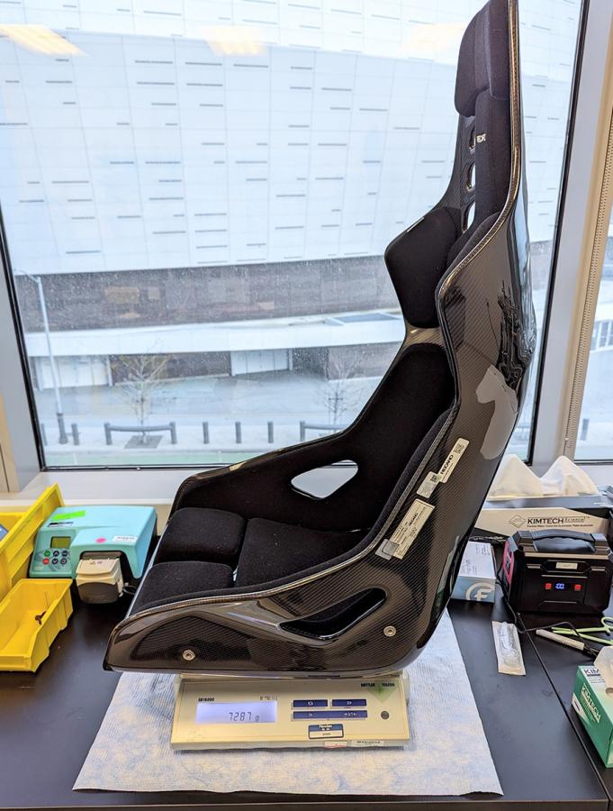

    when i got my seat in and got it on a scale i was disappointed to see it was heavier than advertised.
    recaro podium - 13.4 lbs / 6.1 kg (advertised)
    recaro podium - 16.1 lbs / 7.3 kg (on my home scale)
    I won't go into the specifics of the communications between the authorized dealer i purchased the seat from and Recaro themselves. but at the end of the day, Recaro told me to go kick rocks, and the dealer eventually admitted that they were too concerned about their working relationship with Recaro to press the matter further on my behalf.
    one of the ways they tried to dismiss my concerns was to say that my scales are probably inaccurate and theirs are not. well, i just so happen to work in a lab and have access to calibrated and validated scales so that was an easily refutable point (not that it mattered to them). i'll attach a pic of my overweight seat for the sake of posterity​

      Maybe a slight difference since if it's a L seat but 2.7lbs is a lot. I would be concerned.
      There should be a layup schedule for the seat meaning the seat is made with so many layers of carbon cloth and the exact spec of each layer. Might be a 200gsm (grams per sq meter) 2x2 toray fiber and then a 400gsm +/- 45 degree biaxial hexcel fiber, etc. Following the layup schedule ensures each seat is consistent in its performance and weight. Substituting a 200gsm for a 400gsm layer can add weight, strength and stiffness. Or changing from a 2x2 twill to a biaxial cloth will change stiffness and strength across different directions. A 2x2 twill has half the strength in two directions vs a unidirectional which has twice the strength in one direction. Or a 2x2 twill layer and then a biaxial layer will spread the total strength across 6 directions.
      One possibility is the part has an excessive amount of resin in the part due to loss of vacuum and/or voids between the layers of carbon...which WOULD be an issue.
      Another possibility is the part came out of the mold with visual defects. So they added an epoxy coat and lots of clear coat.
      I think the most likely possibility is they did not follow the layup schedule. Not a terrible thing since it sounds like they added layers of carbon which yields a stiffer and stronger seat. BUT...I would expect Recaro to have much better quality control.

                    from my research on the matter, i think there was either confusion internally or miscommunication between their contract manufacturer as to how much the complete seat actually weighs. some of their recent trade show advertising actually lists the weight of my heavy seat as the actual weight of the seat. that's conflated by the data sheet you can still download directly from their website saying the seat is lighter than it is. it give me the impression that it's currently a dumpster fire at Recaro.​
