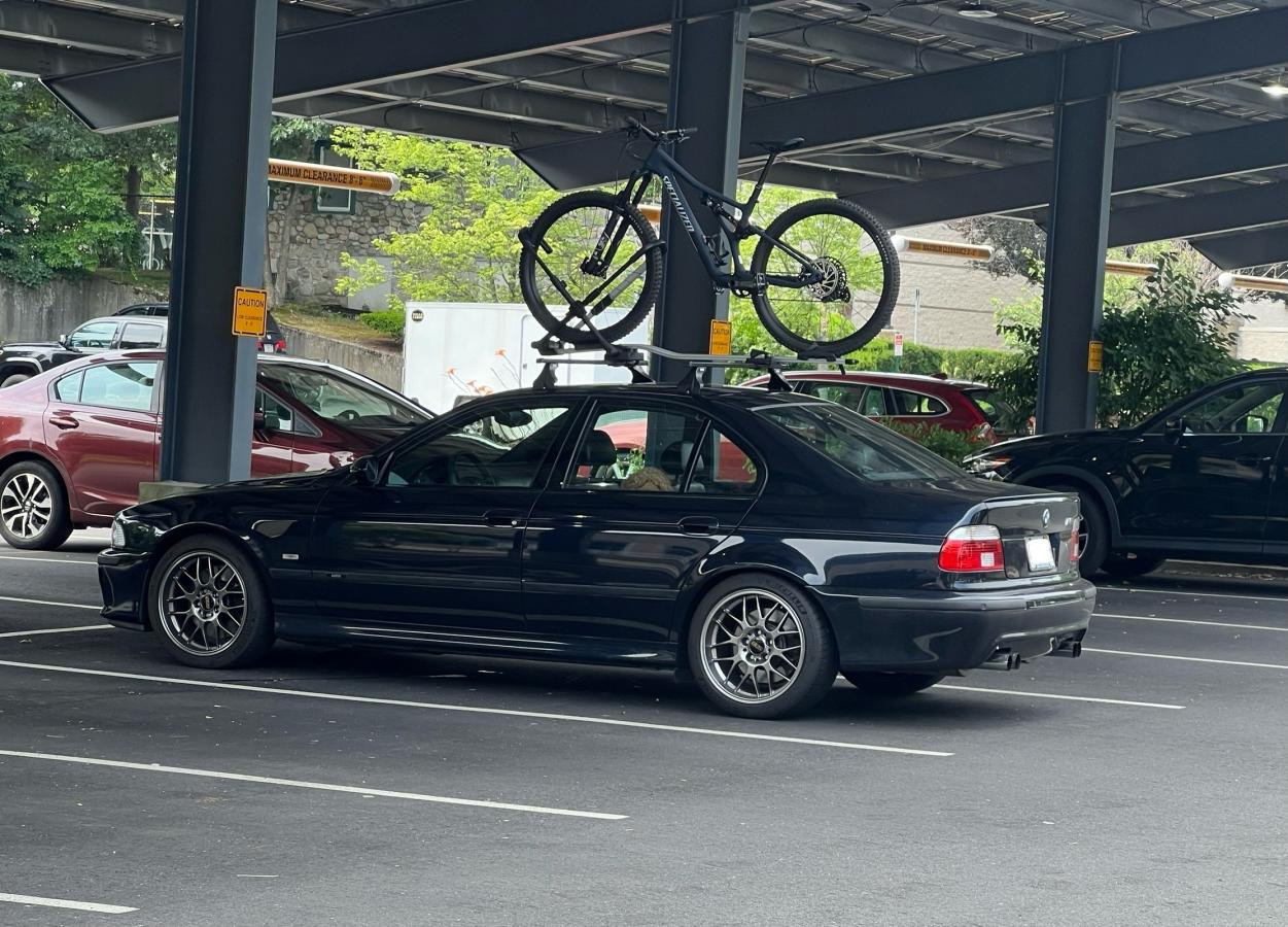

                          Random recent pic of mine used appropriately: road trip dog and bike transporter
