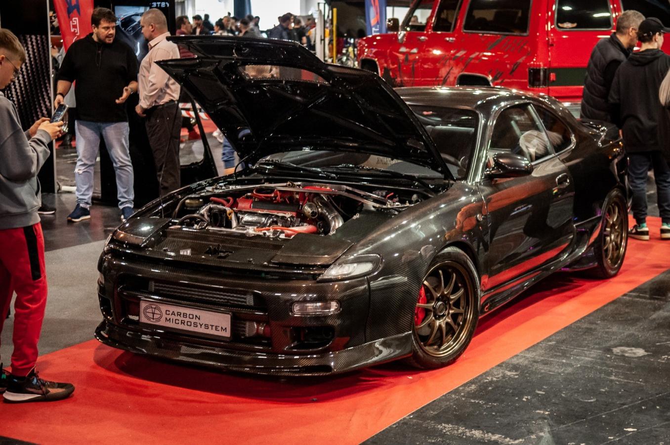

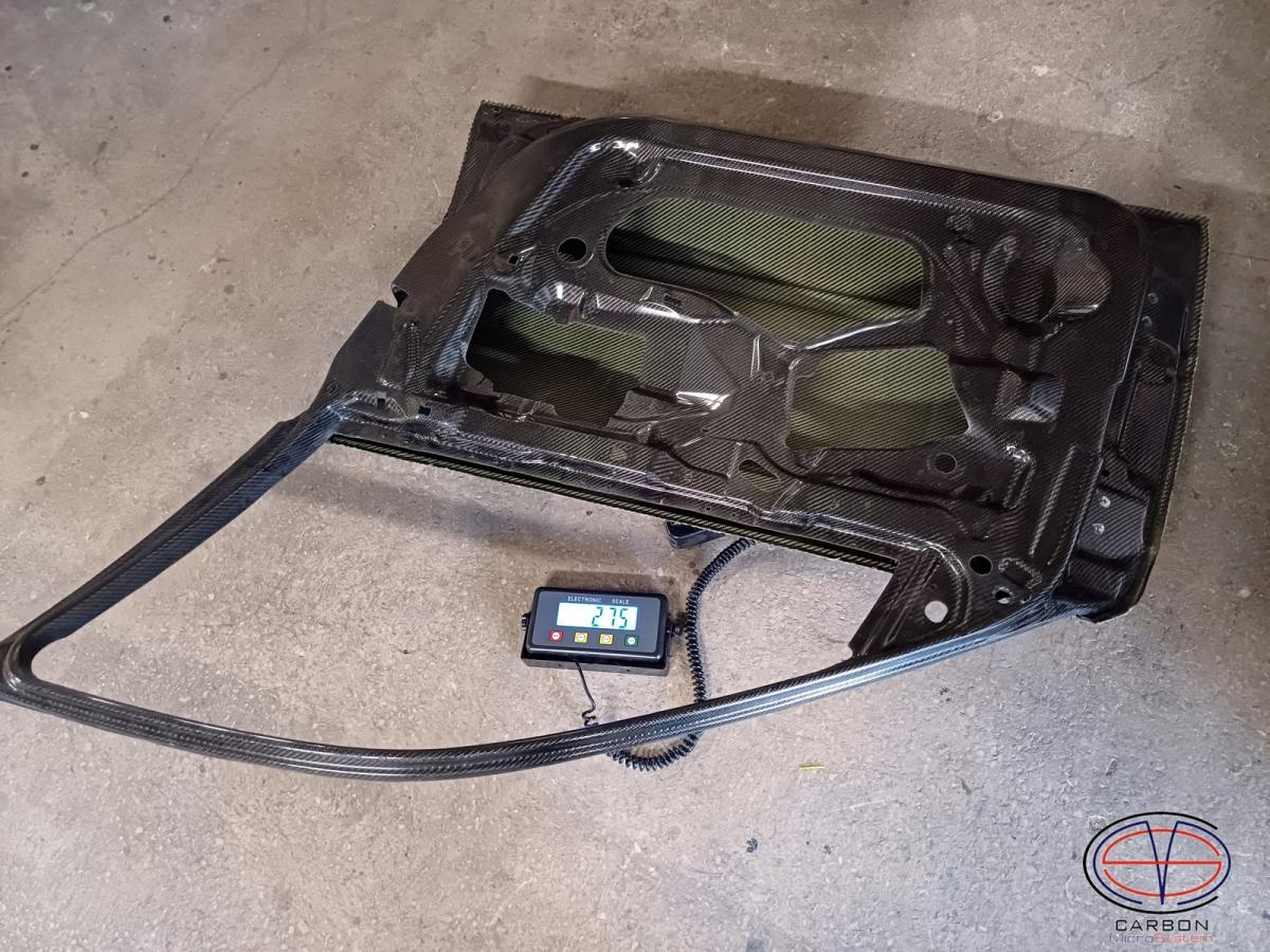

                I will write a little about using carbon doors on my car.
                I did not notice any difference in sound insulation. All doors are made together with internal ribs, so the doors do not rattle when driving.
                The only thing I do not like is that due to the low weight, I can not always close the door the first time. There is not enough weight to press the rubber seal, but perhaps this is a feature of Toyota and so far none of our BMW customers have complained about this.
                Otherwise, the doors are the same as metal ones.
                Yes, the doors bend a little if you press on them, but this does not affect their strength. There is no need to compare metal and carbon, these are absolutely different materials. They should not be the same.
                As I wrote earlier, we can double the amount of material in the production of doors, but I do not see any need for this. This solution is good for a carbon roof, but not for doors.​

                  Thanks! No need to double up on material, we can always 3D scan and print/bond some lightweight plastic stiffeners to the inside if we need to. Those would do more per pound than extra layers of carbon for stiffness if needed.

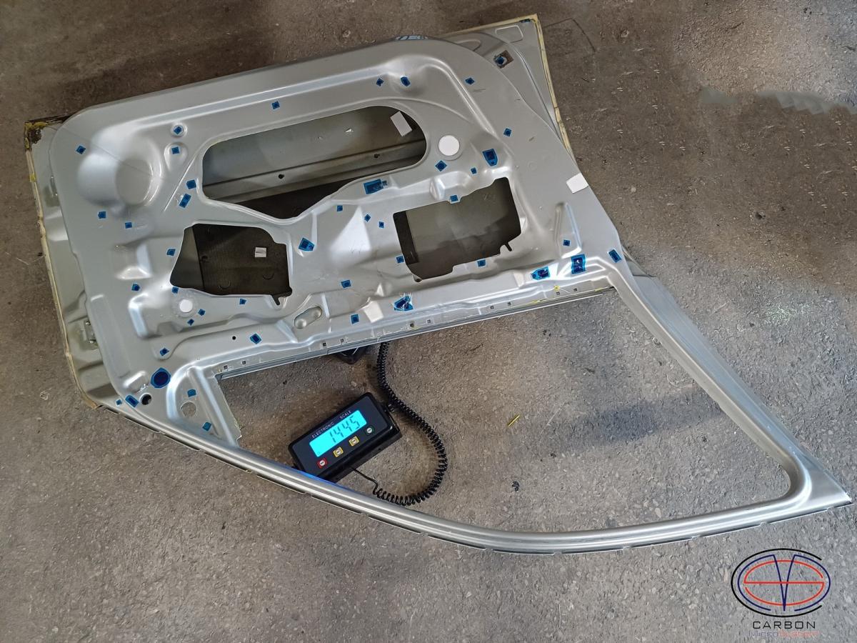

                    The difference in weight (Kg) between a metal door and a carbon door for a BMW E46 Sedan/Touring.
                    The final weight of the carbon door will be slightly higher, since all the internal elements have not yet been installed.​

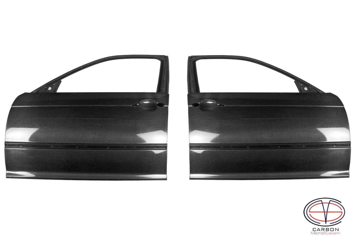

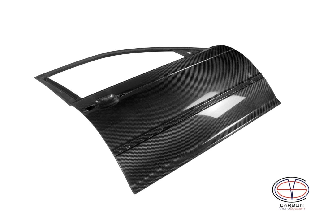

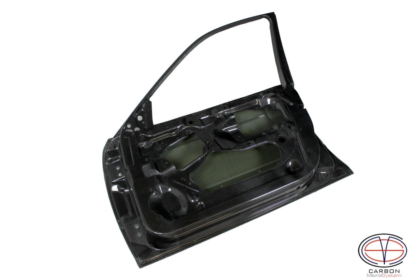

                      The front carbon doors for the E46 Sedan/Touring are almost ready.

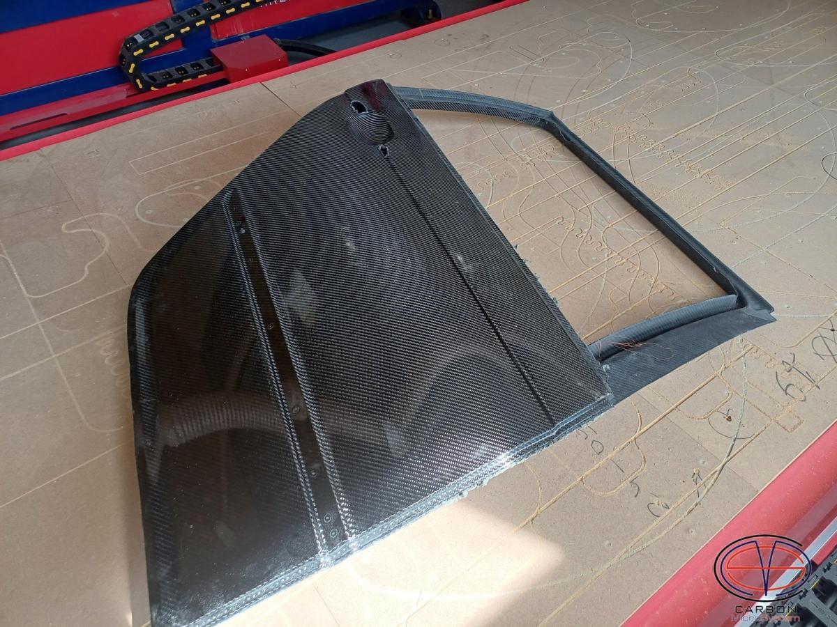

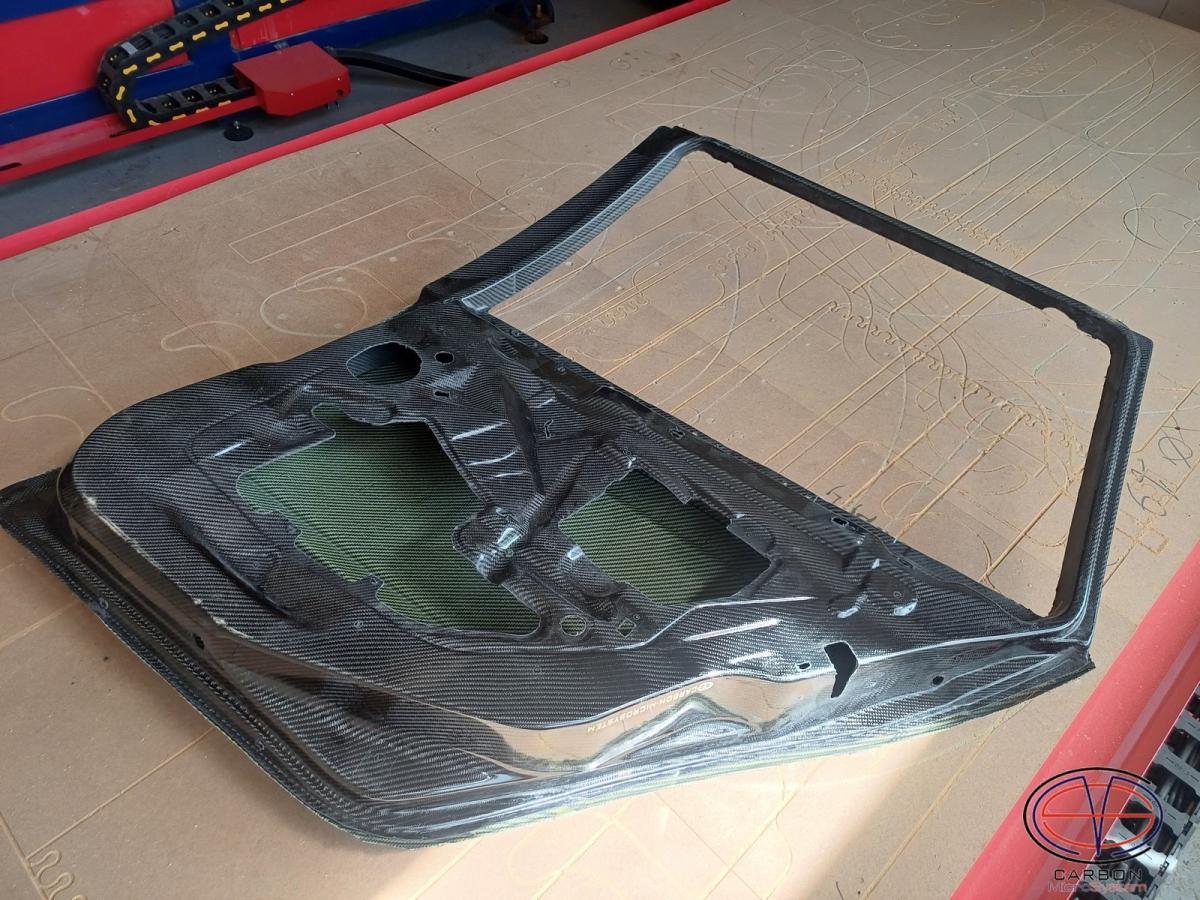

                          The rear carbon doors for the BMW E46 Touring are already partially ready.

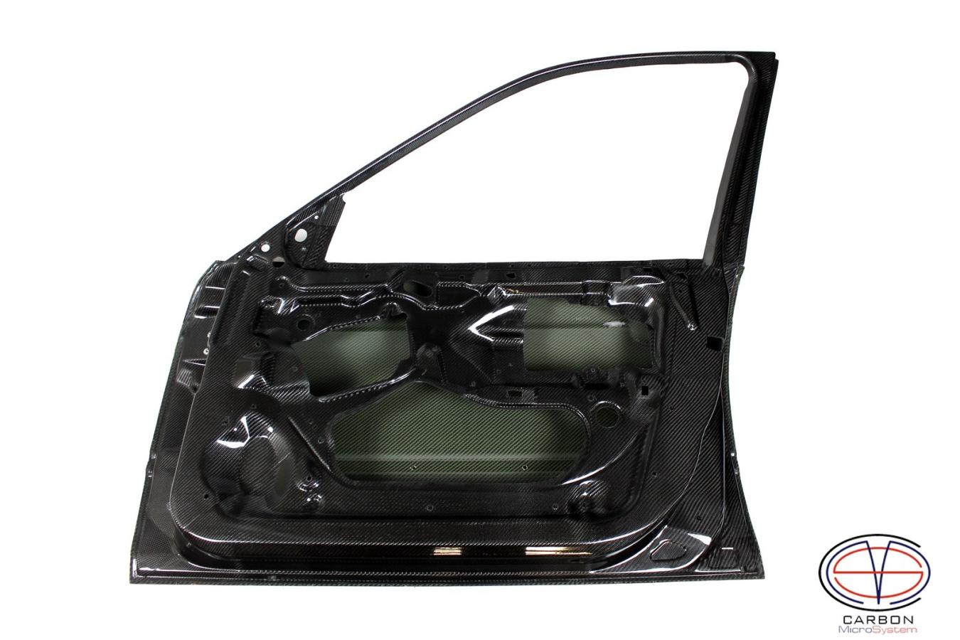

                              Carbon fiber doors for BMW E46 Touring.

                                Outstanding! Drilling all of those holes and cutting those openings...must be a massive MF'er! 🤣
