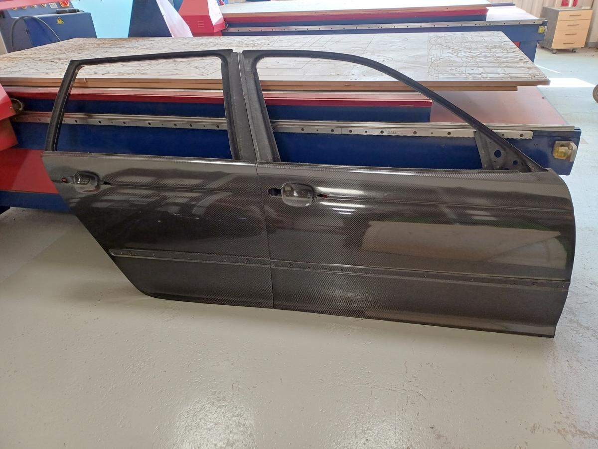

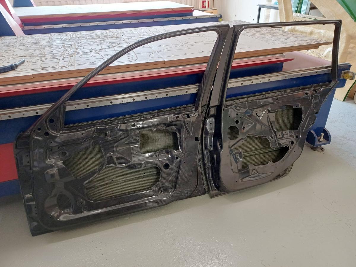

    Originally posted by Carbon Microsystem View Post
    Carbon fiber doors for BMW E46 Touring.
    Looking good! Maybe an odd question but would it be more or less work to reuse the steel inner skin with the carbon outer skin? Given all the fine detail work on the inner skin.
    And I’m guessing the destination of those doors isn’t Texas because of the lack of impact bars
      #77
      These aren't the "final" door, just the inner and outer sitting together. 😎

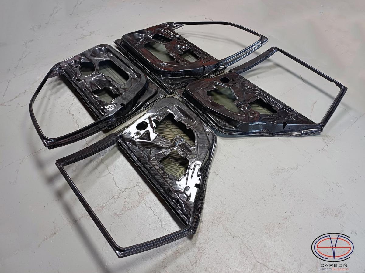

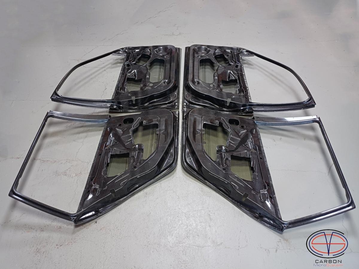

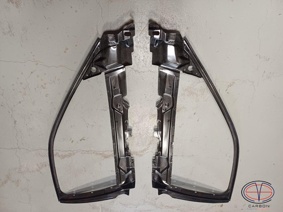

        Some more photos

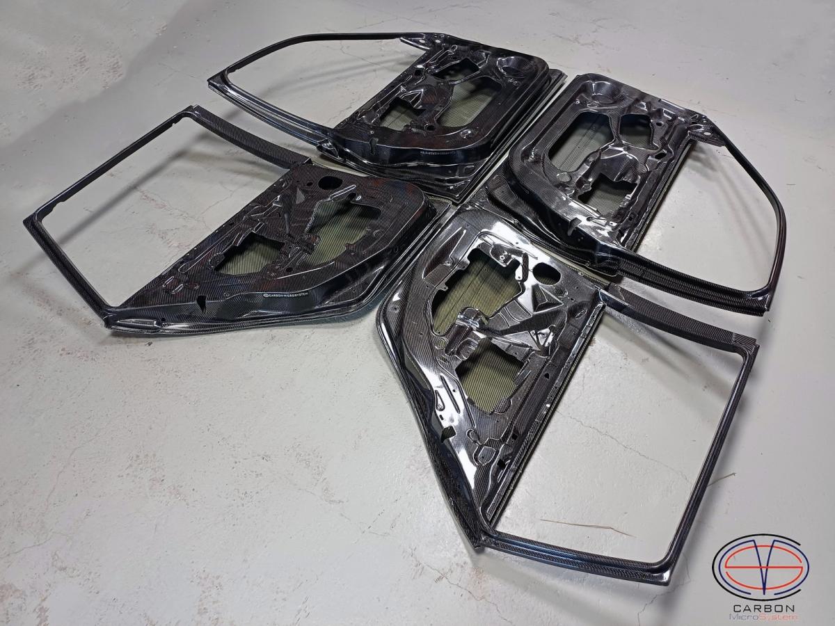

          We have finished all the internal elements of the doors, now we can begin the final assembly.
