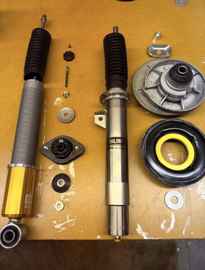

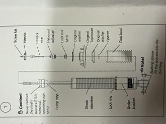

      I'm looking for someone that's done this to check my work. I think I finally have everything apart, cleaned, and ready to go back in the car. There are a lot of components here, and as we've seen it's pretty easy to mess it up. I've got it laid out in the order I think it goes together according the the instructions.
      Particularly on the rear there's a lot going on. The control wire is a little odd, does it protrude through the carpet for easy adjustment? Also, in order to get that lock nut on top of the washer I have to take the rebound adjuster off. I think for washer sandwich between the top mount the rubber side faces the rubber part of the mount?
      There's a bumpstop for the rears, which apparently have plenty of travel so it's less likely to be used, but no bumpstop for the fronts with less travel? Before I do it, the instructions also suggest trimming down the dust boots?

        These diagrams should help clarify the stock assemblies since you're using stock struts(and rsm it looks like?) :
        There is no external bump stop on these types of struts: https://motoiq.com/what-is-an-inverted-shaft-strut/2/
        For the cable, I didn't use this, but you would drill a hole if you wish to make adjustments without pulling the carpet. And for the dust boots yes trim them a bit, but mine were overly cut than necessary as you can see in the pics. It's hard to imagine this thin material really causing any interference regardless.
        Hope this helps and others can chime in. I wouldn't sweat assembly outside of my doozie.

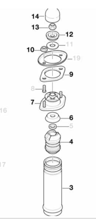

              yes, the top mounts are both OE for now (RSMs are Meyle HD).
              some differences between the assembly I've laid out and the realoem diagram, from top to bottom;
              rears - I do not have item 11 or 19. 11 doesn't feel important, but 19 kinda does. however neither are shown in the Ohlins provided diagrams, and a part number is not listed on realoem. I also don't have item 6, but rather another of item 12 in its place. They look to be basically the same, though item 6 may not have the rubber coating on one side.
              fronts - I have the assembly as shown on real oem outside of the bumpstop. but also, no spring pad for the perch or anything?
