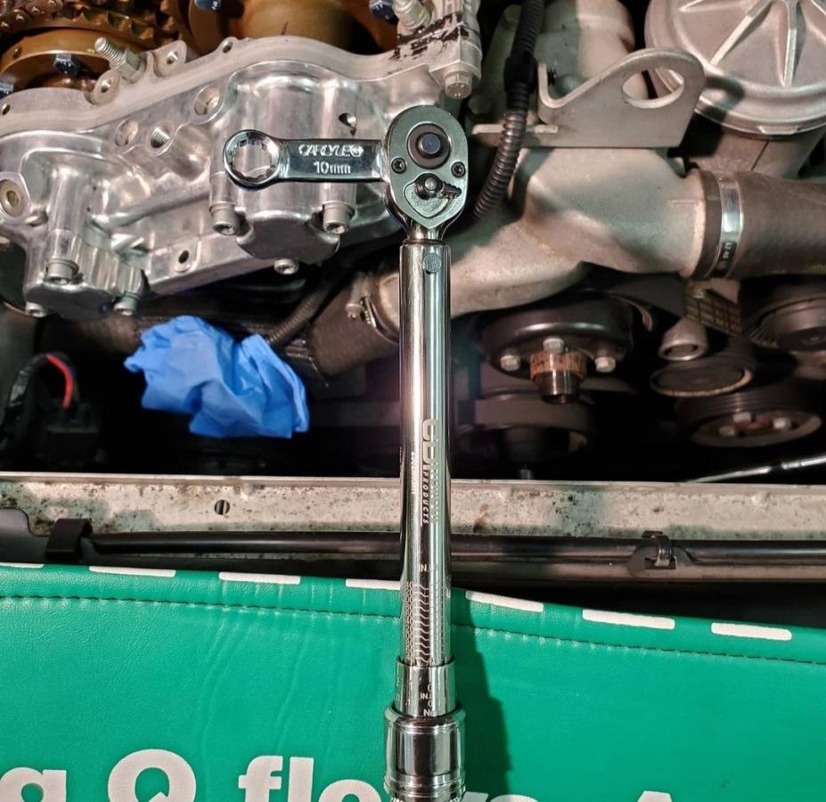

      I realize many people successfully have done this w/o torturing bolts, but all the 10mm crows foot I’ve seen are 3/8” drive & IMHO you can’t accurately torque 14nm with a 3/8” drive torque wrench w/ a 3/8” to 1/4” adapter & a crows foot. This is not because of the crows foot, but mainly because 14nm falls way low on the scale of what an average 3/8” torque wrench is rated at & your average torque wrench is innacurate near the lower & upper limits of its acceptable torque value.
      Just out of curiosity it tested this w/ a 1/4” & 3/8” drive torque wrench on a 14mm bolt @ 14nm. Where they clicked wasn’t even close. Granite, I’m using cheapo Harbor Freight torque wrenches, but they have served me well in the past. I’m already in the process & I think I’ve decided to go on with steps that require re-timing the engine - mainly because I wanna replace the plastic chain tensioner with the beefy Besian on I got & because I’ve spent soooo much time researching this I think I’d feel like a puss if I didn’t do it at this point.

        I realize many people successfully have done this w/o torturing bolts, but all the 10mm crows foot I’ve seen are 3/8” drive & IMHO you can’t accurately torque 14nm with a 3/8” drive torque wrench w/ a 3/8” to 1/4” adapter & a crows foot. This is not because of the crows foot, but mainly because 14nm falls way low on the scale of what an average 3/8” torque wrench is rated at & your average torque wrench is innacurate near the lower & upper limits of its acceptable torque value.​
        I used the normal 10mm socket and torque wrench for tightening the vanos hub: remove the vanos off the head and torque the bolts.
          The cheapo HF 1/4" is surprisingly accurate as I compared it to a 1/4" Snap-on. You want a 1/4" torque wrench for 14nm. And there should be no issue with a crows foot, just torque in the right orientation.

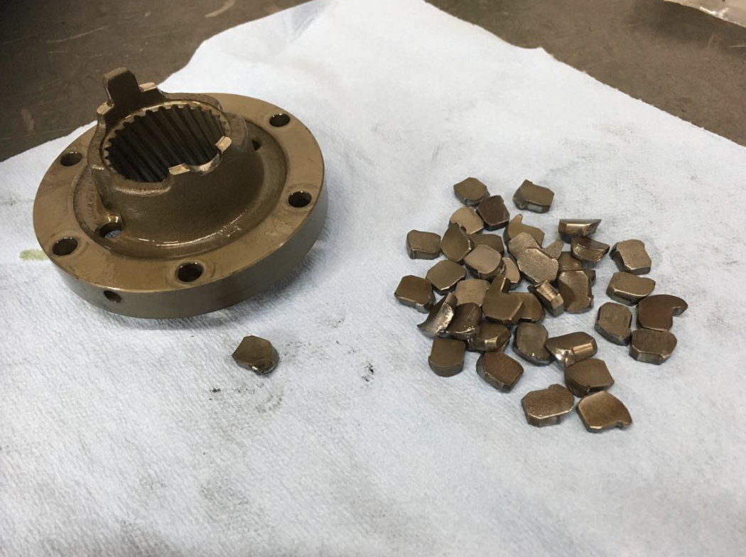

          I would 100% do the oil pump disc. kaiv has so many souvenir exhaust hub tabs to show that it is not worth the risk.
          Click image for larger version  Name:	Screenshot 2024-10-04 at 12.47.16 PM.png Views:	13 Size:	1,015.5 KB ID:	280523
                      Wouldn't this mean that the hub is more important to change than then oil pump disc, given that most of us has 100K + miles/km?
                      Besides VAC's hub, are there any others that can be used with a stock/unmodified oil pump disc that people have had good experience with?
                        I've reused two stock hubs and many others choose to do the same as well. Haven't heard of any issues when paired with the redrilled disc.
                        Beisan manufactures their own exhaust hub, and I'd choose that hub to replace a stock hub with a broken tab. Their hub has to be paired with a redrilled disc.

                                The issue with a toque wrench (at least I’m having) is all the 10mm crows foot wrenches I’m finding are 3/8” drive & a 3/8” drive toque wrench is not accurate measuring 14nm & no way it’s accurate measuring 10nm. It’s way too low on it’s rated scale, toque wrenches are not accurate at there highest & lowest numbers.
                                i was a Ford dealer tech for 7 years outta high school (I’ve been out of the car biz 25 years). I’ve always heard this about torque wrenches & decided to actually test it now 1/4” vs 3/8” w/ a 14mm socket & it’s WAY off. You have to rotate the bolt another 200° or so w/ the 3/8” to get the “click”. Again, I own cheap Harbor Freight click torque wrenches, if you have an $800 Snap On 3/8” drive digital torque wrench your probably using a much more accurate tool.
                                Yes, you could use a 1/4” to 3/8” adapter & a 1/4” torque wrench w/ a 3/8” 10mm crows foot. In theory it will effect the torque readings somewhat, multiply that with the slight change a crows foot can make & it seems to me there is a enough room for inaccuracy a torque wrench wouldn’t even be worth it.
                                Stanley Proto & Snap On both make 10mm 1/4” drive crows feet. That would be the tool to get, but both are like $35 + shipping + a week waiting for them to get here. The tool in the photo is on Amazon, but again 3/8” drive. I saw the Carslisle tool in the photo is similar - I’m guessing it’s also 3/8” drive.
