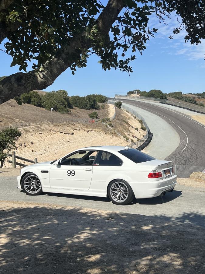

    Pic for attention 😁

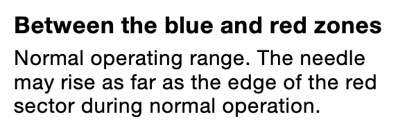

                        Modine now shows up as "NRF", but I haven't heard a whole lot of definitive data on it. My experience with it has been that it still lets my water temps get up to, but not into, the red. According to the manual, that's fine. I'd feel better if it didn't get up there, and I'm sure 100 people are about to come out and tell me that's bad, but the car's been doing it for a couple years now, hasn't shown any ill-effects, and I've replaced everything with OE, so here I am.
