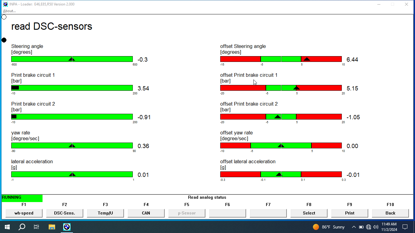

    So my M3 has a Yellow DSC and Brake light. I got this error about 7 months ago, i was able to clear with INPA then returned in early October. So i cleared it again, then i popped again later in October, now its popping up often.

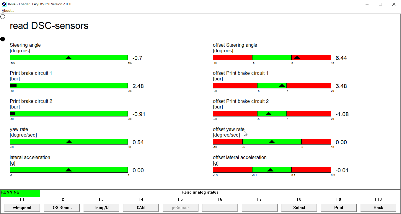

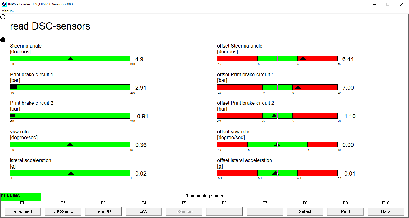

    So now i do need to fix this issue. I scanned with INPA and it seems like brake pressure sensor 1 has a problem. When the car is cold the offset for brake circuit 1 was 7 in the red, when I turned on the it slowly creeped back down to 3.48 in the green. So I definitely seems to be an issue with what i hope is the sensor and not DSC unit.
    I looked in the brake fluid reservoir and it does look a bit dingy, last time i had brake fluid flushed was 6/22 so little over 2 years ago, maybe i just need to flush the brake fluid?
    Which is brake pressure sensor 1? Nearest to firewall, or away from firewall?
    Another question offset steering angle is in the red, from INPA live data, is that something to worry about? steering wheel seems straight.
    couple of screen shots: First Screen Shot was cold, engine not running, 2nd and 3rd was engine running it eventually settled at about 3.48

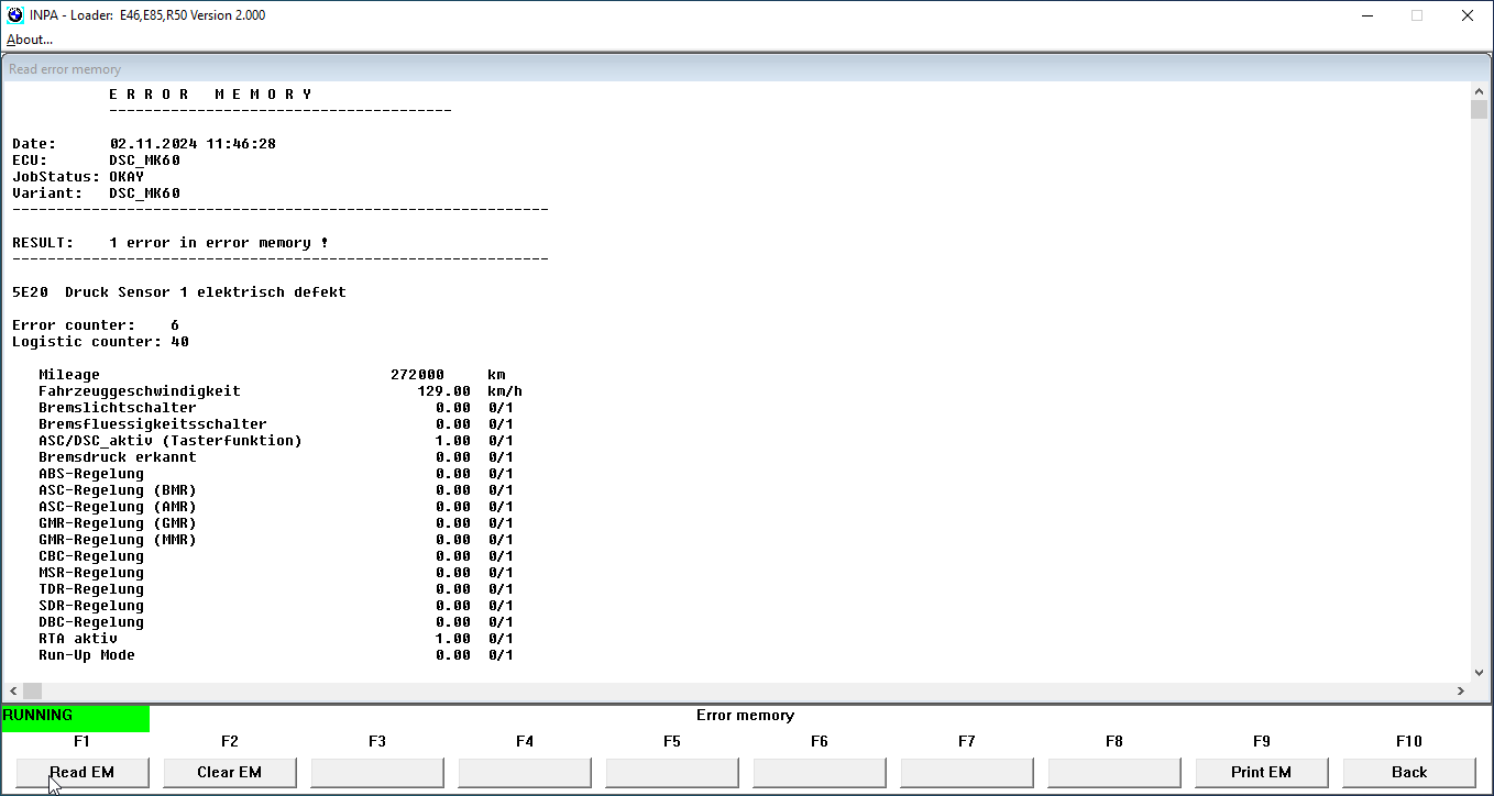

    INPA Scan
    Code:
    E R R O R M E M O R Y
    Date: 28.10.2024 20:12:59
    ECU: DSC_MK60
    JobStatus: OKAY
    Variant: DSC_MK60
    RESULT: 1 error in error memory !
    5E20 Druck Sensor 1 elektrisch defekt
    Error counter: 6
    Logistic counter: 40
      Mileage                              271590 km
      Fahrzeuggeschwindigkeit            2.00 km/h
      Bremslichtschalter                         1.00 0/1
      Bremsfluessigkeitsschalter          0.00 0/1
      ASC/DSC_aktiv (Tasterfunktion)  1.00 0/1
      Bremsdruck erkannt                     0.00 0/1
      ABS-Regelung                              0.00 0/1
      ASC-Regelung (BMR)                  0.00 0/1
      ASC-Regelung (AMR)                  0.00 0/1
      GMR-Regelung (GMR)                  0.00 0/1
      GMR-Regelung (MMR)                  0.00 0/1
      CBC-Regelung                         0.00 0/1
      MSR-Regelung                         0.00 0/1
      TDR-Regelung                          0.00 0/1
      SDR-Regelung                         0.00 0/1
      DBC-Regelung                         0.00 0/1
      RTA aktiv                             1.00 0/1
      Run-Up Mode                           0.00 0/1
      kein passendes Fehlersymptom
      Testbedingungen erfuellt
      Fehler momentan vorhanden und bereits gespeichert
      Fehler wuerde das Aufleuchten einer Warnlampe verursachen
    Error code: 5E 20 E0 06 28 6A 17 02 09 00 04
    Start with a flush. If it comes back then yeah, the likely culprit is the sensor.
    Fortunately the sensors are expensive and extremely annoying to swap out
      There’s 2 same sensors, if you do them, do both.
      You can get in there with an open ended wrench, not exactly fun but it’s ok.
      I’ve personally had good luck with aftermarket ones from eBay here, much cheaper.
        You can also find those two sensors on any e46 2002+ with an MK60 at your local pick'n'pull and spend a few bucks.
          Thanks for the suggestions, will update this post when I get this issue resolved.
            I guess i never updated this. Ended up purchasing 2 new sensors and getting new fluid and problem is solved. Decided to replace both sensors as these were most likely original sensors. car now has 170k mi.
