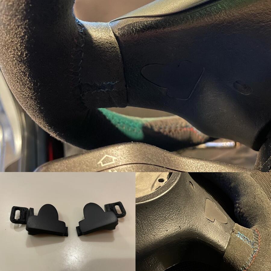

                          Anyone doing this, I now sell custom plugs to fit in the steering wheel where the paddles used to be. You may have seen them on Facebook briefly, I'm just waiting until I have enough posts to be able to post them for sale on here.

                            That’s excellent

                              How much we talking?!?

                                details here: https://nam3forum.com/forums/forum/c...lugs#post79080
