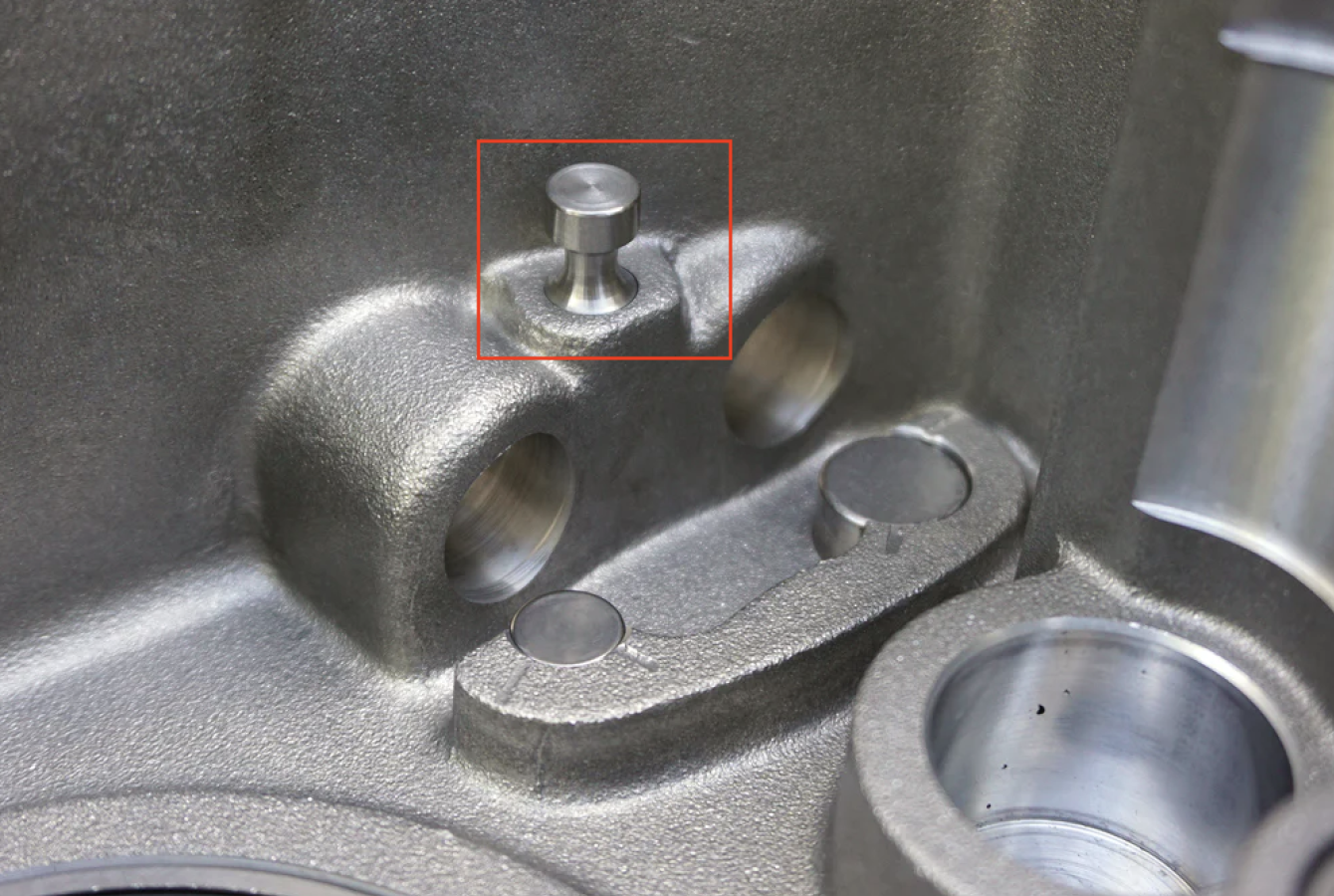

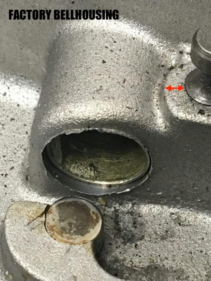

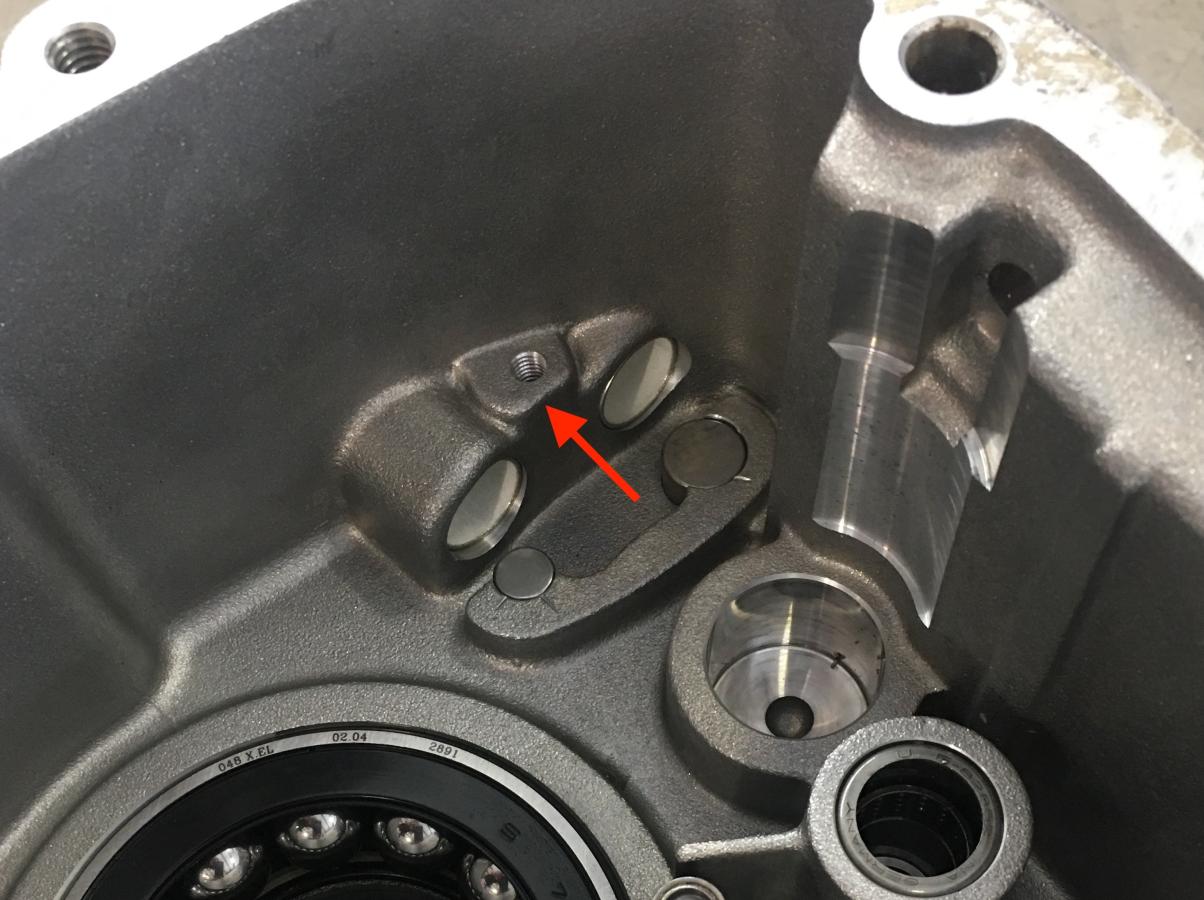

                    So I had my bell housing modified and just want some peace of mind (or worse, confirmation I'm not crazy)
                    When tapping the torsion spring stopper,, does it matter that this is off-center? A few other shops who do this service center the pin just like factory does but for some reason the guy I went with is the only one who does not. And when I asked the question twice it went unanswered both times, only to be told I'm overthinking it and it doesn't matter because "that's not how it works".
                    Thoughts from the peanut gallery? First pic is mine. Second is factory. Third is another modified one from different shop.
                      Originally posted by jvit27 View Post
                      And when I asked the question twice it went unanswered both times, only to be told I'm overthinking it and it doesn't matter because "that's not how it works"..
                      They should give you the clear ans.
                      It's nice to have the screw centerly installed, but a little bit off can be compensated by bending the spring so that when the spring end rested on the said screw, the 22mm ball bearing should lightly touch on the 5/6th detent pin, and this is the 3rd/4th gate position.
                      Yours has the pin offset toward the 5/6 detent, and this requires bending the spring end more to have the ball bearing touching on the 5/6 detent pin.
                      Someone should make and sell the accentric pin instead, and by rotate the pin until the ball bearing touches the 5/6 pin instead of bending the spring, not a trivial task, to achieve the same result.
                      The most important part of the bell housing machining is the location of the two holes for the detent pin sleeves. If they are off then this cause difficulty to shift, to find gates 5/6 and 1/2 and R.
