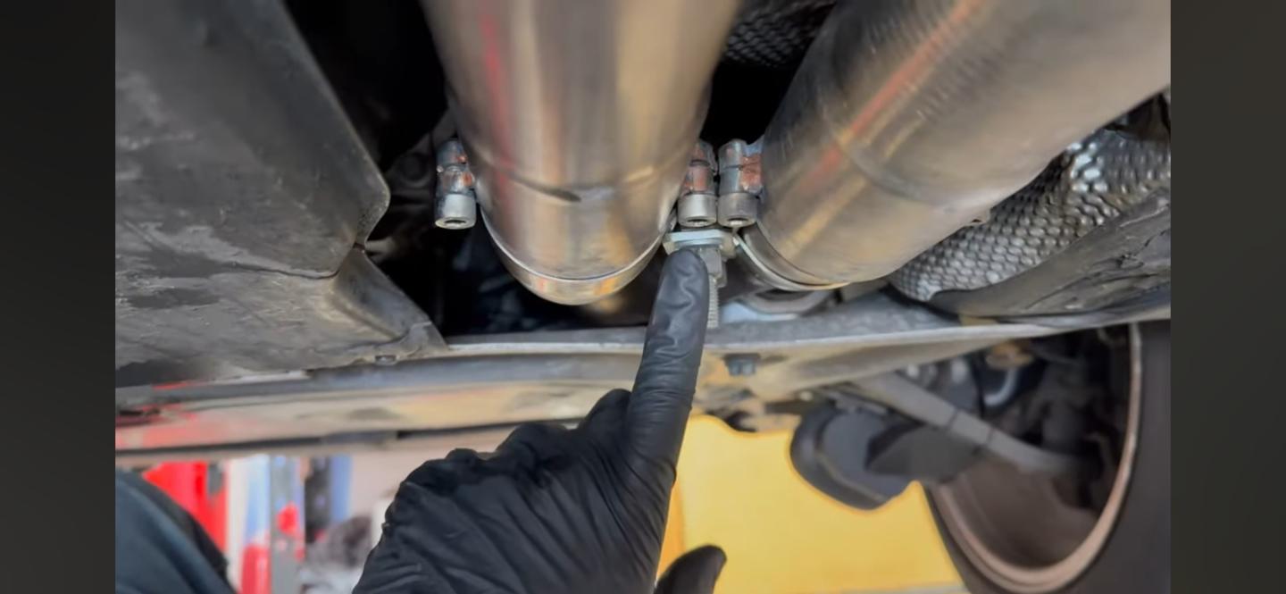

    I've been getting some resonance with the complete 2.5" system and i came across the video.
    Has anyone tried a bracket like this?
    Anyone know what that dual clamp is called (essentially tying both pipes together)?

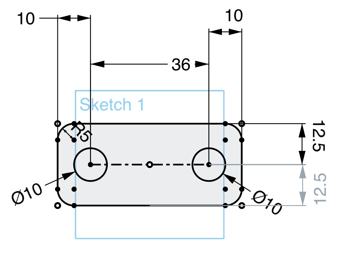

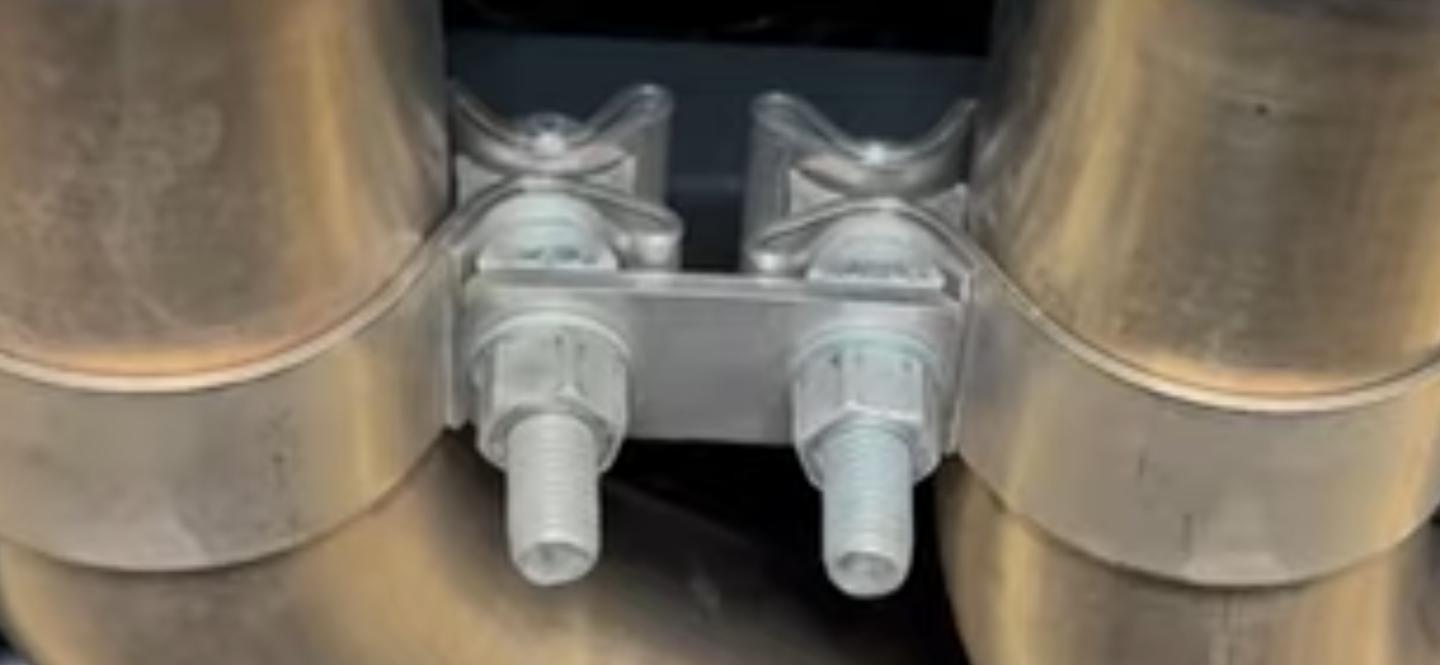

          Just a laser cut piece of 304 stainless joining the two exhaust clamps. Those clamps are made by evil energy if memory serves. Picked them up off of amazon.

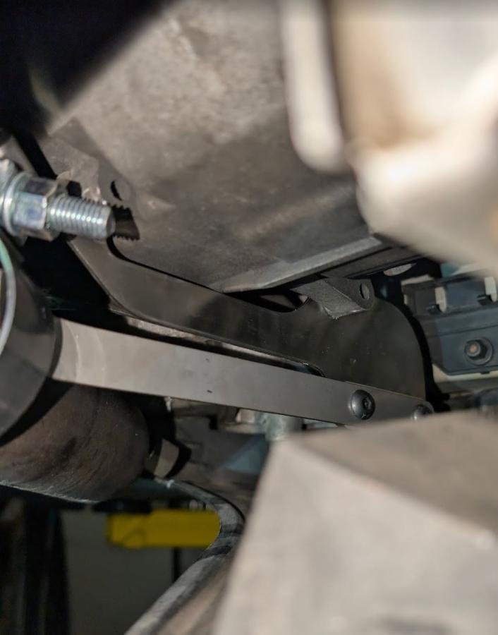

          each bracket helped with NVH, the one that bolts to the gearbox probably the most, then the one at the headers, then the one at the back. Of the latter two, the effect was more similar than the former. DXF for the laser cut piece attached.

              Also, is this part (pic attached) the same stainless steel piece turned vertical, joining two staggered clamps?
              Which would be... 5 of these clamps in total with two stainless steel brackets, and the two piece transmision braket?

                Yeah this is awesome. Is this two separate pieces (a top that contours around the tranny and a bottom that connects straight to the exhaust?

                  All correct above, except that the transmission brace is three pieces. There’s a little spacer in between the two parts that looks a lot like the small bracket.

                      Use this link to purchase all the brackets (5 total parts): https://cart.sendcutsend.com/ygpv6yonwfpq (EDIT: This link is my first design, does not fit without modification. New link coming soon)
                      You’ll just need four M8 x 16-20mm fasteners and two M8 nuts for the transmission bracket. Enjoy!
