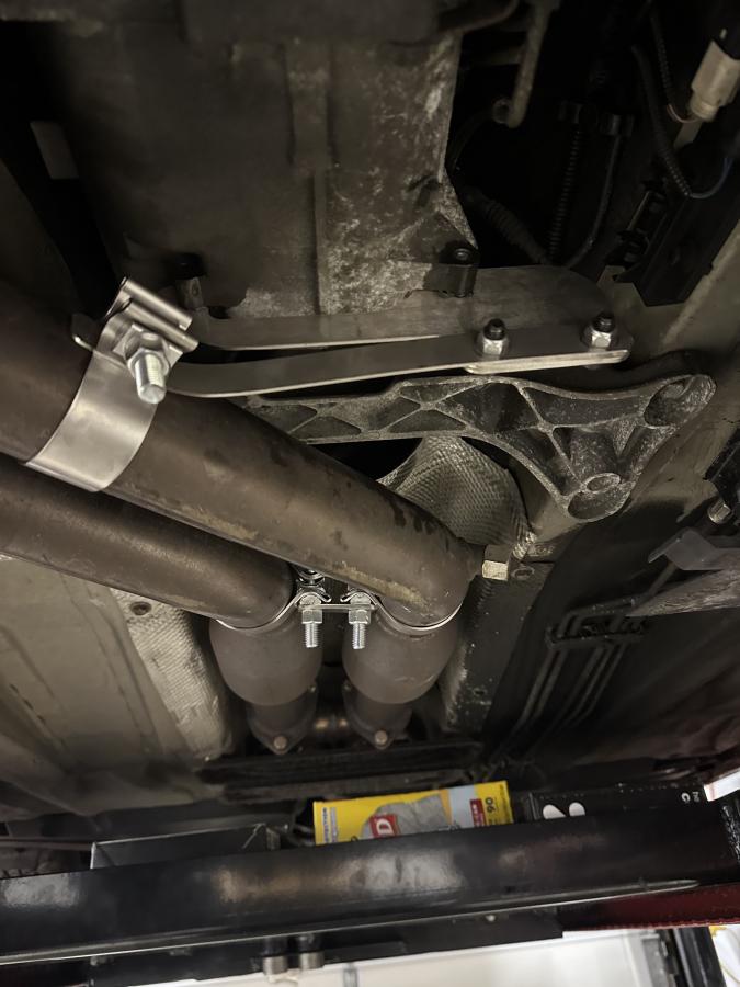

                    I installed mine yesterday. It surely has changed the resonance at various rpms, but I seem to have more resonance at highway speed at 65-70mph. It may be my partially ill fitting catted section 1 being forced into a position, but it seems to be noise coming from the rear, which is a Dinan section 3.
                      #55
                      Interesting! It may not be making a difference but you’ll want the bend in the lower piece to be a bit tighter radius than you’ve got it if you can. And also keep the lower as parallel to the upper as possible.
                      Did it improve behavior during downshifts and gear changes? If not, it may not be helping with your setup!
                        #56
                        Thanks, I will try to get the bend radius tighter, but the metal is currently parallel. It just looks strange at the angle of the photo. I think it did improve with gear changes and also seems to have removed some of the rasp from the exhaust. I have a new catless section 1 sitting in my garage so will chime back in when I have that installed to rule out the one I currently have.
