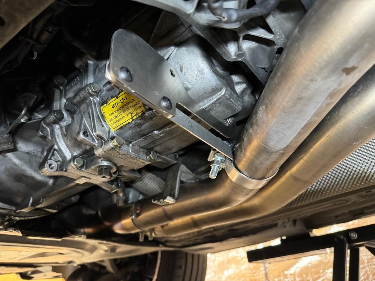

    Click image for larger version  Name:	IMG_4147.jpg Views:	26 Size:	89.1 KB ID:	285837
    My has just arrived, thank you so much for the fast turnaround!!

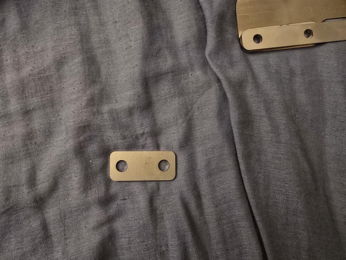

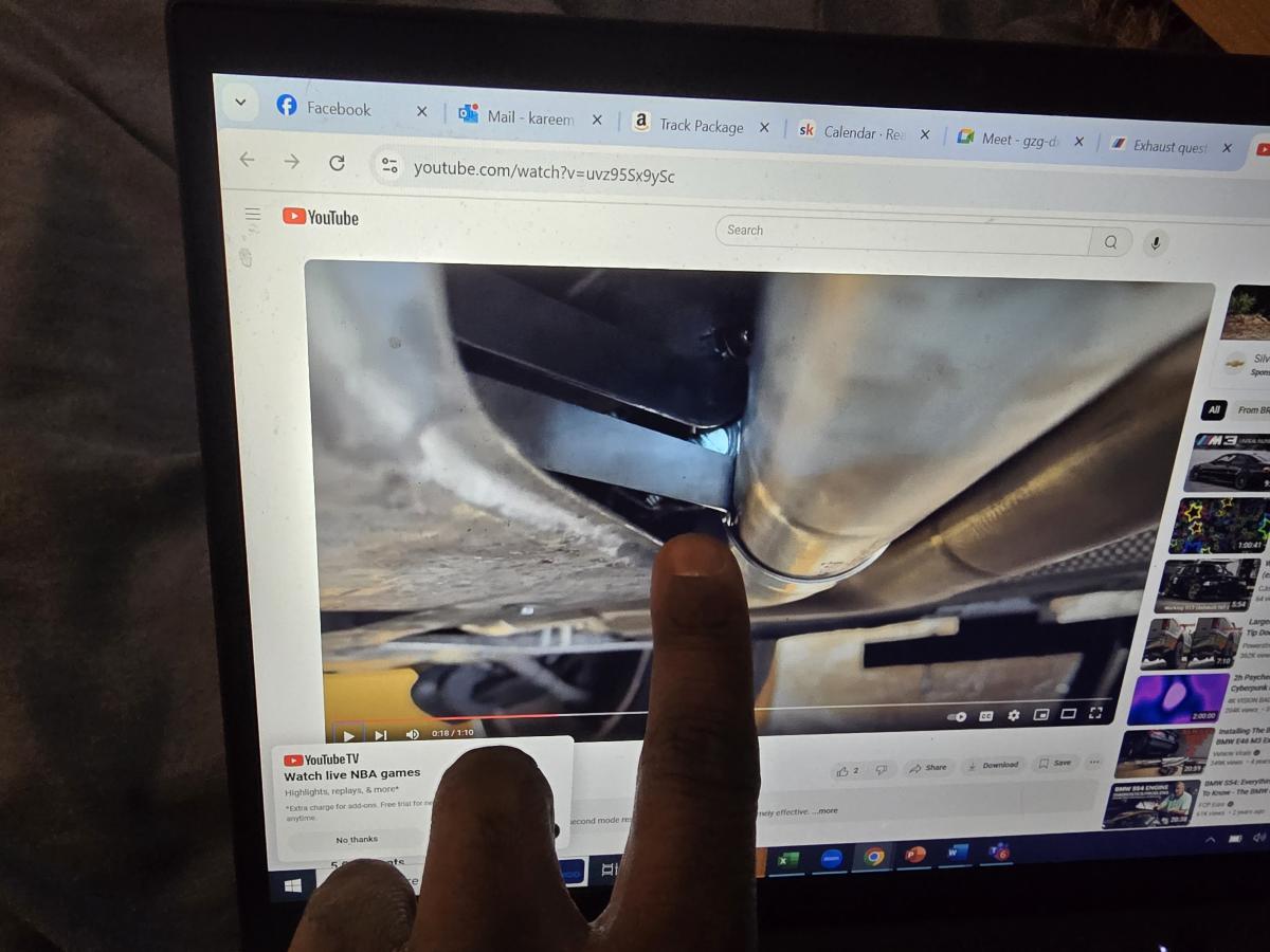

    I understand the tranny bracket and the spacer to the long bracket... but how does that brack connect to the clamp that holds the exhaust pipe?
    It looks like your end looks different than mine

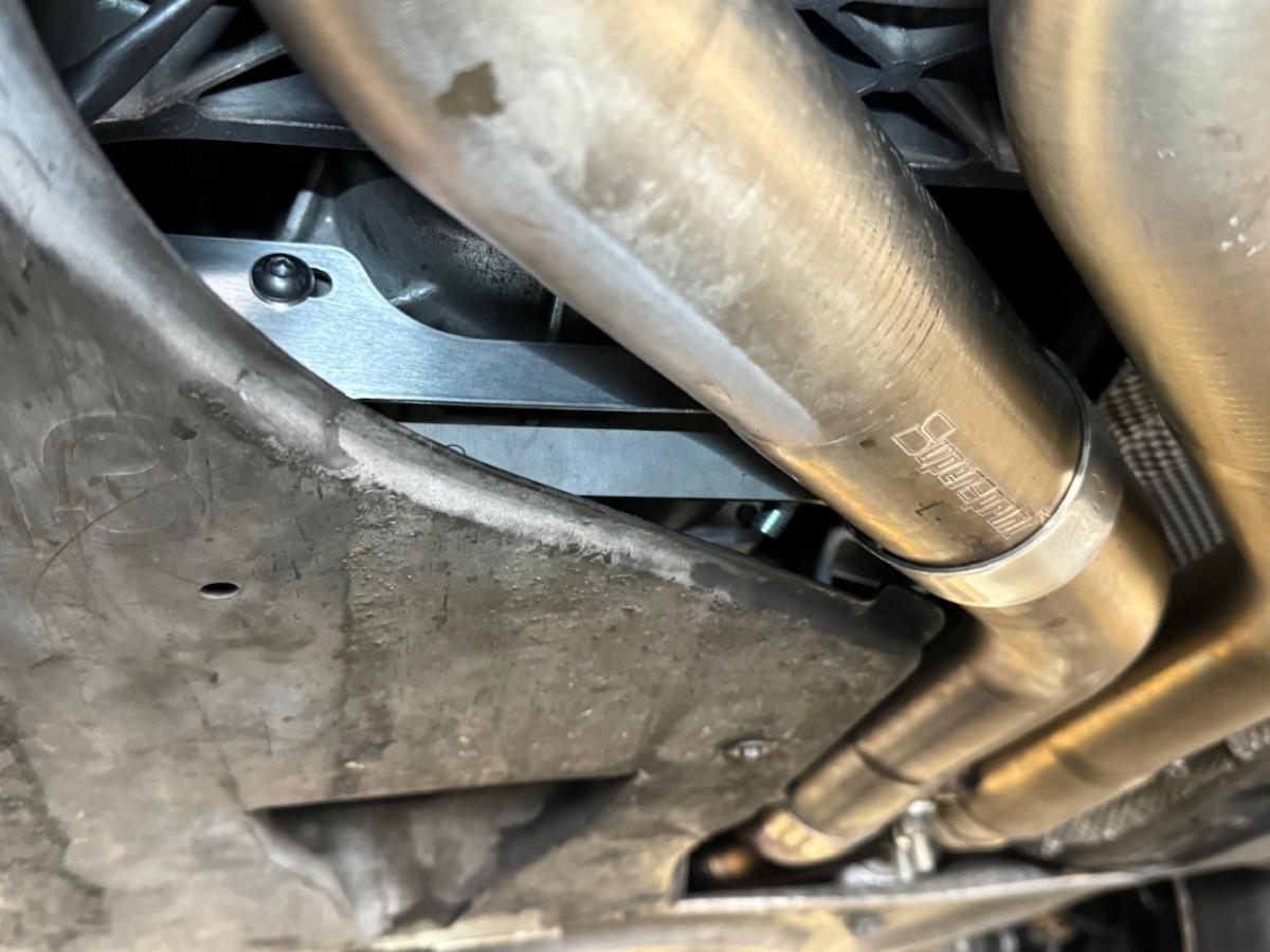

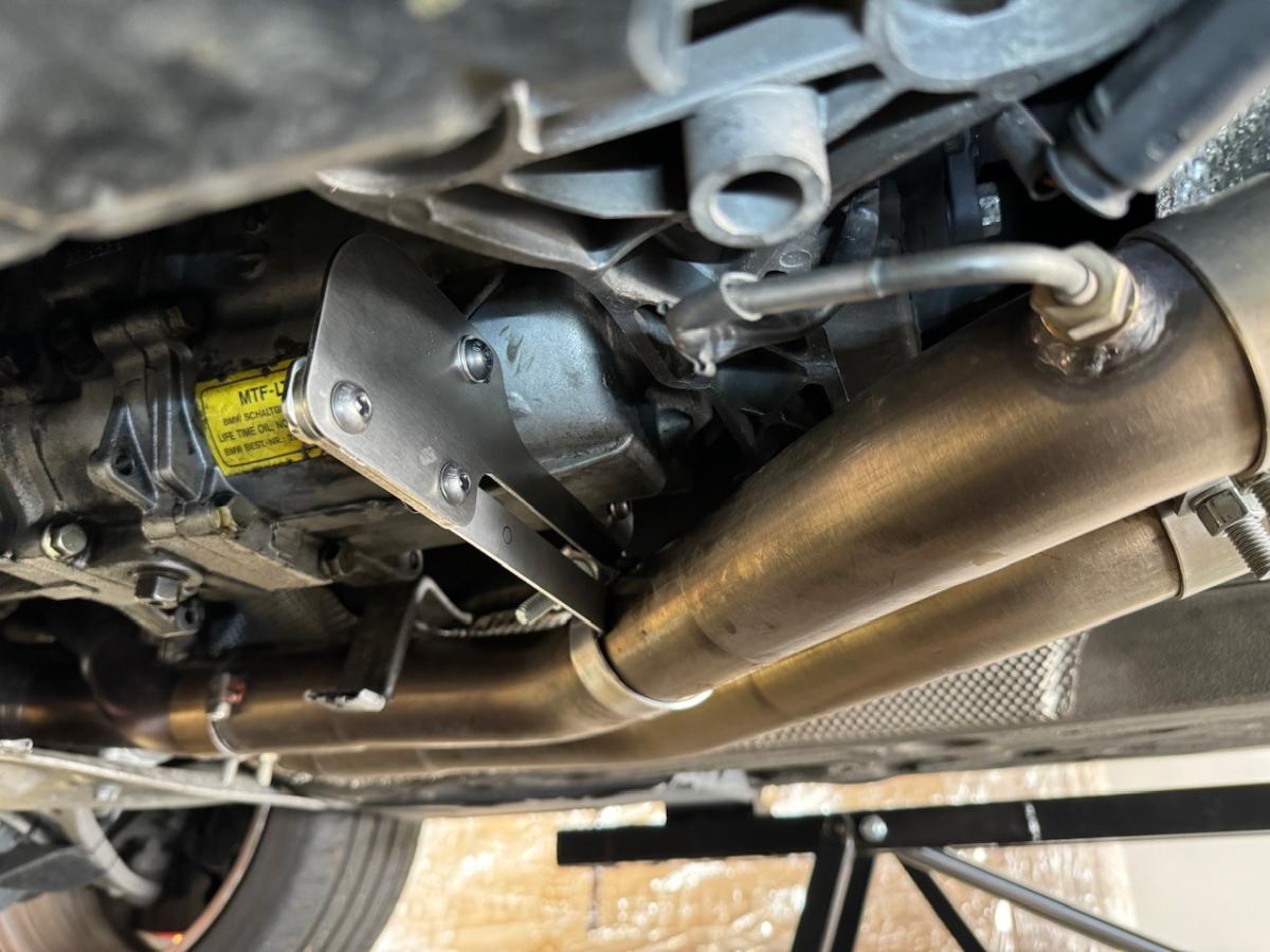

      It almost looks like he bent the tip of it into the strap and held it in place by clamping it down. I had the same question though, thanks for the test fit and assembly.
      you’ll have to confirm which length you bought for the screws since there was a range provided.
      📸 @alpinem3
        #33
        Yep, bend to fit! This way it’s compatible with both pipe diameters, and can accommodate the rather crappy SS manufacturing tolerances.
        It should easily bend with a vice or two pairs of big pliers. I used two pairs of knipex parallel pliers (greatest tool ever) to bend mine to fit in situ.

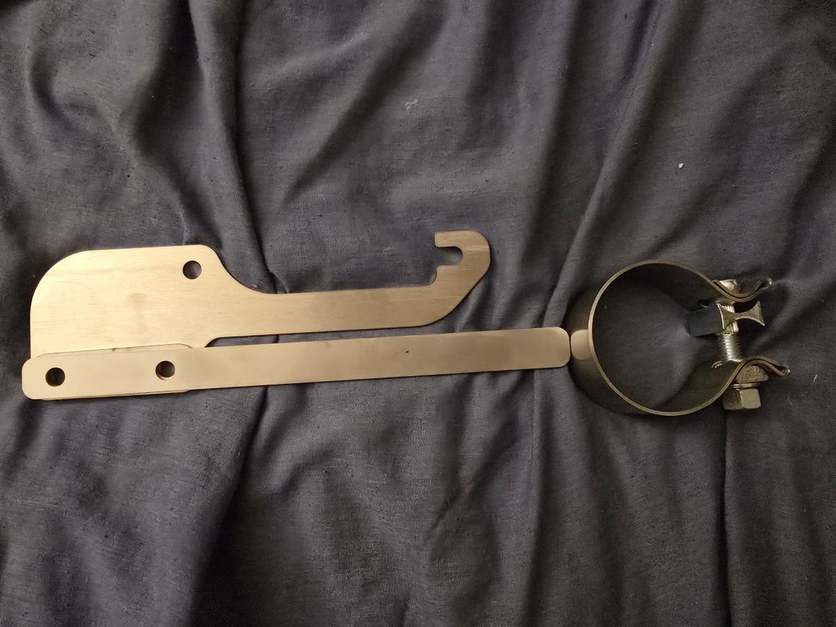

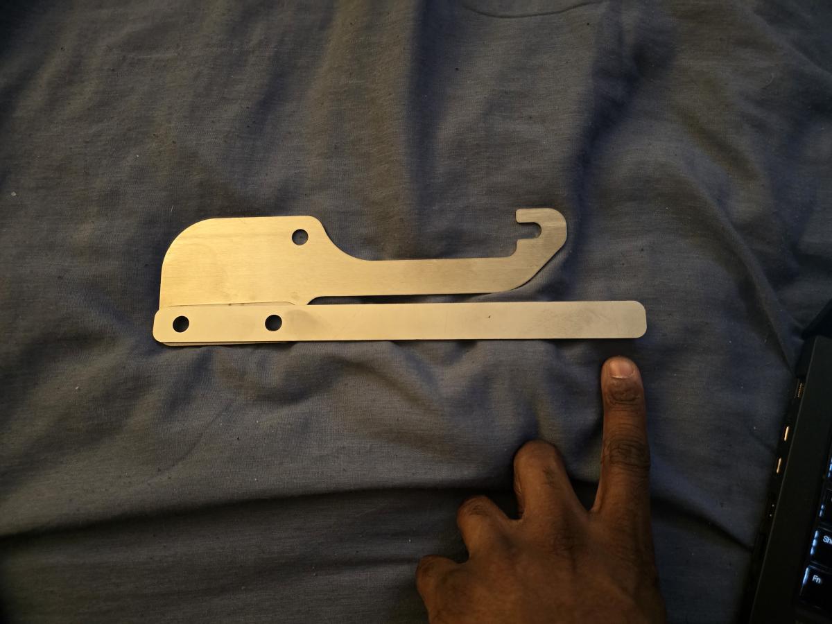

            Hmmm... I'm thinking of ordering another small bracket. As I look at the piece, I wonder if I weld it to the side of the drivers side clamp, the use the third small bracket to marry both sides together.
            Thoughts?

                I meant i could weld to the clamp in the pic (which is can remove, and the use the third space to bolt the 2 clamps together, like the other 2 in the system. Are you saying there may be a problem doing that?
                Also, I'm trying to test fit now. Did you have to make the hole that attaches to the tranny wider (like longer)? I can't seem to get the holes to line up.

                  Uh oh. I designed two versions of this bracket, the first one didn’t fit perfectly. I may have inadvertently linked everyone to the first design. Yes, you’ll need to make the slot deeper to fit. Damn, I’m sorry everyone.

                          I see you guys. Very busy with work at the moment. Took a bit of time to build a package that was a one click order.
                          The bracket in my car is the same one that needed manual modification, so it is possible to make it fit for those that have ordered and own a grinder, Dremel, etc.
                          edit: the easy way to modify would be drilling a new hole on the driver’s side, making a sort of infinity symbol. This may have been the approach I took, memory is weak. It can be free handed with a 9mm, 11/32 or 3/8” drill bit.

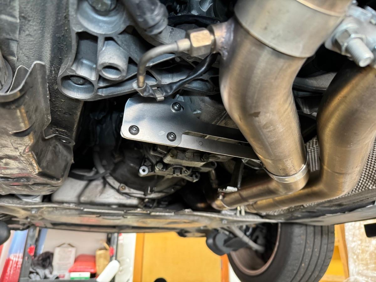

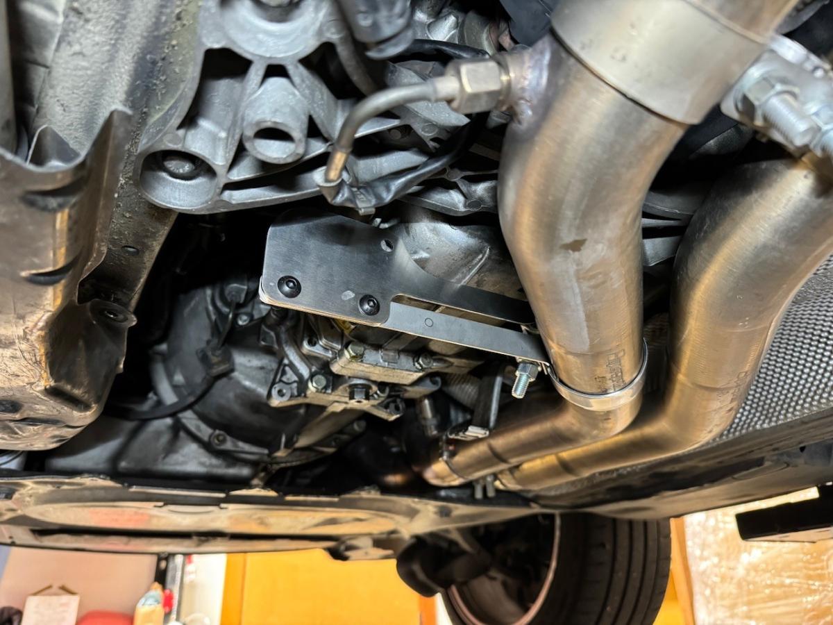

ID:	286265 Here are a few photos that might be helpful. Essentially slot/figure-8 the hole
                            Click image for larger version  Name:	IMG_1957.jpg Views:	0 Size:	108.9 KB ID:	286261 Click image for larger version  Name:	IMG_1955.jpg Views:	0 Size:	127.9 KB ID:	286262 Click image for larger version  Name:	IMG_1956.jpg Views:	0 Size:	118.5 KB ID:	286263 Click image for larger version  Name:	IMG_1949.jpg Views:	0 Size:	132.9 KB ID:	286264
                              #44
                              Bry5on - thanks for the extra pictures. Should be easy enough to widen those holes out.
