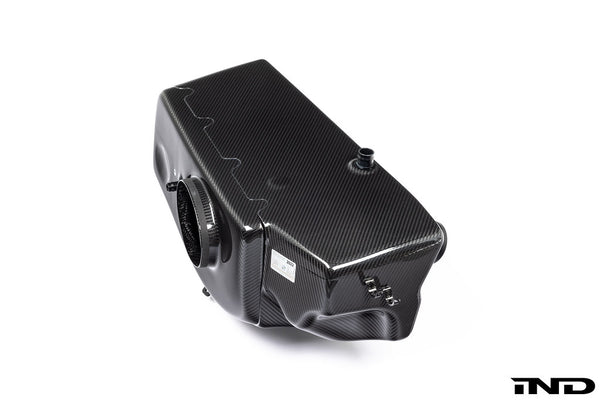

      This is the one I was looking at.
        Yeah, that's Turner's version of the CSL intake...seems like the people who have it like it although I recall a member on here saying the trumpeted end was rubbing on his car. Pretty good deal though for a carbon intake all things considered.

                          Does that Turner box use the same shaped filter as the OE part?
                            Yes, and funny enough, the OE style filter fits and seals better on the Turner box versus Karb. Karb stopped making a carbon frame for the filter a while back. The ITG foam filter is probably a better fit for the Karb airbox and that is what they sell.

                              There is 1 more option:
                              OEM Carbon Box from Karbonius
                              BMW E46 OEM STYLE AIRBOX, CSL Airbox is one of the most demanded improvements among BMW M3 E46 enthusiastic. That is both for performance gain, and for sound it brings to car. On the other hand, it is a laborious, time-consuming and expensive modification. For those who are looking for similar sound to CSL airbox but do not look for HP gain, we have developed the Karbonius OEM Style S54 airbox. It is a simplified version of CSL airbox, that, apart from louder sound to engine (+12 dB compared to plastic OEM) gives awesome appearance and easy installation using stock elbow and MAF. No needed to install any additional hardware or remap. *In SMG version, genuine BMW CSL SMG expansion tank needed. Regarding power increase, we got +4HP in recent dyno test comparing with OEM airbox. Not really significant considering that dyno can have a 2% margin error. In conclusion, and pending new test in future, we can say no significant power increase and no HP loss. As usual, piece manufactured 100% in carbon fiber prepreg, cured in autoclave in our facilities in Spain (EU) under strict quality requirement and for qualified stuff. Kit Includes: • Airbox • CNC machine-made items of anodized aluminium • Stainless-steel screws • Certificate of authenticity Characteristics: • Similar sound to CSL airbox • No remap needed • 100% Carbon Prepreg • Cured in autoclave • High gloss UV protection varnish • Perfect fit. No adjustment required • 2 years guarantee Fitment: • BMW E46 M3 • BMW E85/E86 Z4M
                              Get some of the carbon box sound without needing to tune or modify DME.
