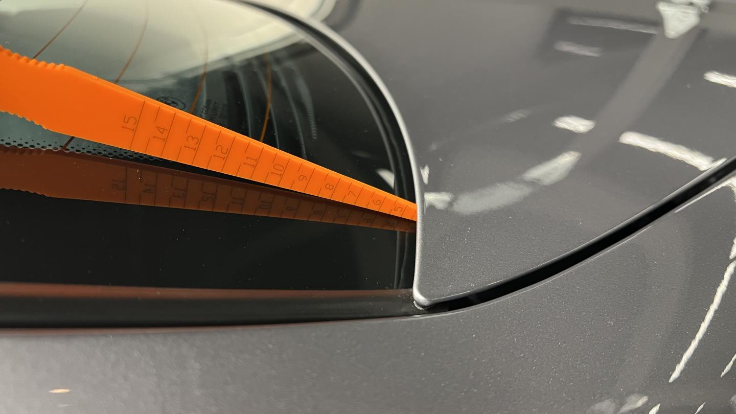

                              Has anyone had any issues with the new batch trunks sitting close to the rear windshield? Mine nearly touches the glass.
                              Additionally, does anyone know what mounting point I need to adjust to push it further out? I have the mounting point where the 4 torx screws go maxed out, but it didn't move it out much.
                              I read through the long Slon thread to see if its mentioned there, but I couldn't find any more info on adjusting tips.

                                I previously measured the gaps when I did my trunk. The factory gap between rear windscreen and trunk is approx 3.8mm-4mm. If it's smaller than that, use a 13mm to loosen the rear bolt on the hinge (closest to rear windscreen) then tilt just the rear portion of the hinge upwards to add a little more space.
                                In regards to pushing it out more, I haven't tried this, but you may be able to loosen all 13mm bolts slide the whole assembly towards the rear of the car a little.
                                Another method I used was to back all of the mounting screws off just 5%. This way when it was left alone, it was really stable, but if I pushed / pulled / bumped, the trunk hard enough, it would slightly move. After I got it where I wanted I would tighten everything down and check. Repeat as necessary.
