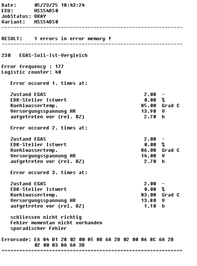

                            After several hours of driving, now I have a "230 Inlet target/actual comparison" error. 🙂
                            Hasn't triggered a light...yet.
                            Occurrence details translated:
                            "Zustand EGAS" - Condition EGAS - not 100% sure what this represents, and why there are no units.
                            "EDK-Steller Istwert" - EDK Actuator Actual Value - EDK is the throttle actuator, so this happened when the throttle was shut.
                            Bottom text translates to:
                            "don't close properly Error currently not present sporadic error" - Cool cool cool
                            This is pointing me to either VANOS internal seals, which were done with Beisan seals ~4 years and 40k ago, so that seems premature. Granted they weren't done by me, so maybe they were done wrong. Solenoid pack flaking out again, or the intake position sensor dying. Feels like Russian Roulette, any bets on where to start?

                              Oh duh, this says EGAS not EVANOS. This is an ethrottle issue, so completely unrelated to the VANOS issue. I was primed to see a vanos error!
                              Ok I'll chase this down separately from this thread and keep it on topic here.
