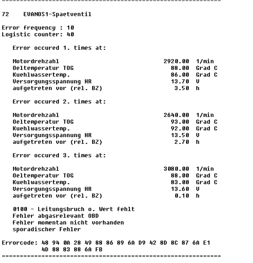

        Interestingly enough INPA gives a little more metadata with the error:
        Line break or value missing
        Error Emission Relevant OBD
        Error currently not present sporadic error
        "Line break or value missing" is interesting to me. Can't tell if that's just generic text that gets tossed in there with the code, or if this is trying to lead me to a more direct cause, which would make me think solenoid pack over piston seals. I'd also expect bad piston seals to show poor VANOS test results.

          "Line break or value missing" sounds like a SW thing to me, not mechanical. Not entirely sure what INPA is trying to communicate here though, maybe someone else can chime in.

            Are the text in the same screen with code 72?
            Before blaming the vanos solenoid you should try to read the cam angle to see how far off it is; if a little off then the solenoid is working, and if it's off a lot then the vanos piston did not move.
              Yep, text is in the same screen with the 72. Attached the INPA screenshot.
              Tough thing with reading the cam angle is that the issue is intermittent. My thought is that since the VANOS test is successful, the solenoid and piston are at least working as expected some of the time. I suppose I could drive around and watch the cam angles, but without knowing what they should be, it will be hard to tell if it's "off". Even then, I'd have to catch it, which seems like a crapshoot.

                All error occured with hot engine (93C one time which is hotter than normal), and above 2500 rpm so the vanos was activating. No error happened with cold engine, interesting point. Yes, check vanos oil P at hot engine.

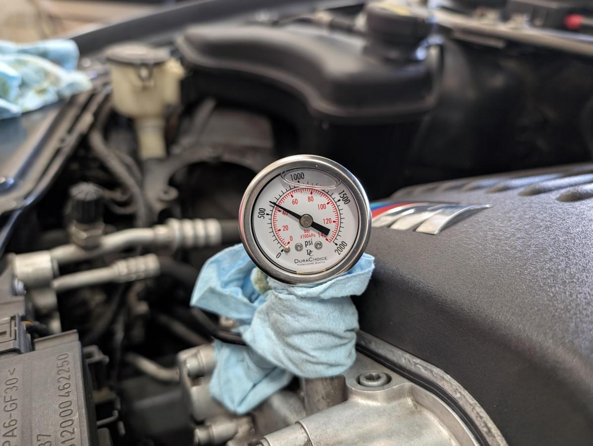

                  Alright VANOS oil pressure definitely seems low. By this thread it sounds like I should expect ~115 bar at hot idle. I'm seeing ~40 💀.
                  Click image for larger version  Name:	PXL_20250629_175808418.jpg Views:	0 Size:	115.7 KB ID:	310286
                  Also see this video of the pressure while the VANOS test is running via Tool32. RPM bump brings the pressure up to 60 bar, but it's all still way too low.

                    I had hesitation issues when I had low pressure, also it will always pass VANOS tests, but the time to adjust was high (close to 300ms)
                    you want at least 100bar with oil at operating temp (75 to 90).
                    If the pressure is low the adjustment will be erratic if the engine needs to adjust cams continuously, as it would be during city driving or roads with varying load conditions.
                    the issue with redrilled discs is that you are shooting in the dark as those could be worn and drive lower pressure
                    beisan sells new units for not that much (1500). I actually asked them for a unit which disk was not removed and original to the unit, this meant no redrill.
                    edit: like you my pressure wan in the 40’s bar too.

                              Either the pump is inefficient (pistons not matched to disk holes) or vanos has too much internal leak (pistons seals, P regulator, etc)
                                New Beisan unit in, and now I'm seeing ~110 bar running through the VANOS test. We'll see if this resolves the codes, but definitely a step in the right direction here.
