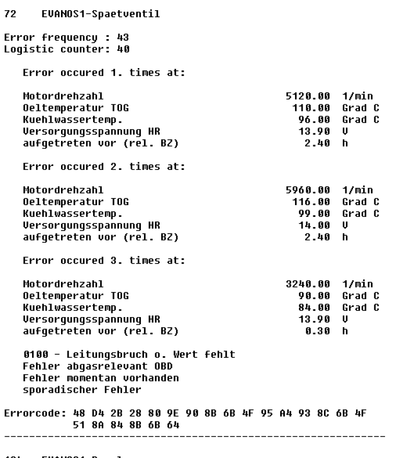

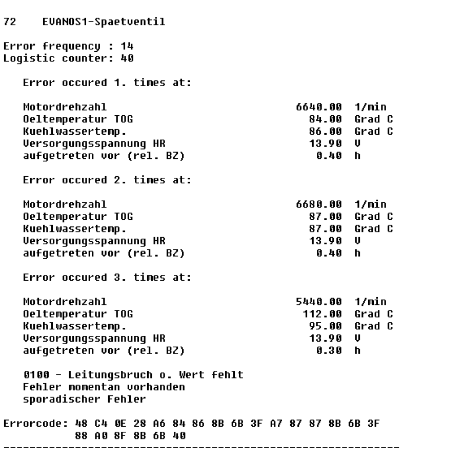

    Whelp, 72 and 184 have reappeared at VIR this weekend. Frustrating.
    72 - "Intake VANOS, late valve" again comes with: "Line break, no value. Missing." Though this time it also came with: "Error currently exists". So maybe it's more firmly dead?

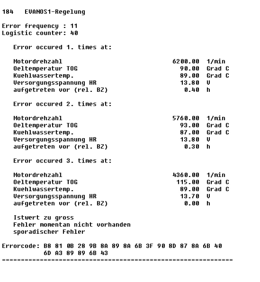

    184 - "Intake VANOS, regulation" comes with: "Actual value too large".

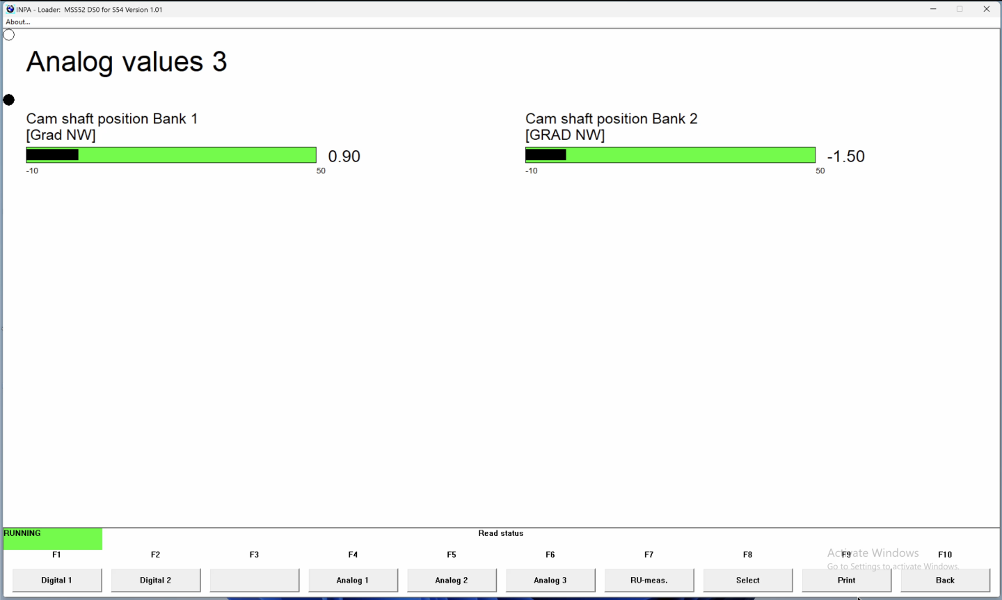

    Looking at the camshaft angles in INPA, they move around and read just fine. I have no idea what they should be to know if they look right.

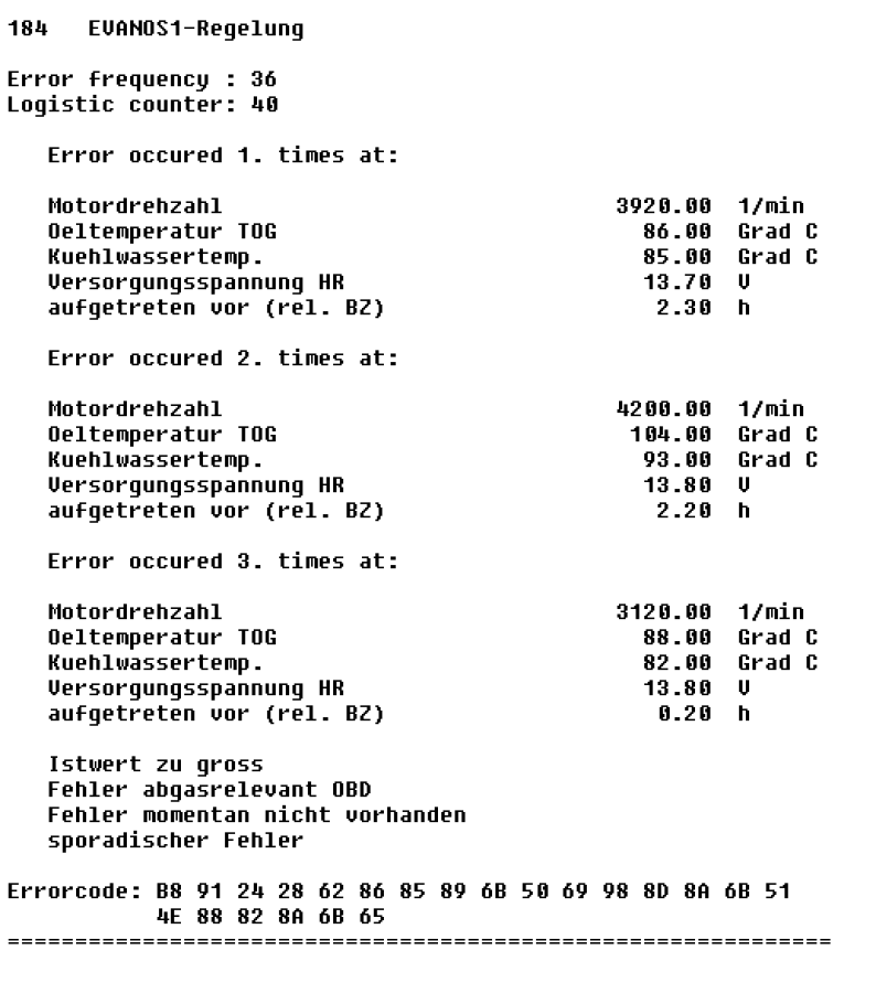

      The errors happened at higher rpm. The bottom of the sreenshot shows hex B8, and other error codes that I have not tried to understand why it listed the long list....
          That's just the hex representation of the data presented above. 0xB8 in decimal is 184 - the error number, 0x91 is the error type (istwert zu gross = sensor value too high), 0x24 and 0x28 are Error Frequency and Logistics Counter respectively and the remaining bytes are the 5x values recorded for each of instances 1 to 3. first 4 values are bytes and the 5th is a word.
