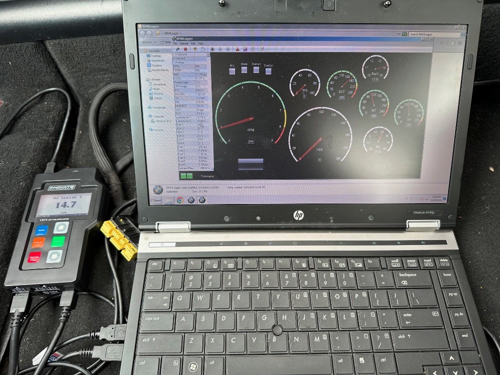

    The injectors really threw everything for a loop compared to a “normal” tune, but Hassan was great. He had a general idea of where they would be from previous cars, but we played it safe—exactly what I want.
    First, fired it up and monitored AFRs at idle. All good.
    Next, fire it up and monitor AFRs while holding it at 2000 rpm. Also good.
    Then, the part that I think really has set this tune apart from every previous tune I’ve had—road tuning! Every previous tune I’ve had has been WOT runs on the dyno. He spent way longer with me than I would have expected, working over and refining the tune as I drove around. Full throttle, all sorts of partial throttle, all RPM. The car feels freaking great—never stumbles, pulls from all RPM, blips readily/enthusiastically, etc. I still intend to try the drivability spreadsheet for fun (and because it’ll haunt me forever if I don’t), but I am dubious there’s room for improvement at this point.
    I also have no doubt this tune is safe. Knock sensors are left at stock values, and we have a nice, safe 12.5 AFR from ~5500rpm to redline to keep it cool and knock free on track.
    Haven’t had it in on a dyno, because I frankly don’t care so long as it drives correctly, but the car feels STRONG.

              Basically you need a way to log AFRs, RPM, and load. Then you drive around in the style you want to tweak and he updates the tune based on what the logs show.
              I used BMWLogger. Were I doing it again, I’d use Testo.

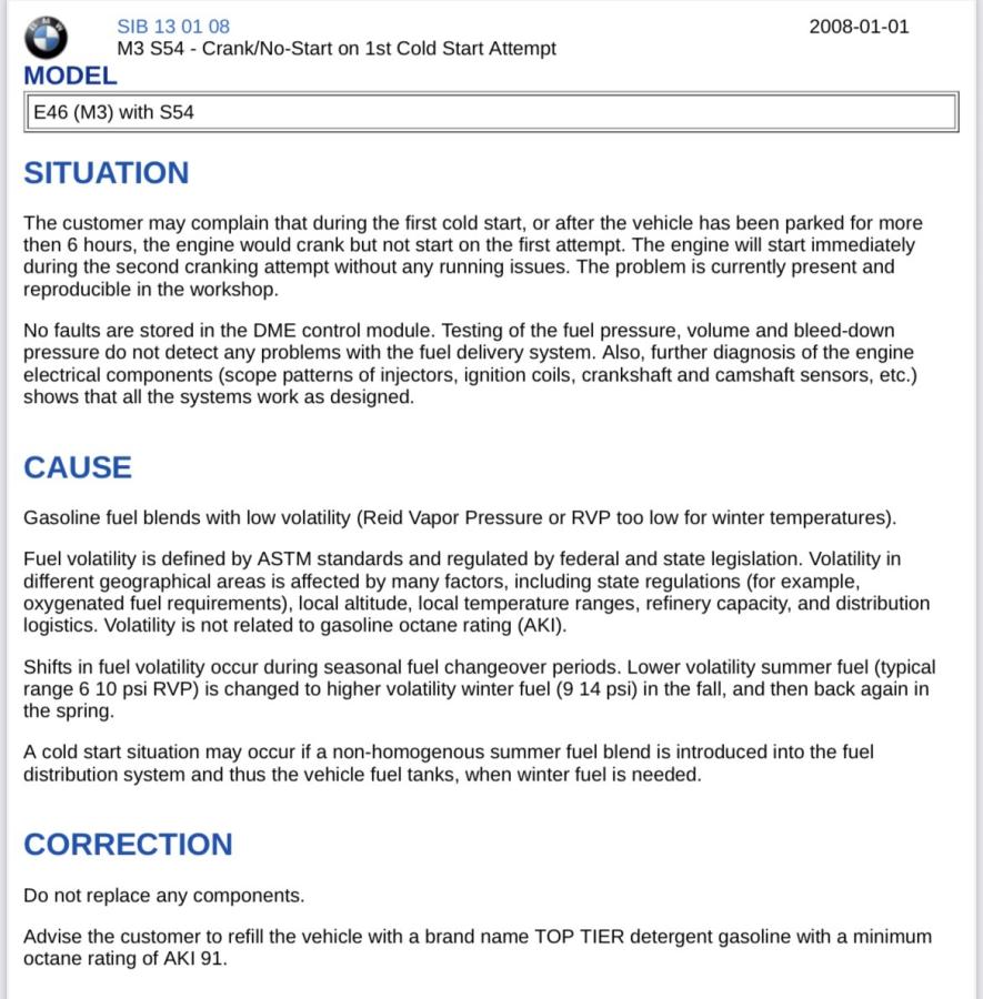

                  Shoutout Hassan’s follow-up as well. I used a canned tune and I had a few running issues since my car was manual swapped and he took care of every issue I brought up. Check engine light, running rich? Fixed it. Cold start stumble? Fixed it. Also knew when not to fix as I had a problem with my car not starting on first crank but would immediately start up on second crank and he told me it wasn’t tune related and lo and behold after searching, there was service bulletin for that issue. I’m running Alpha-N and the car runs clean and performs great!

                    What's the service bulletin?

                      Attached it to my last post. Looks like the fix…is nothing (good gas)
