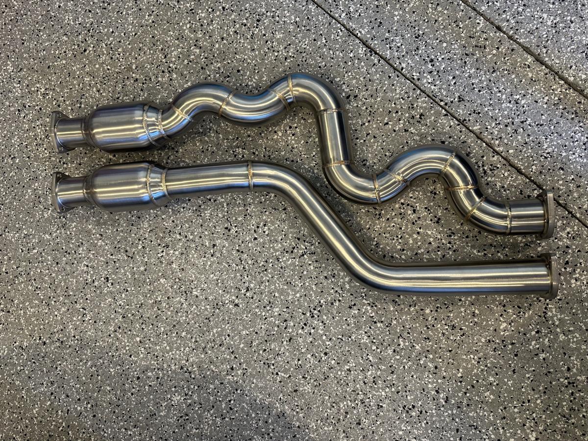

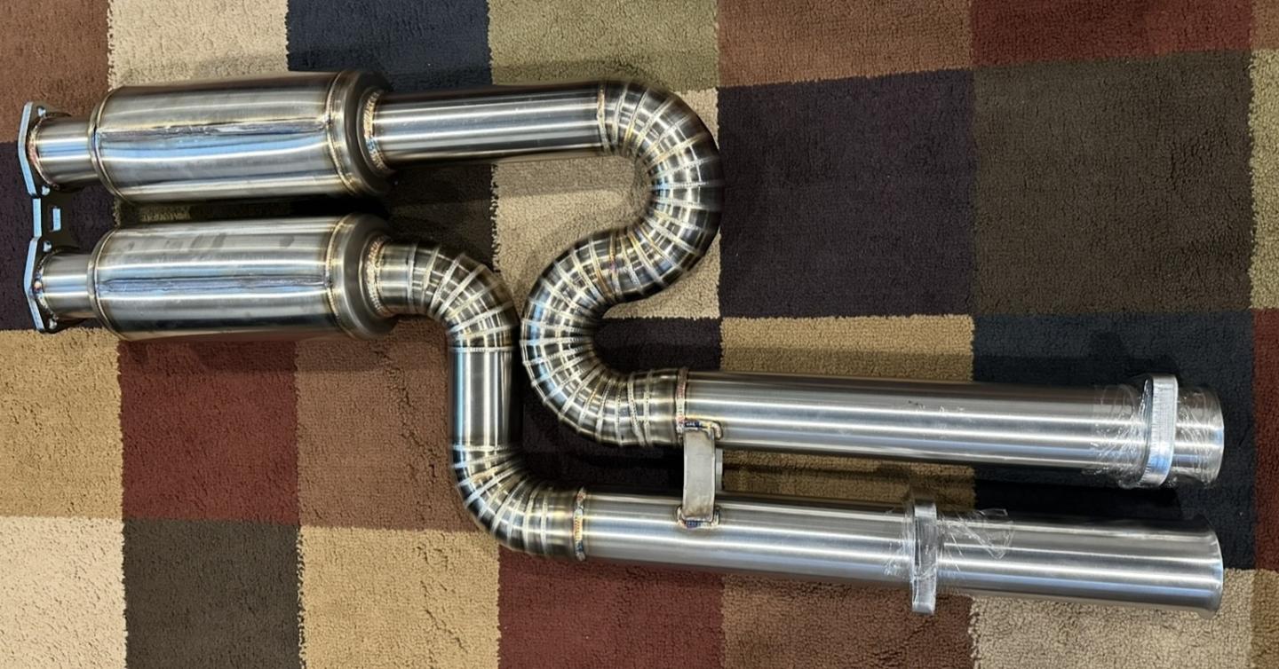

        Here you go guys.
        Before:
        Click image for larger version  Name:	IMG_5240.jpg Views:	0 Size:	187.4 KB ID:	321441
        After:
        Click image for larger version  Name:	IMG_5239.jpg Views:	0 Size:	163.7 KB ID:	321442
        I think this is the first modded 2.5” equal length section with cats and the slip fit to attach to Supersprint v1 stepped headers.

          Awesome! Did you do that? What cats?

              Yep, took a Rogue Engineering pipe, which is the only 2.5" equal length section 1 on the market (that I am aware of) and modified it. I added GESI (EPA rated) cats and the slip fit flange for the Supersprint V1 stepped headers. I went with GESI cats because 1) I got a good deal on them, and 2) they are 4" round diameter which was the same diameter of the original Rogue Engineering resonators that were on the equal length pipe.
              My exhaust setup will be:
              Supersprint v1 Stepped headers
              Rogue Engineering equal length Section 1 with cats
              Supersprint 2.5" dual pipe - resonated Section 2
              Miestershaft titanium muffler

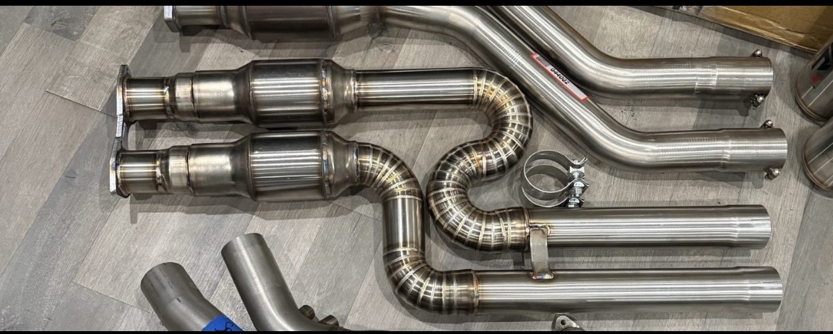

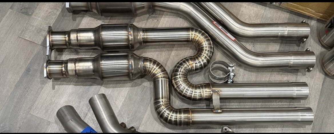

                  Click image for larger version  Name:	IMG_4585.jpg Views:	336 Size:	382.5 KB ID:	319624 Arrived Yesterday
                  Okay, I was able to get this installed today. I didn’t perform the installation myself as do don’t have the ability to get under the car like that. The shop I used had installed sections 1,2,3 for me last year.
                  They said install and fitment went on without trouble. It is 2.5” all the way.
                  The only thing that got in the way was a section of undercarriage cover ( BMW 51717892122​). Rather than trim it they removed it and gave it to me.
                  The most important part is the sound. I belong to the “no rasp” camp. My main goal is to make the exhaust sound clean and not distract from the carbon intake plenum. I want amplify what sounds good and that hasn’t been the exhaust.
                  Exhaust setup as today:
                  Megan Racing headers (cera coated and Flo coated)
                  Bomiz Equal length catted section 1 (2.5” piping)
                  Supersprint resonated x-pipe section 2
                  Supersprint Sport muffler
                  VERDICT- success! The exhaust sounds smoother and doesn’t have any rasp. It has a great tone and is plenty loud. There is zero drone at any rpm. Above 4k rpm the airbox takes over and sounds unlike any other car on the road.
                  While the cats on this Bomiz can’t be best, they are doing a pretty good job. I ran without cats last year the smell was significantly stronger.
