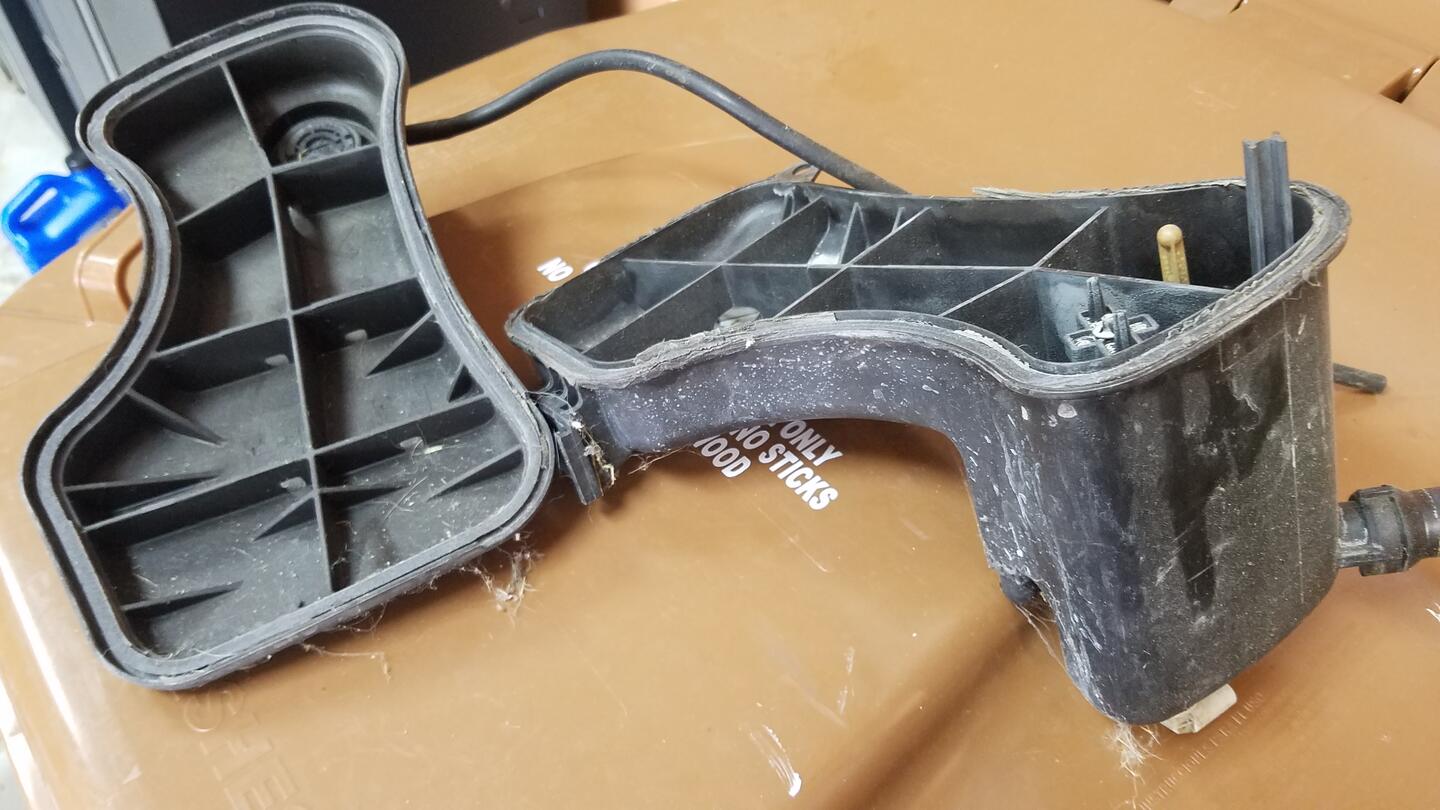

          Mine split. I just replaced it with another unit off ebay and kept the old one in case I wanted to fix it.
              Which tank split?

                  Which tank split?
                  The original bmw coolant overflow tank. After almost 200k hard miles I would take the chance on another one over the moroso.

                      #40
ID:	48897 It looks like bmw glued the two sides together and the glue failed. I'll probably throw it away but it looks like it could be easily repaired.
