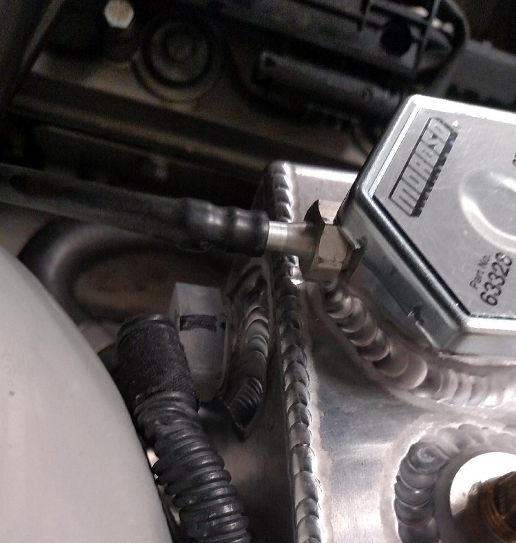

      Another update to try help make sure people don't make the same stupid mistake as me haha. I stupidly (well I guess not stupidly as there is precedent for the thought process) thought that because the Moroso sensor was plastic and the sensor bung was aluminium that this would directly seal as is... but after a few days I noticed small puddles of coolant below my car and saw a tiny leak at the bottom of the sensor... So I have pulled it out and re-made the joint with thread tape as is usually the standard for NPT fittings (although normally its to provide a soft seal so normally when you have a plastic thread it kinda does the job of thread tape)... Anyway I chose to use a rated Gas pipe PTFE tape as i like using things that have to meet a standard vs standard run of the mill thread tape... but i will see how it goes just to make sure it actually wasnt another issue... but I am 99.9% sure I just needed to seal the threads correctly so for those of you playing at home... thread tape!
        #48
        My Moroso coolant tank is in. Ran the car up to temp last night and the coolant level sensor leaked. STAATS reminded me to wind the coolant sensor threads 3-7 times with PTFE tape instead of the single loop I did. All fixed now with no leak.
