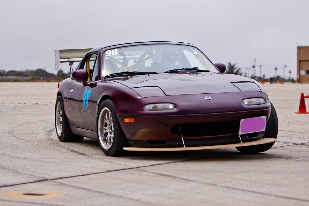

    I'm also selling our Fat Cat Motorsports prior flagship / demo car, 'Senna', a 1995 Miata M-Edition with ABS (rare and valuable!), Blackbird Fabworx 12-pt street cage, FCM Elite Stage 3 suspension (450/375, very streetable and still good for performance), lots of detail work to bump steer correction, ISC upper offset control arm bushings for up to -4.5 deg front camber, fenders rolled and tubbed (rear) to fit 275 Hoosiers (grip monster!). The dual-element rear wing from Ciro Design Racing is now included in the $7400 price.
    Senna was designed to be a streetable track car as I didn't have a tow vehicle and also wanted to enjoy him on the street. He has a catalytic converter and was intended to pass CA emissions while being nearly a fully-prepped track car). Asking $7400 firm. There are several PDFs on the website (linked in the CL ad) indicating all the work that's been done to him and how special he is as a track / autocross car.
    UPDATE on Senna: I've got him at Edge Motorworks and aiming to get him road-worthy so I can sell a runner instead of a 'bring a trailer.' Might turn out I won't want to sell him when he is running again, but if you or someone you know are interested, send them my way. If I can't sell him, I'll take him to 'Bama with me and turn him into a TTOD contender as before

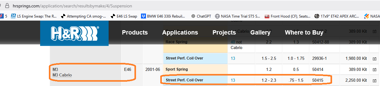

                  Along these lines...is everyone using the non-adjustable H&R coilovers from ECS?
                    ^that's what I'm using.
                      Dumb question - the H&R/Bilsteins work with 60mm straight coilover springs?
                        Just for my understanding, what is provided in the $2800?

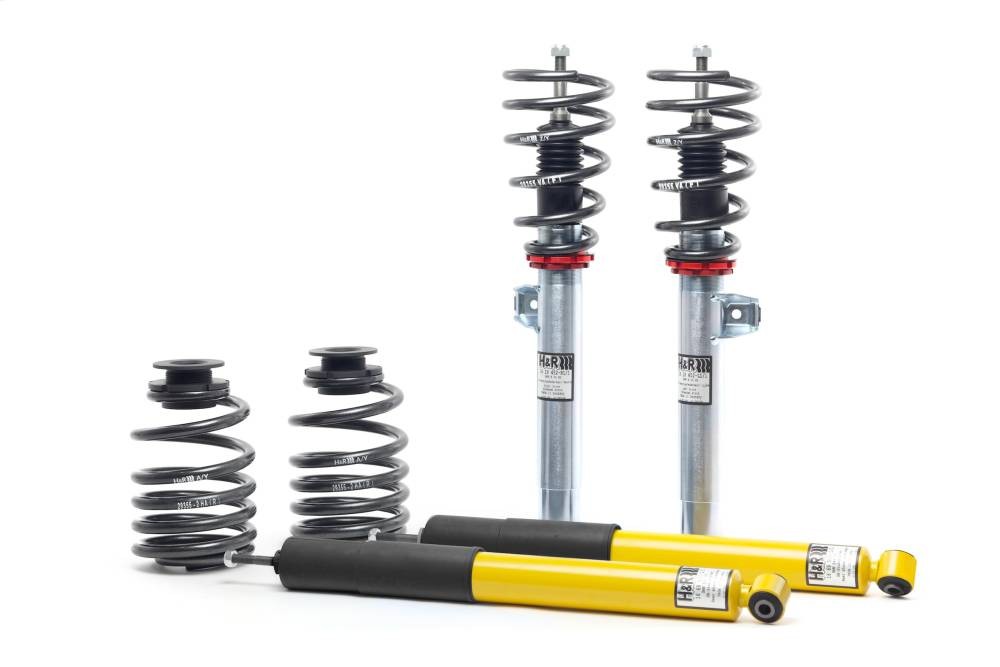

                        Good question. You're paying $2800 for me to optimize the H&R Street Performance coil-overs, p/n 50415 you'd have shipped to me (either new or very lightly-used). For now, you're paying for FCM Elite Stage 2 to get FCM Stage 3 Ultimate - at least until I end the deal, likely mid-September. The springs are unfortunately useless for anyone who cares about suspension travel or Flat Ride so I recycle those and we'll select new springs based on your driving needs and corner weights (Racer's Edge part of the E46 M3 Ride Harmonizer spreadsheet!).

                        I decided years ago that - in the dark - every damper looks about the same. So I couldn't justify charging a Porsche or BMW customer 3x what I'd charge a Miata customer for what amounts to the same work in optimizing the damper behavior. This generally makes Miata customers say things like 'but but it costs more than I paid for my car!!' and Porsche customers are 'ok, that's very reasonable especially compared to blah blah.' Most BMW owners I speak with are somewhere in-between, depending on what you paid for your car, how much you've spent on other items, whether you're aiming to race / HPDE / etc.
                        I want to ensure that by paying a lower price people do NOT think they're getting a lower-Quality product. I am convinced a lot of the prices being charged are just price gouging (no names specifically mentioned but you can guess). I've seen multiple dyno graphs that area nearly identical of the 3-letter popular controlling motion dampers across platforms that OUGHT TO BE very difficult, due to geometry / weight / spring rates. When you start peeking behind the curtain, you might not like what you see...
                        The $2800 is what you'd pay me to do the damper tuning (compression / rebound / modifications & hardware for Ripple Reducer and Ultimate). The cost of top mounts and springs are extra. I provide a softer front internal bump stop than H&R gives (I get it from Bilstein) and the rear bump stop (`60mm medium, or ~200 lb/in) is provided by H&R and is ok but I would recommend switching to the Speedthane 58mm red which is softer (~100 lb/in) and more progressive. It's available through various sources, but if you buy from 5XRacing.com I get a 10% commission on their sales since they're my wholesale dealer on bump stop products. I have a limited quantity in stock and won't be ordering more until I move so about the next 4-5 people will get rear bump stops included as well as the softer / shorter Bilstein front stops (always included).
                        I'll advise you on appropriate sway bar(s) { usually just a larger front bar than stock } and then the spherical rear weight jacker from Ground Control is what I suggest (Rogue makes a knock-off to my understanding).
                        Note that to service a damper is typically about an hour's work which is my consult / labor rate of $300 / hour. The initial high cost is to get all the technology and interaction with me to dial things in. In the rare event that a repair is needed (and it is very rare), it's 1 hour per damper plus likely a new rod guide (~$40). New AMSoil 5wt Shock Therapy oil is included.

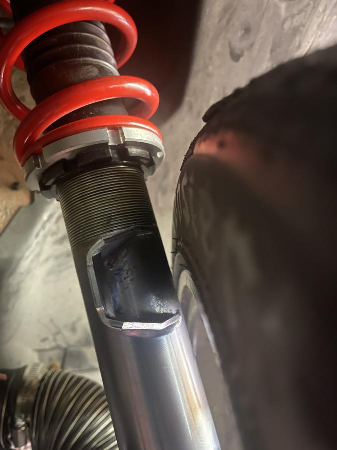

                          Not dumb at all - yes, they are usually designed for 60mm on the BMWs. Porsches can use 60mm or 70mm but BMW seems consistently 60mm.
                          The H&R front strut housing is designed for a 60mm spring perch. There's enough aluminum present to turn the front spring perches to fit 2.25 inch ID springs (57.3mm) which I've done for numerous customers. I do that here on my Clausing lathe.
                          The H&R rear height adjuster is set for 60mm but I really recommend an articulating spring perch which then you can use 2.25, 2.5, or 60mm if you want (I think). I prefer 2.5 inch to get the most spring travel in the rear suspension and avoid coil-bind. The weight savings in the rear of 2.25 vs. 2.5 inch ID is pretty minimal.
                          Up front where tire / wheel clearance is more of a concern I get going with 2.25 inch ID springs. Of note, on my E46 330i with non-M suspension components, I'm using 2.5 inch (63.5mm) springs on Bilstein PSS (I made a ring to space outward from 60mm to 63.5mm). I use a 10mm spacer to fit 285s BF Goodrich R1 or a standard 5mm spacer to fit my usual 255s Rival S.
                          Oh, and the H&Rs comes with a front and I'm pretty sure also rear dust boot. The front dust boots measure just under 57mm so should also barely fit a 2.25 inch spring.
