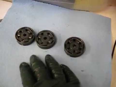

                              What is being done to the dampers to cost $2800 on top of the cost of the dampers, if spring rates, roll bars, and ride height stuff is already known and published on the forum?
                              Is it the "ripple reducer"? What actually is it?
                                When someone send dampers in to a suspension shop to be 'revalved', they expect the compression and rebound (and nitrogen pressure / gas force, which most racers / enthusiasts aren't aware of) to be tuned to their vehicle application.
                                Or, if they're buying a new coil-over package, they expect the damper forces to be 'valved' to 'match' the springs being provided in the setup. I put those terms in quotes because the vast majority of people do not know what proper or optimal damper forces are, or how to specify that. They rely on the suspension shop or the aftermarket coil-over vendor to provide a complete package where everything works together.
                                Except, it never does, and they don't provide advice on how to make it all work together as a package.
                                As a reminder in case there are some who have forgotten, I created the Ride Harmonizer spreadsheet years ago and shared information on Flat Ride, provided the means for E46 M3 enthusiasts / racers to set up spring rates and sway bars plus consider bump stop interactions in a more optimal way than simply 'use the same front springs on both sides' in the event that your left front (for example) weighs more than the right front. The BMW race setups used to be universally HORRIBLE front-biased / pitch-oriented. On the original M3 forum, the circa 2016 thread where people had switched from pitch-based (800/900 front/rear spring rates) to more Flat Ride-oriented setups and all the positive benefits was exceptionally useful. Many, many people began seeing Flat Ride as viable and beneficial for performance driving, let alone improved comfort, stability, and road-holding. I'm not sure how much information has been shared elsewhere, but I'm fairly sure many have benefited from the information I've freely shared, both here / on the original forum and via my Youtube channel.
                                If someone wants to work with me to create a fully integrated selection of spring rates & length, damper tuning, sway bar(s), and other variables, that is what you pay for when getting the FCM Elite Stage 2 damper optimization. I spend a significant amount of time with each customer to understand what you have, what your goals are, and what we need to buy or adjust in order to achieve your goals.
                                In the beginning I would offer an FCM Elite 'revalve' before I understood the 3 Keys of Ride Harmony and mandated Flat Ride above all other considerations. That was setting compression damping based on the specific vehicle weight (why I require corner weights), then rebound forces to create the overall settling response desired (smoothness vs. sharper / fast settling), then minimizing gas force while preventing cavitation. That would have been considered the FCM Elite Stage 1.
                                With my discovery of the high-frequency modification being done in the off-road circles (via drilled holes in shock pistons), I tested then introduced the 'Ripple Reducer.' That is what makes the FCM Elite Stage 2, and that is my entry-level service which itself is superior to every damper I've ever examined or seen data on. In particular, because my process involves getting data about your specific car and your usage, everything is built-to-order.
                                If you get a suit tailored, it's going to cost more than picking it up off the rack. I've set my pricing to a level that I'm comfortable with given the amount of goodwill I've put into the enthusiast community and to reflect the value of having a suspension vendor who cares about how each components in your suspension will work together vs. selling you a random part or an entire catalog.
                                Videos on Ripple Reducer here:
                                and some further explanation and graphs on my blog, 'The Perfect Ride', here:
                                As I have also indicated, I normally charge a minimum 30 min ($150) consultation when going over all these details with a customer. For this community during the Summer Special offer, I'm waiving that consultation fee. As most who've actually taken the time to pick up the phone and speak with me know, conversations often go well over an hour. It matters to me that a potential customer understand the unique advantages of the Ride Harmony / Race Synergy approach, whether for street comfort, racing, or anything in-between.
