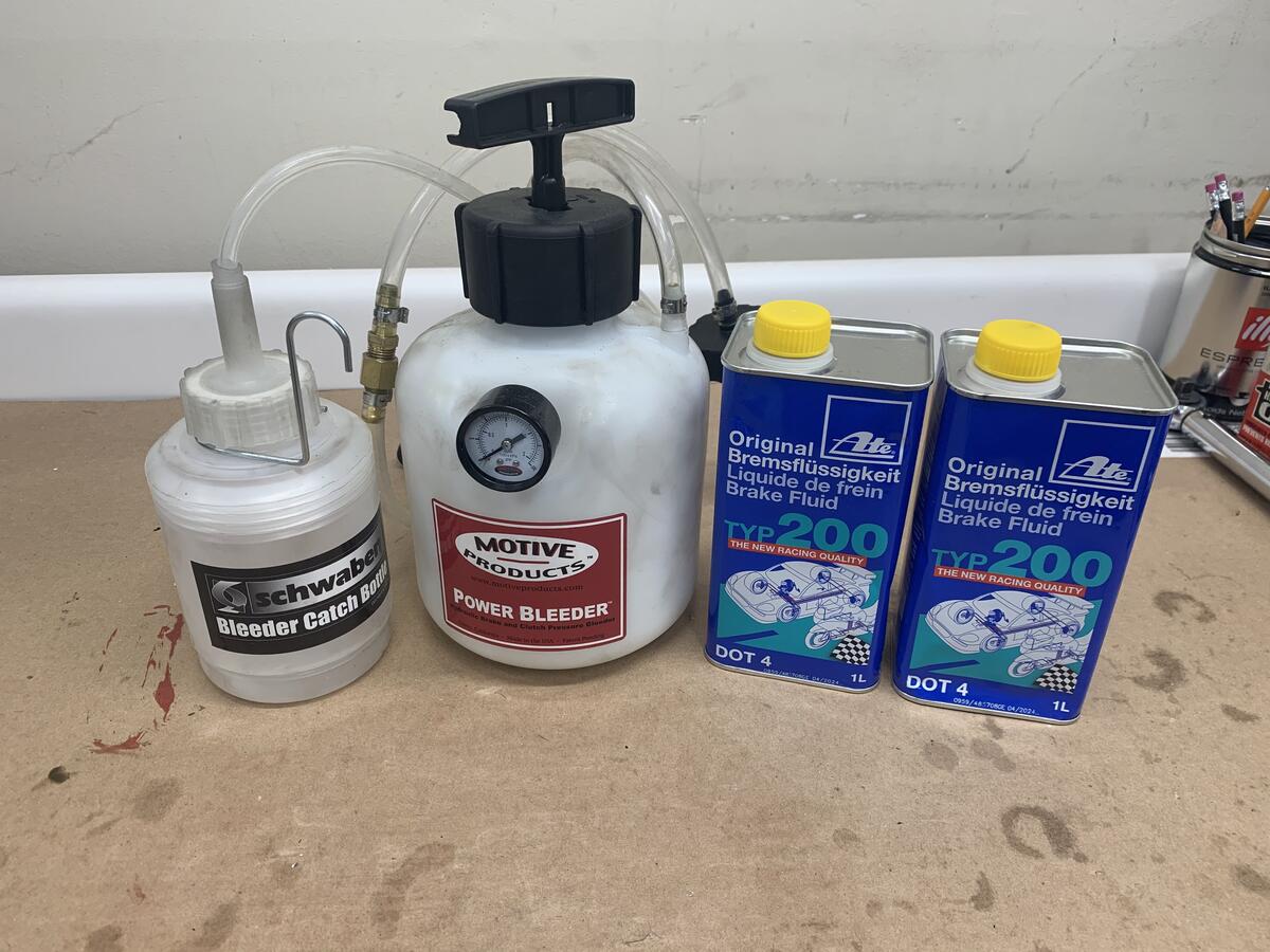

                                Tools..
                                Make sure you have an 11mm line wrench. The metric set I bought way back when did not include an 11mm.
                                I would definitely recommend a power bleeder. I got the Motive Kit from ECS and it made bleeding the system a breeze.
