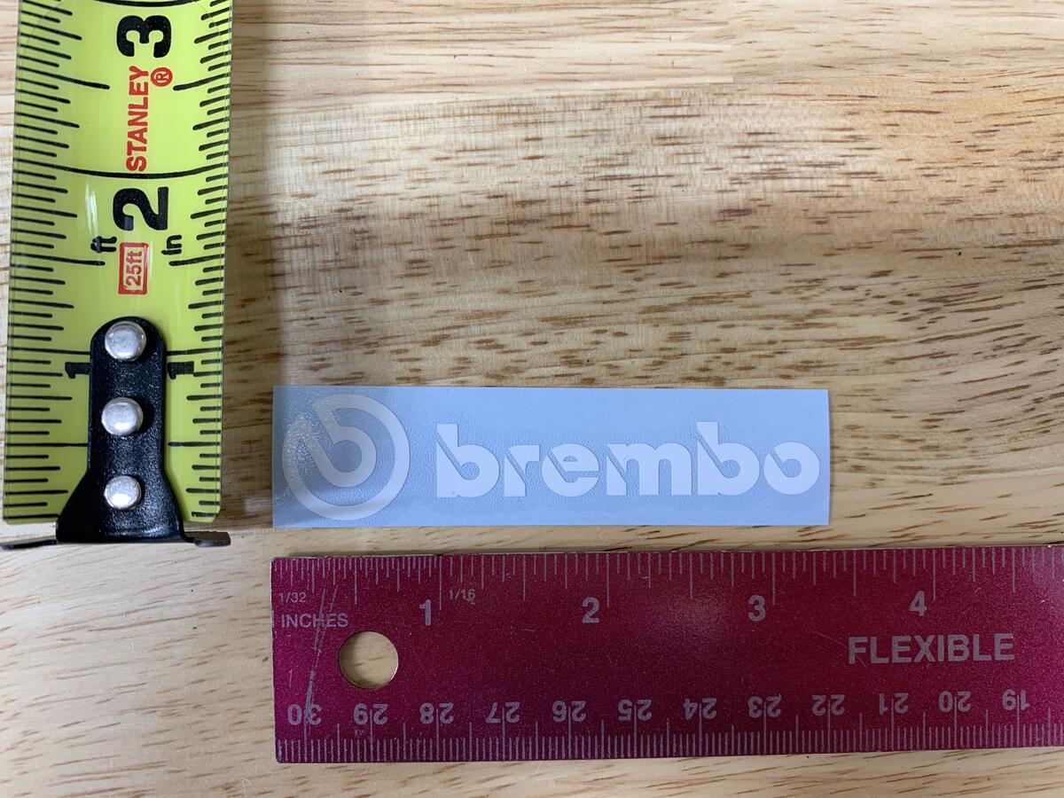

                  Here is the set of Brembo decals I went with. There are several different sizes to choose from.

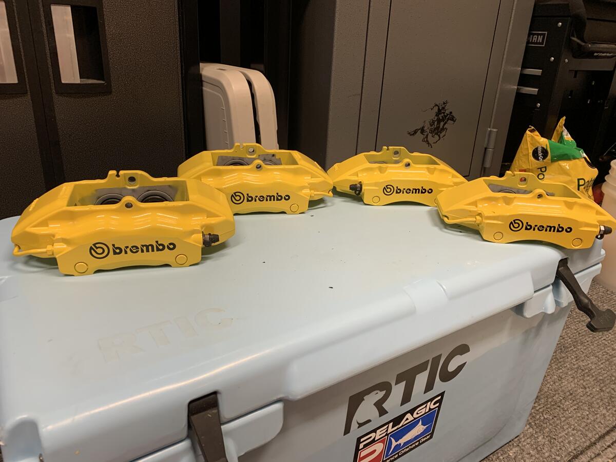

                    I installed my 996 setup today. I needed to grind the knuckle for the Rallly Road front brackets to fit, otherwise it was a smooth install. I used the stoptech seals, VHT 900 degree paint and ferodo ds2500 pads. Ignore my wonky masking tape lines on the inside of the caliperClick image for larger version  Name:	IMG_1246.jpeg Views:	0 Size:	265.8 KB ID:	32956 Click image for larger version  Name:	IMG_1216.jpeg Views:	0 Size:	110.0 KB ID:	32955
                      I'm considering to upgrade to Ferodo DS2500 pads (from Textar) as well, but wasn't sure if they'll squeal. How do you find the stopping power and fitment with these pads? Are FRP3051H and FCP1307H the correct part number?

                        Looks great Scotty....👍

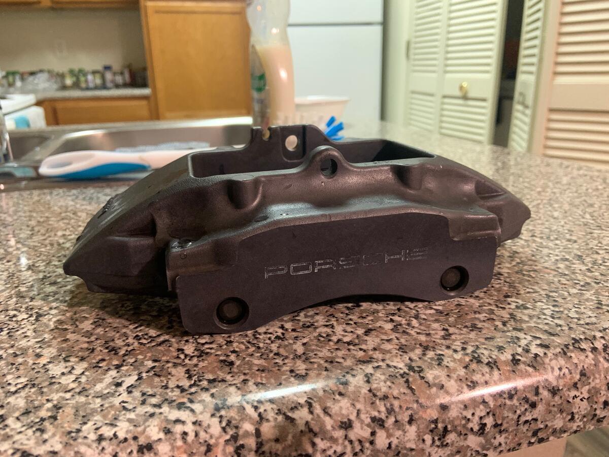

                              What a great thread, it has all the right information, in fact, I wish I found it before buying some parts. I am in the process of doing the BBK conversion on my Z4M, but in my case, I will go with the front 135i 6-Pot Brembos. It may be a couple of weeks before I get them ready to install as I am waiting on parts.

                              Since I have the front yellow Performance version, I am planning on just sanding the Porsche coating, apply Phoenix yellow paint from an ExpressPaint can, and use VHT calliper clear. Since I don't track the car I think I will be ok. Any comments on this plan are welcome.
                                Sounds like a good plan, though I'm not a fan of the 135i calipers really, but if the z4 can't do 996 fronts, then it makes more sense. I'd still opt for stoptech if you're trying to save $ over AP/brembo.
                                As far as paint, should be fine. My advice is to do only 2 light coats of the vht caliper clear so it doesn't kill all the good sparkle of the PY paint, and then, ofc, bake them.
