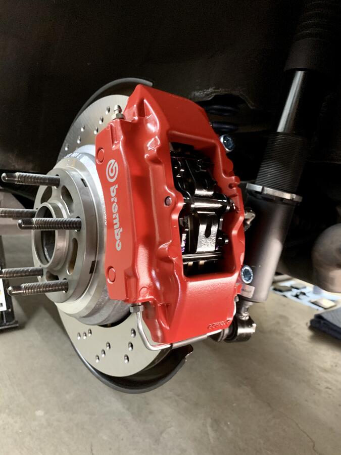

      Does anyone have a suggestion on cap screws (bolts) alternatives that secure the rear calipers to the brackets? I'm looking for ones that won't rust quite as easily.
      I did this about 2 years ago (killer brakes!!!) but the black oxide cap screws that came with the Rally Road kit are rusting badly. This car never sees snow and rarely rain, so this is car washes mostly that has caused this. I'm not sure if these are grade 10.9 or 12.9 - this is 4 bolts that I don't want to incorrectly spec a replacement.
      These are M12 x 1.75mm x 65mm.

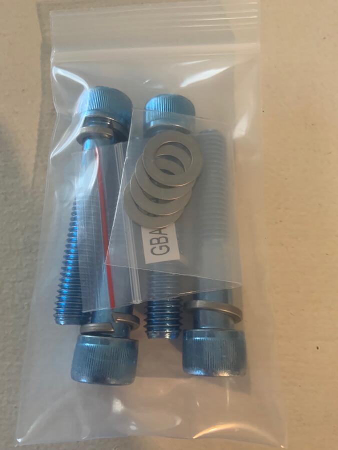

                Just took a look at my rally road bolts .. they are indeed the blue tinged zinc ones.

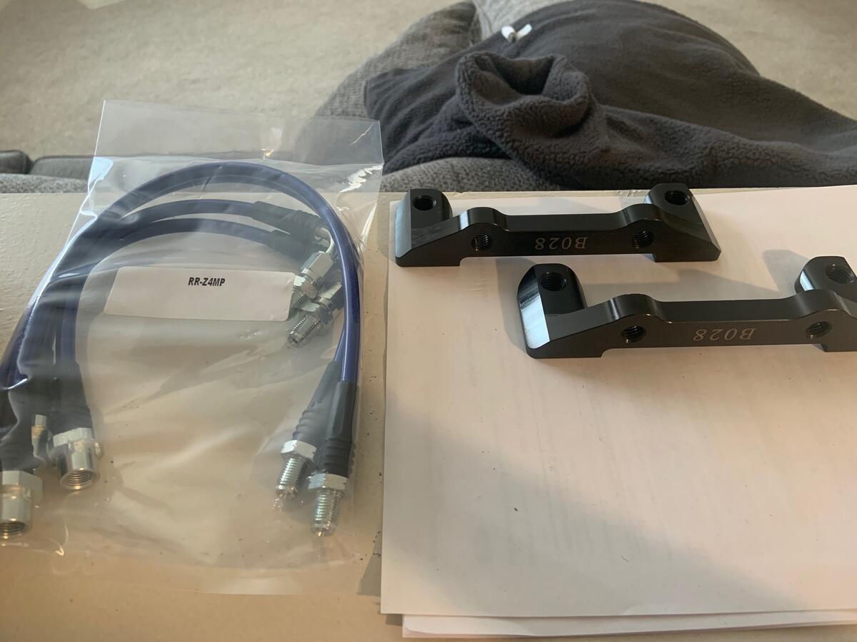

                    Today I collected my RR kit (brackets, fasteners, and lines) for the Z4M, and the fasteners are zinc plated, 12.9 class.

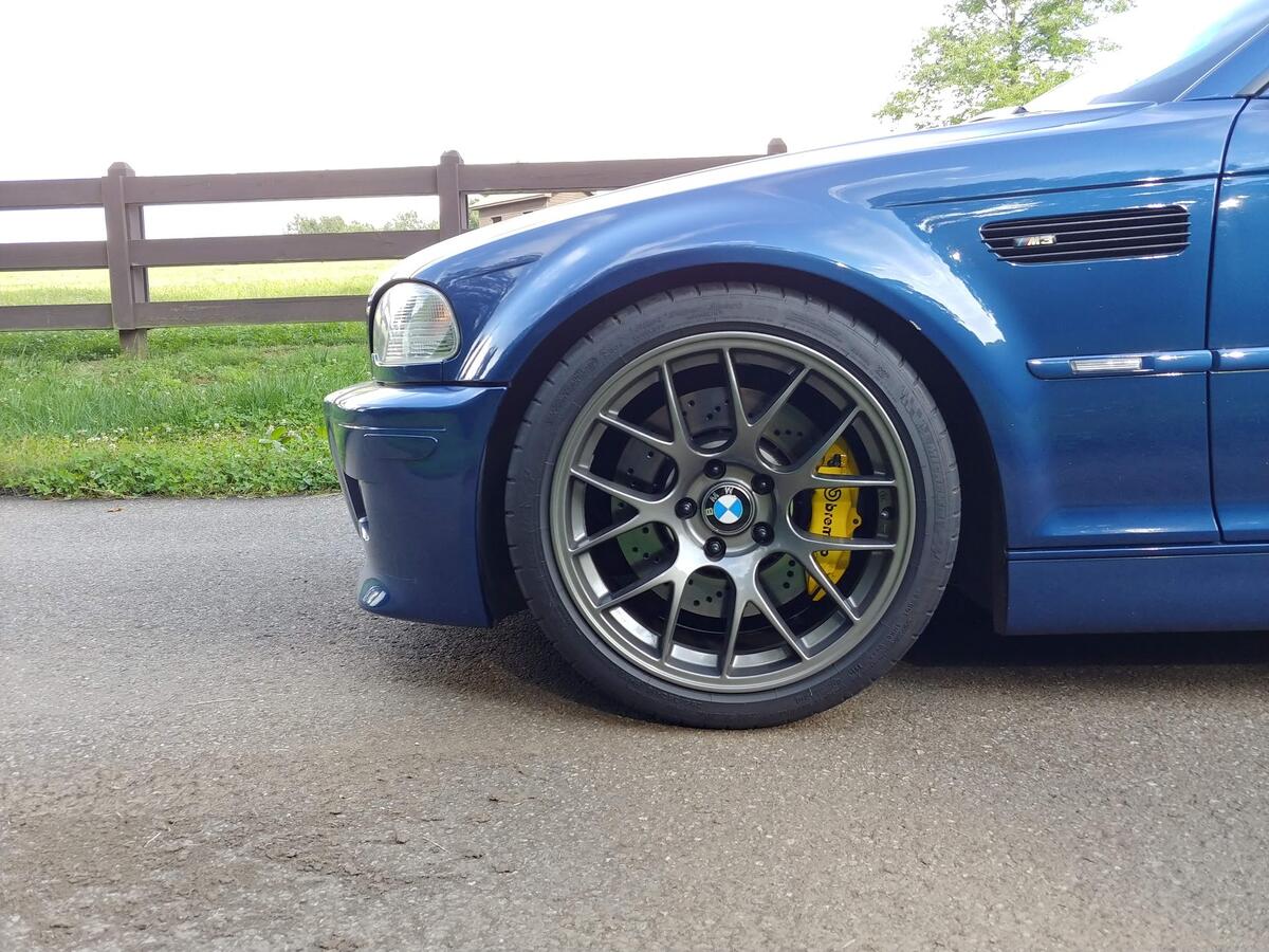

                        Possibly changed bolts. One thing I absolutely did not think about is if this set up will work on 18" rims. I 90% it will but can someone measure the distance between their rim and caliper just so I know.... CSL wheels are great and all but I do like the way 18's drive much better.
                        I have APEX EC-7 wheels in 18" and there is PLENTY of room with this setup (CSL/Competition rotors front and rear).

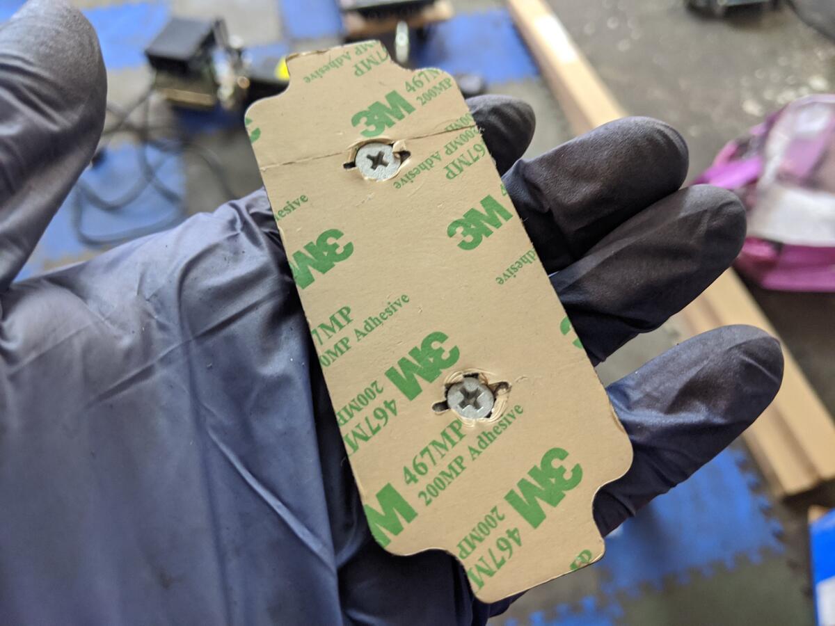

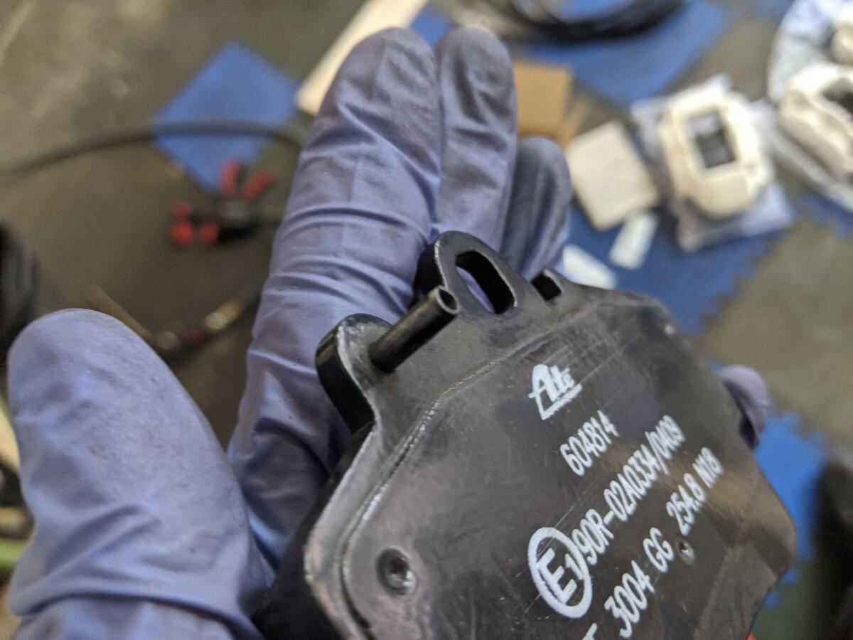

                              anyone using the front dampers? do you leave them as they are for easier reuse or do you adhere them to the brake pads?
                              and by the way my rear pads (front porsche) from ate arrived with a pin that i had to remove.

                                I didn't reuse the dampers.
