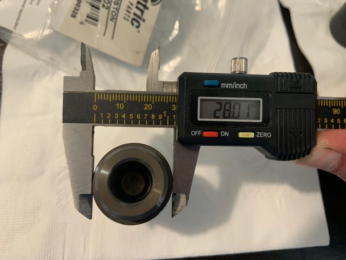

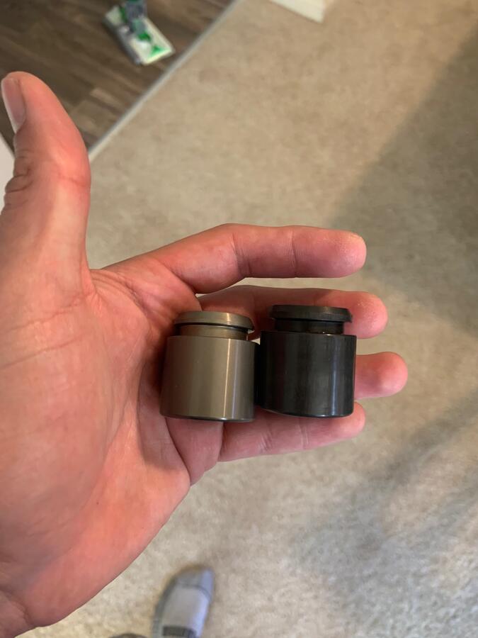

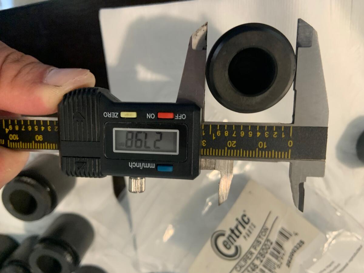

      Hi, I just received the new centric pistons for the rebuild of my rear 996 brembos and I wanted to share a few images I took to compare them. I took some measurements and they are pretty close, the new pistons are 0.02mm bigger, I wonder if this is just down to tear and wear. I used centric as I could not find original brembos in the US, plus the centric items are cost-effective. Does anyone have experience with these? I hope they are of good quality. I also used their seals.
      BTW; I don't track the car, it is just my weekend toy and I cannot say I drive it aggresively as the public roads here are very busy and there are very few B-roads.
      OE (Dark) vs Centric

      The next two photos show the measurements of the 28mm pistons
      OE
      Centric

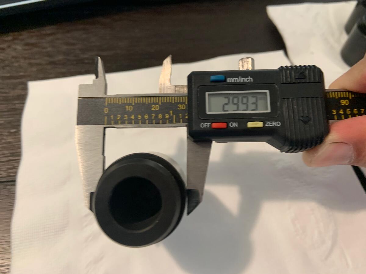

      These are the 30mm
      OE
      Centric

        In my experience, the stoptech (centric owned) seals are slightly looser than OE brembo, so their pistons also being slightly larger should be fine. You're also talking about hundredths of a millimeter.
        A trick I tried once was when I had one seal feel too tight, I moved it over to a bore where the fit was a little too loose, then moved that looser seal back over to the first bore where things were too tight. Both then were snug.
        I would highly suggest using proper install lube rather than brake fluid - it provides much more lubricity and makes it easier to push the pistons past the new seals. If you bought the new seals off ebay (Ohiomotorsports), then it comes with proper lube.
                Hi, I did not source my seals from them but went with the centric kit from FCP Euro. I wonder if they will bring some lube with them. if not, is this something I can source from the typical auto parts stores (Autozone, etc)?
                  I used the centric seal kits and several centric pistons when I did my conversion. No issues or problems. As Tyler pointed out, you are talking about a difference of hundredths of a millimeter.
                  If all else fails you can order the proper lube from https://www.zeckhausen.com/ - it does make assembly much easier.

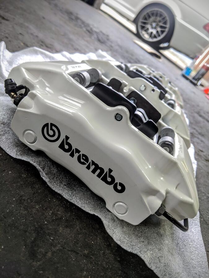

                    This project is finally coming together for me, and I am finishing up the paint on 2 remaining calipers. However, my parts ordering debacle is apparently not over. First I received 2 crossover lines that were different part numbers, but the same part. Then, I tore one of the rear dust boots so I ordered a new seal kit for the rear calipers from Amazon. I received it today and only got 1 seal. So for those of you looking to buy parts for this, do not order the seal kits from Amazon. Not really a "caliper kit" as the description suggests.

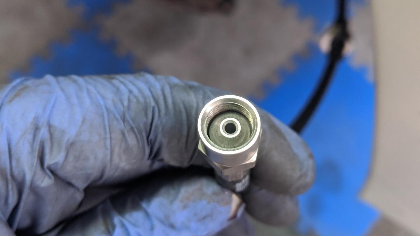

                      is this the right line? the bmw lines have a nice groove where the end from the car goes in. this line looks like the same that comes from the car. it screws together but i want to get sure before i'm bleeding the car.

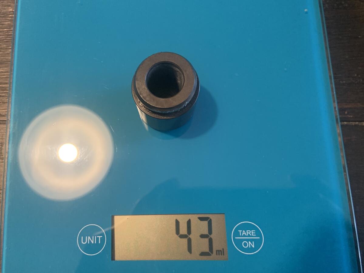

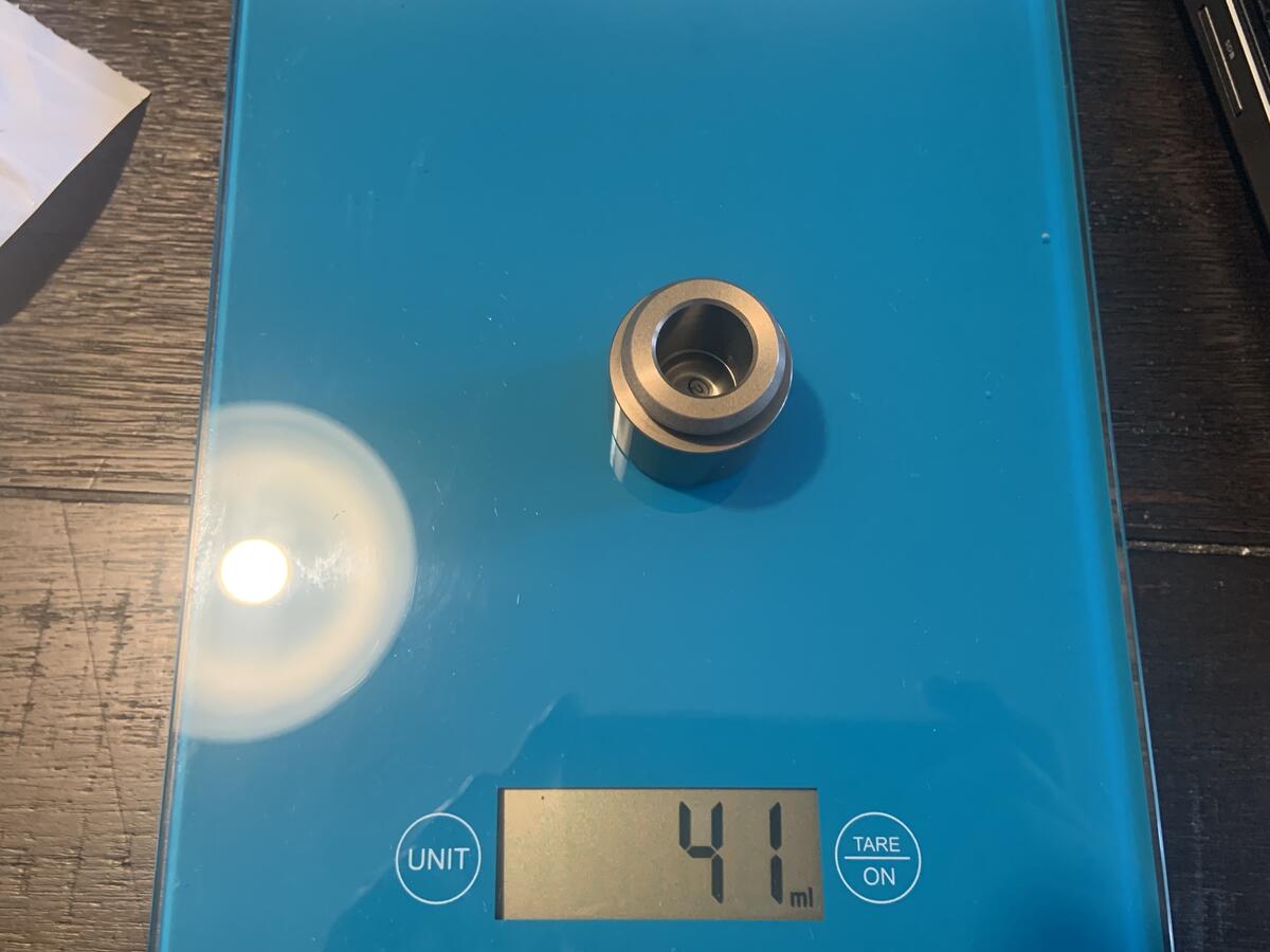

                        I weighted the pistons and there are only 2grams of weight difference, the OE ones are a tad "heavier"
                        OE
                        Centric
                          Saving unsprung weight!!

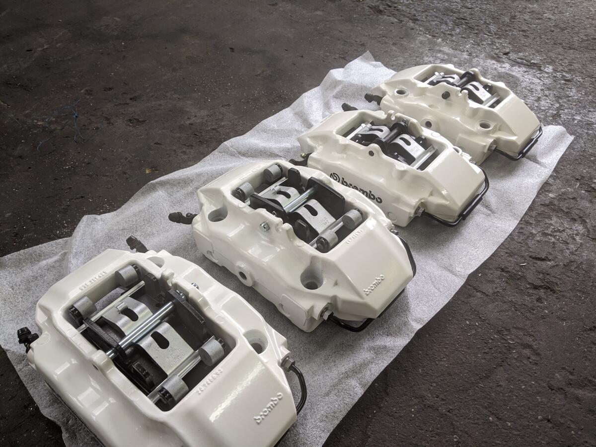

                            to answer my own question... yes it's the right line. it fits concave and convex lines. thanks tbonem3 and everyone else for contributing to this thread. i also used xpme46m3's thread that helped me source all parts i needed from rockauto. yes it was cheaper to order them from the US
                            i had to modify some things. my brackets are from epytec. i had to grind down a bit on the front to fit the brackets and i had to shorten the bolts. on the rear i had to shorten the pins where the pads are sitting. only the two that are on the outside on both calipers. oh and i had one stripped brake disc bolt on the front and i had to redo the brake line on the left rear. other than that, i'm happy that this project is finished. from sourcing calipers to today took a few months. 😅
                                here are some pictures
                                Wow, those look spectacular! Makes me want to get an Alpine White M3. Congrats on the final product! Really looks amazing.
