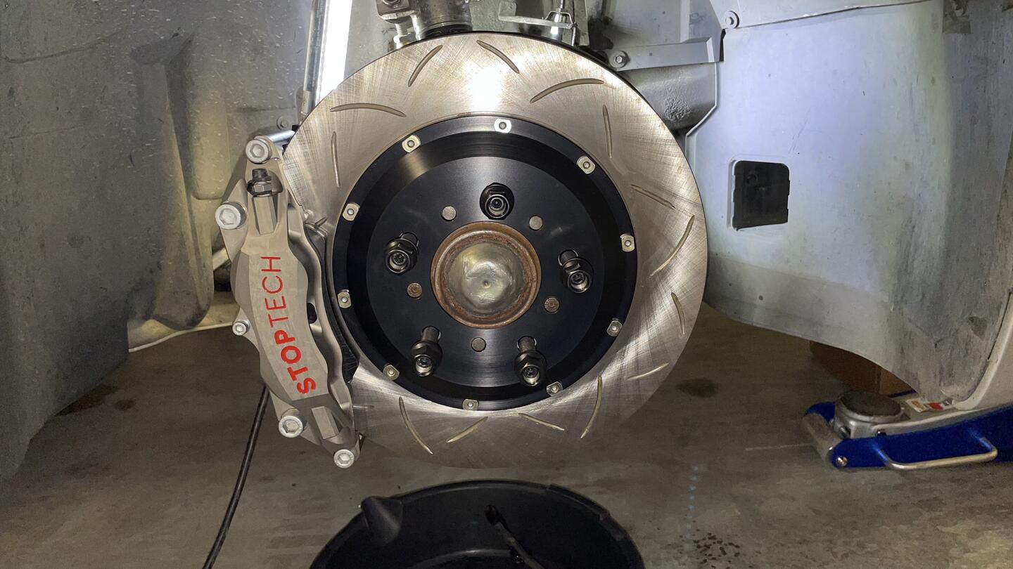

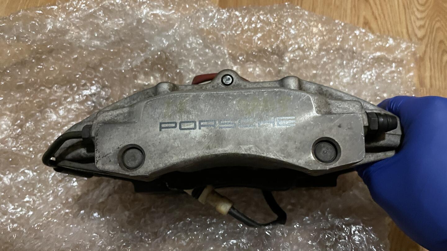

                    Rear calipers with allegedly 40k miles arrived. Dust boots look good. Gonna test the seals soon. The original plan was to just slap the calipers on, but given the meh condition, I’m gonna spend $30 to do a DIY refinish. Will be trying to somewhat match the StopTech fronts, so I’ll be using VHT engine enamel Nu-Cast Iron, red Brembo stickers, and engine enamel clear. Would prefer a matte clear but VHT doesn’t offer one.

                      Can't wait to see how those turn out.
