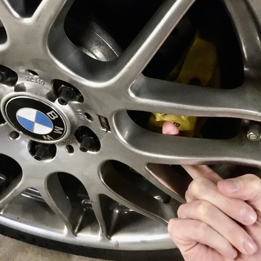

The issue of front clearance keeps coming up, and for whatever reason people seem to need WAY bigger (like 18mm) spacers to achieve clearance.
See my (filthy) current front setup: OEM ZCP wheels + 996 calipers, RR bracket, 12mm spacer
There is a good finger's worth of clearance - probably like 15mm.
Again, these are my experiences - don't know if there are any physical differences between cars (shouldn't be), but felt the need to post this as I could probably get away with a 5mm spacer and have enough clearance to run these calipers and wheels.
996 Brembo hub face to caliper outer face measurements:
Front: 35.5mm
Rear: 17.9mm
Last edited by mainstreamer00; 04-08-2020, 01:50 PM.TiAG 6mt Coupe | KARBONIUS | SUPERSPRINT | FIKSE WHEELS | OEM CSL | MILE END COMPOSITES | AST 5200 | HOTCHKIS | BREMBO | RECARO | BEISAN | CATCAMS | CP-CARILLO | TMS | RTD | ROGUE ENGINEERING | AKG MOTORSPORT | HTE PERFORMANCE
Yes. csl wheels or zcp though? Fronts are different. Rears are no issue either way (no spacers needed).Originally posted by bassel_sy View Post
I'm running the zcp/csl wheels ,10mm rear, 12mm front w/ 75mm race studs , u think ill clear tyler?DD: /// 2011.5 Jerez/bamboo E90 M3 · DCT · Slicktop · Instagram
