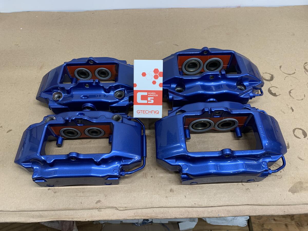

    After I got my calipers back from the paint shop I decided to go ahead and apply ceramic paint protection. After all this work, and the cost of having them painted, I figured it would be worth it to help keep them looking good. I don't have any previous experience with this stuff, so I relied on Obsessed Garage. He recommends the GTechniq C5 Wheel Armor, which GTechniq markets for calipers as well. It was pretty easy to apply. We'll see how well it works.

      Pretty blue! What color car and wheels?
        #33
        Thanks. SilberGrau and silver. I was afraid I would regret not going with yellow, but once I got them back I was happy with my choice.

          * I'm seeing a lot of people (or the shop who does it for them) paint the 4 pad pins on the caliper. The metal backing plate of the brake pad rides on those pins (pressure is applied downwards by the spring clip). I'm not saying it's the end of the world, the paint will probably just get chewed off, but those pins are meant to be bare metal. I even lube them and the pad plate edge w/ high temp ceramic paste because it's metal to metal and there's movement (not much tbf)

              Yeah, I wondered about paint on the pins, but they had plenty of red on them when I bought the calipers, so I figured it would not cause a problem. We shall see.
              The color is BMW Estoril Blue II Metallic (code B45). It is very close to the color BMW is currently using on their sport calipers.

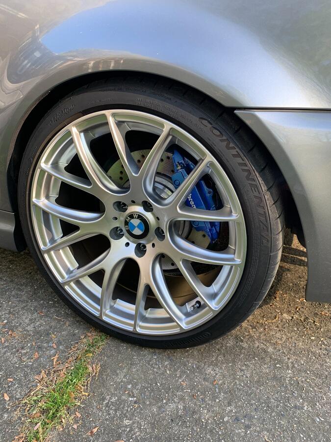

                          Here are a couple of shots of the calipers installed. They blue does not pop the way yellow does, but I am happy with it.

                          Old, not obsolete.

                            Looks really good!

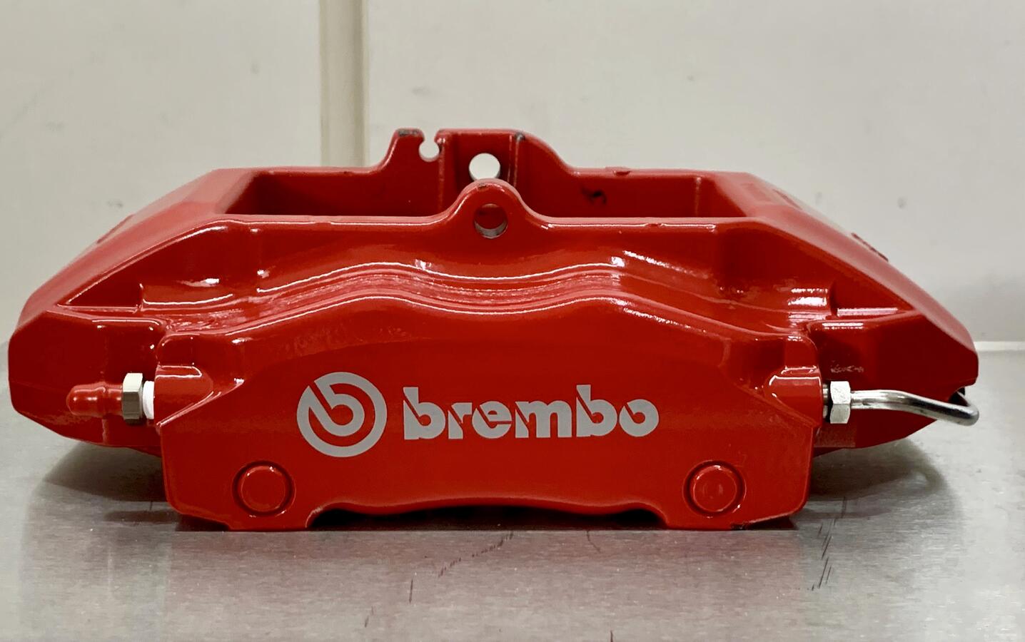

                              I had asked in the old thread whether it’s possible to keep the factory red paint but remove “Porsche” and replace with decals. Just tried today and the answer is yes — wet sand by hand with 1000 or 2000 grit and you will have the Porsche logo removed within 15 seconds. It’s under or inside the clear coat somehow so you’ll take that off as well and haze the paint. I’m currently waiting for a couple spots that I touched up with VHT red to dry and will clear the front tomorrow to see if the haziness goes away. Click image for larger version

                                Looks Good! I ended up using Q-tips and gasoline to remove mine. It was not fun getting them off but it didn't mess up the paint just faded the clear. Used VHT clear and applied one coat first then applied the Brembo decal.
