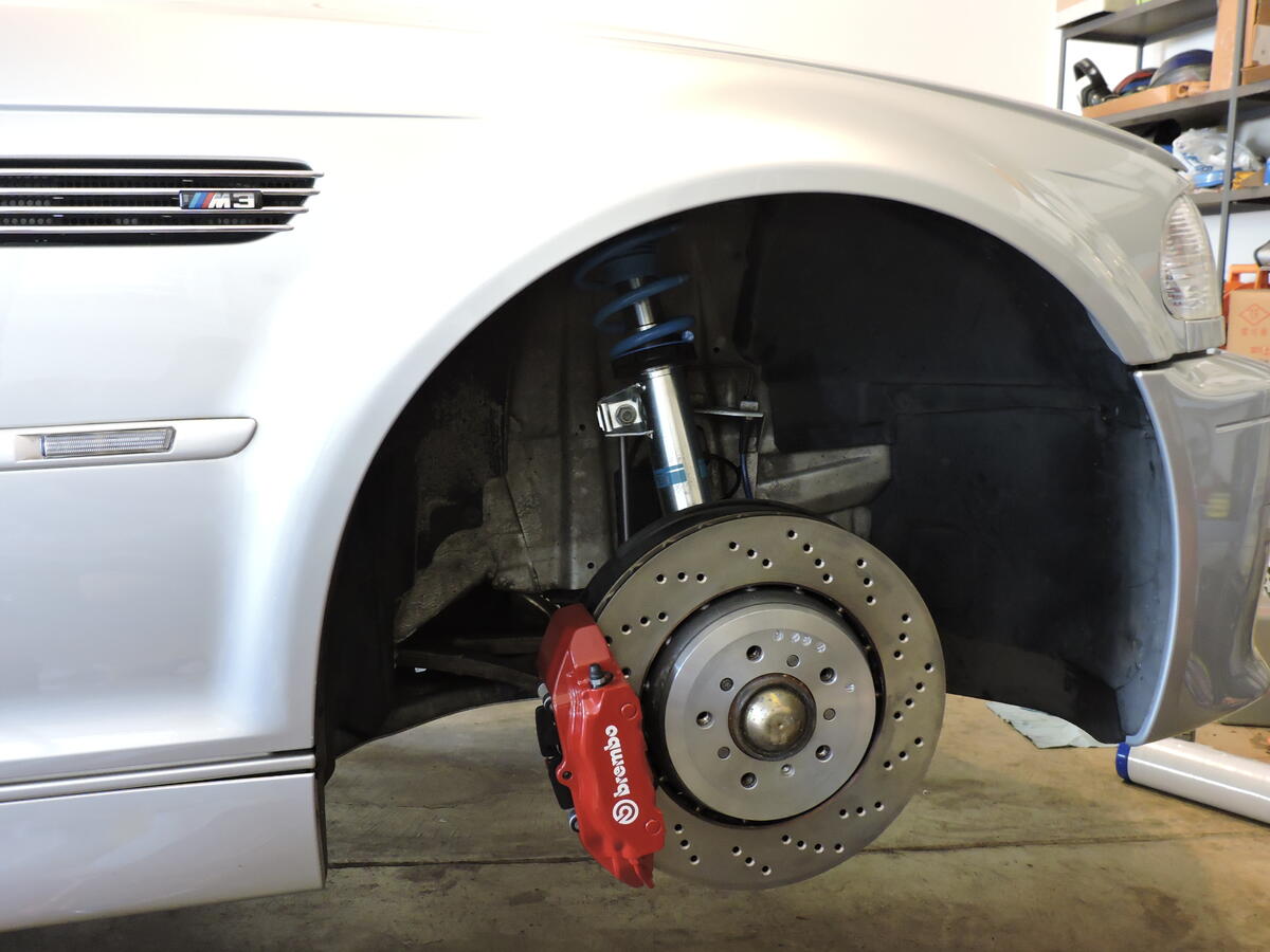

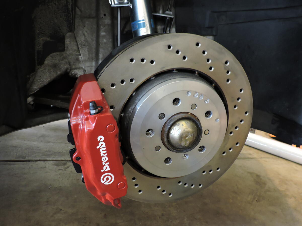

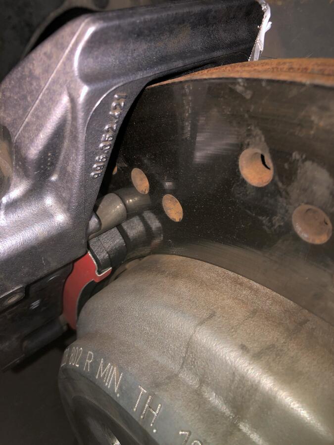

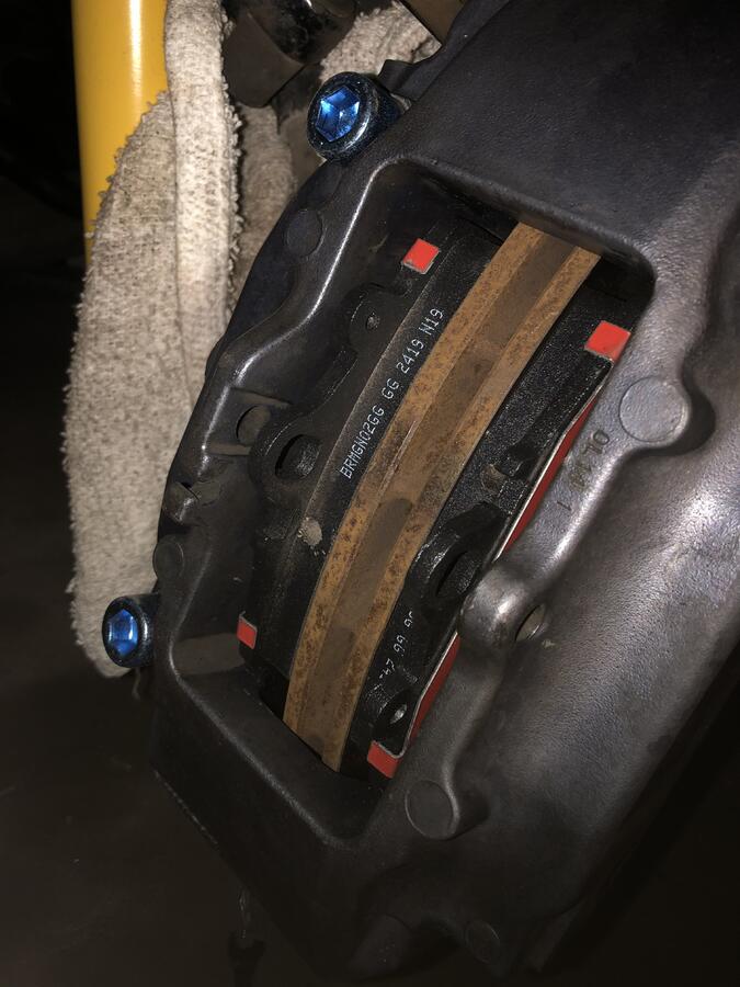

      Today I just fit test the Brembos as I wanted to confirm I won't lose any swept area. I am happy to confirm it uses almost 100% of the rotor, I think there is like 0.5mm towards the inner radii that the pad does not cover. BTW, the OE setup does use the whole rotor at the rear. BTW, I confirm those are 2.7L Front pads

        Wow that guide pin sure is close to the rotor!
        Evolve Eventuri
          it is, in fact, there was contact (not enough to actually bind the rotor), I posted more images in the installation thread. I need 1.6mm spacer to center the calliper. This will be addressed for the final assembly.

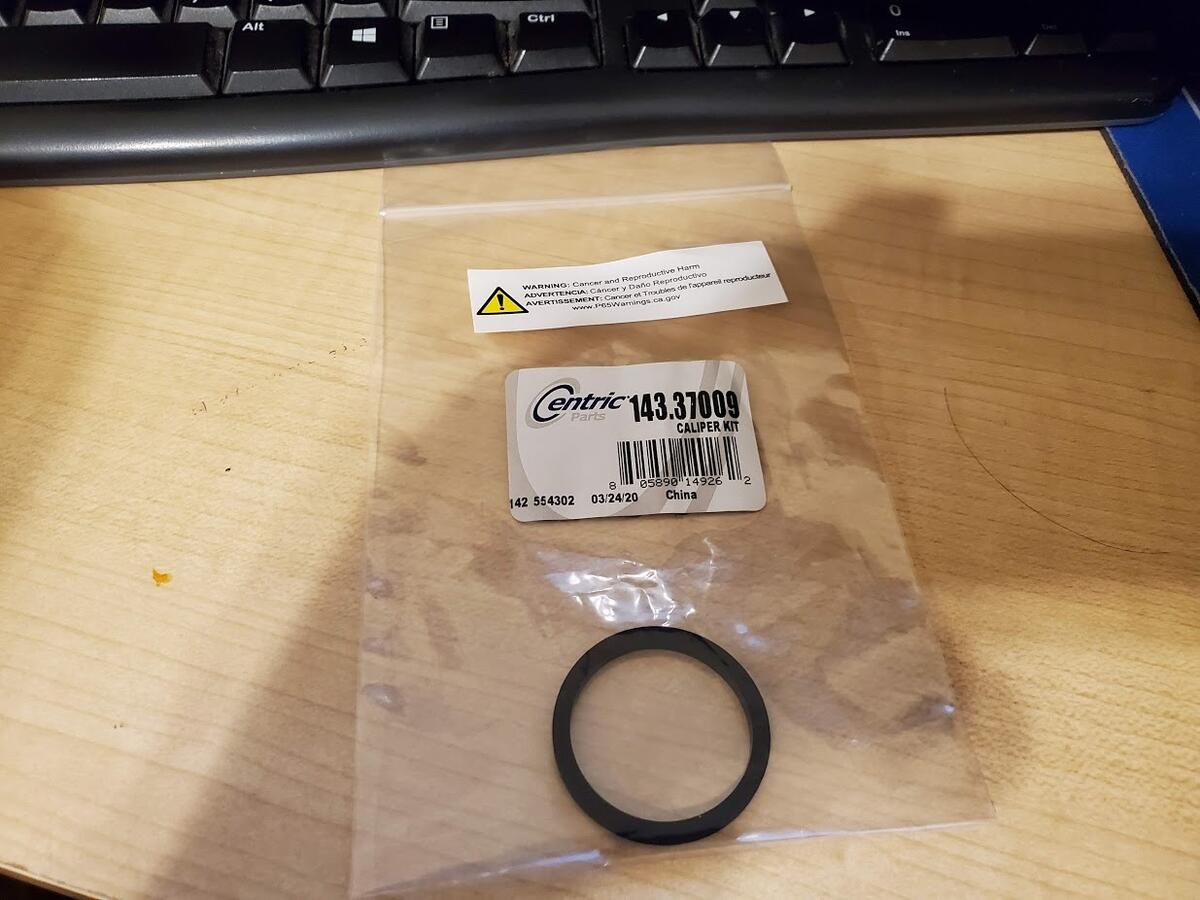

            This project is finally coming together for me, and I am finishing up the paint on 2 remaining calipers. However, my parts ordering debacle is apparently not over. First I received 2 crossover lines that were different part numbers, but the same part. Then, I tore one of the rear dust boots so I ordered a new seal kit for the rear calipers from Amazon. I received it today and only got 1 seal. So for those of you looking to buy parts for this, do not order the seal kits from Amazon. Not really a "caliper kit" as the description suggests.

            I had the exact same thing occur from rockauto. The bag had the right part number, but one one seal instead of the whole rebuild kit.

                  Thanks for noting this! Any chance you could provide some more details/pictures on where exactly the washers go? Also, what size/type washers you used?
                  Hi! Yes. I will post some more photos tomorrow
                      The washers are 20OD 11ID and 0.8mm thick. I posted a photo on the DIY install thread.

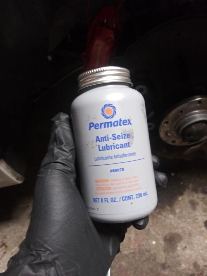

                        Something I would suggest is some antiseize on the places these DISSIMILAR metals are touching. The alignment pins, the screws, and the center hube. Be VERY conservative with the amount used so nothing gets flung. Dirt will also collect wherever exposed.
                        Click image for larger version  Name:	20200627_114212.jpg Views:	0 Size:	38.3 KB ID:	38236
                        DO NOT use on exposed surface, only contact points, where dissimilar metals touch. Since caliper brackets are aluminum, I'm putting it on the surface of the steering knuckle it bolts to. It looks anodized so it probably won't react there. I'm just doing it for safe measure.
                        Click image for larger version  Name:	20200627_115416.jpg Views:	0 Size:	50.8 KB ID:	38237
                        DO NOT use this on bracket bolts or caliper bolts or threads. This could cause those to loosen. It's highly unlikely but don't become that one person it happens to. Small rotor bolts are ok.
                        The reason to do this:
                        Aluminum and steel react with each other slowly over time quite severely. A good example is a transmission bolt. Our engines are iron so the corrosion is much less but non-M guy have a heck of a time with this. There's a metal reaction chart. I believe aluminum and steel are far apart meaning the have more reaction.
                        Good luck with the swaps everyone!

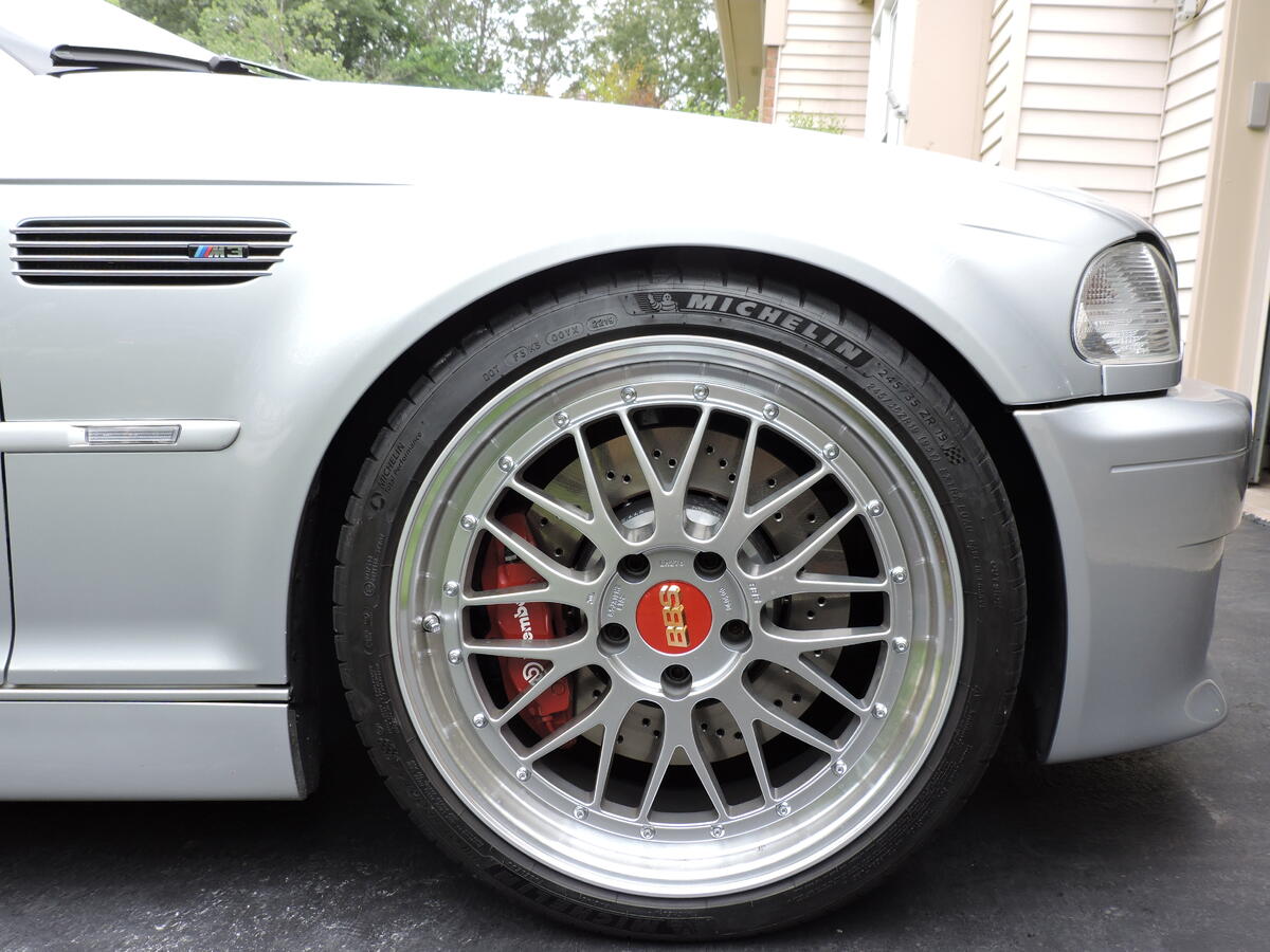

                            Finished up my front 996 conversion this morning. Will do the rears next weekend. Thanks to Tbonem3 and all those who contributed to this thread, the conversion went (almost) flawlessly.

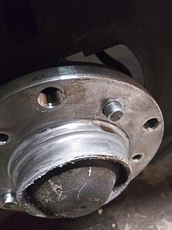

                            • Two of my rotor set screws were rounded out. The previous tech who did my front brakes reused them, despite the hex head being rounded off. I could not get them off, with a hex or Torx bit. I think this is a pretty common problem on BMWs. I tried using a Dremel to cut a slit in the top of the screws, then using a screwdriver to get them out, but this did not work. If you encounter this situation, grab a drill, use a bit about 75% the size of the head of the set screw- and drill into the hex head until you hit the rotor. The head of the set screw should pop off easily, and I was able to get the rotor off. The threaded portion that remains of the set screw should come out of the hub easily with vice grips, since there is no more tension holding them on.

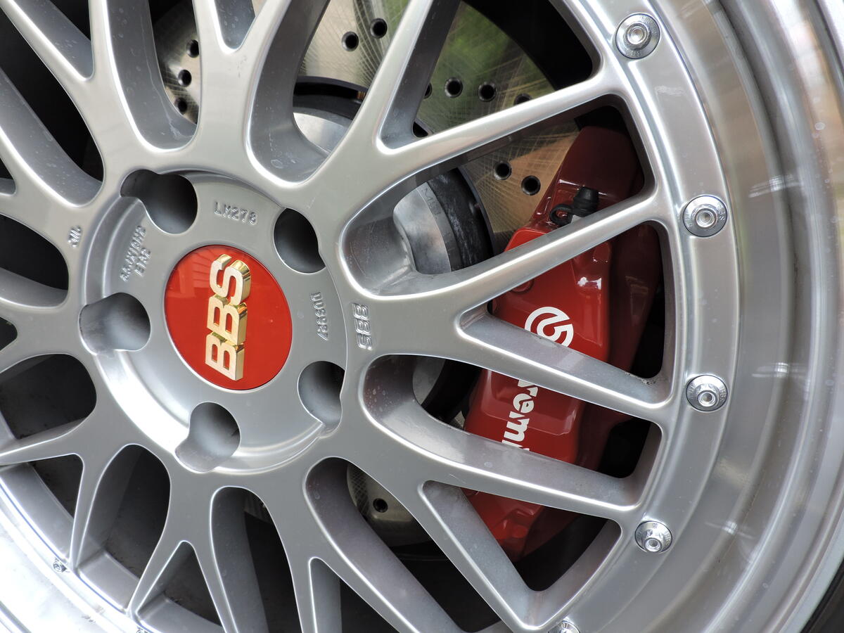

                            • BBS LMs in 19x8.5 ET +32 size clear the fronts with ease. I bought spacers just in case, but they were not needed.

                              I found out the stock 18s do not clear. The caliper hits the spokes. I calculated close to 10mm was needed so I ordered 12.5mm spacers. I'm sure they'll fit after but I want to know if I can use less. Wheel spacers are just bad in general but in my case, a necessary evil.
