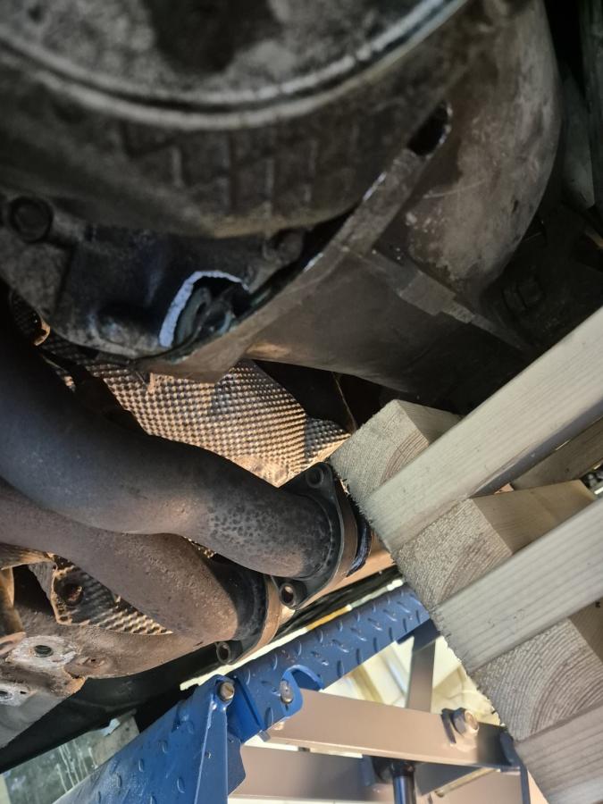

                    This guy uses a transmission jack as well
                    This is why not to use a pry bar to take off the gearbox
                    Click image for larger version  Name:	1000088345.jpg Views:	0 Size:	77.3 KB ID:	318438
