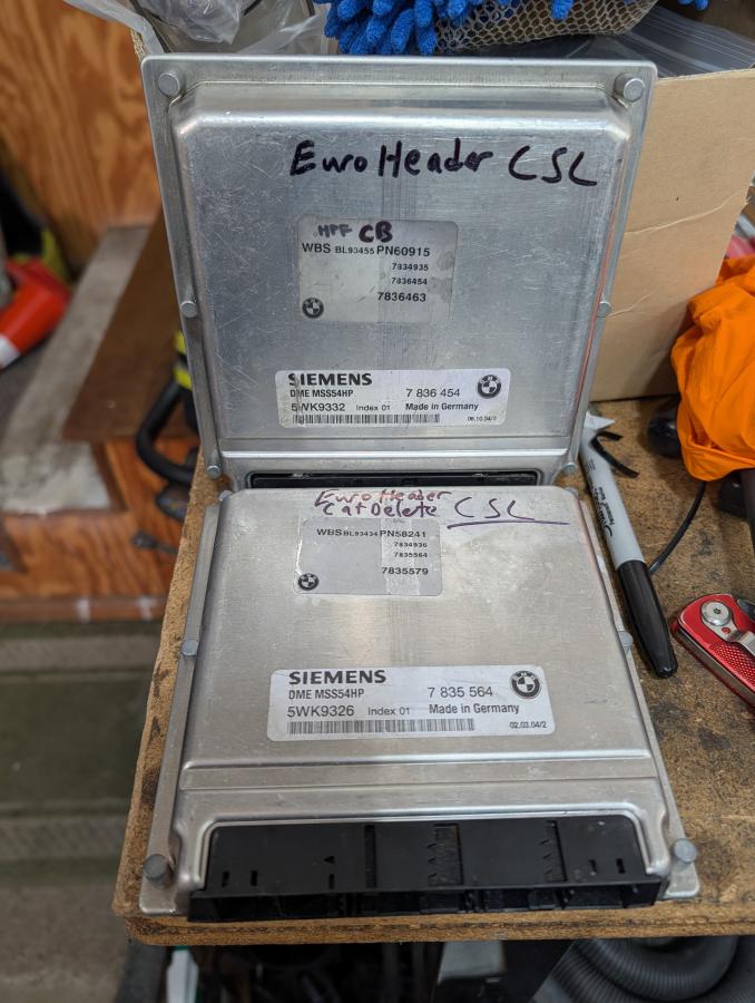

    I have 2 for sale $850 shipped. They already have CSL map tunes for Euro header and cats delete

    Appreciate the offer but I don’t plan on changing from stock setup on exhaust system.
      #47
      But you said you needed an HP DME?
      Any donor DME will need at least an EWS delete so I don't know that you will be able to just have a plug and play DME.
      You could buy one of those and use a really cheap and easy to use program (binary modification tool from ecuworx.co.uk) to make the necessary changes.
      Additionally you could ship it no any number of places for changes and you could also have a tuner make the changes remotely if you purchase a KDCAN cable.
        #48
        I can put whatever you want on it is what I'm saying. If you want something deleted I can delete it. If you want stock exhaust tune no problem I can do that too. The main part is the HP DME. Anything else can be changed on the actual DME tune
        The tune that I provide on here will be very sufficient regardless of deleted cat or no deleted cat and you will be able to drive fine without having to get tuned immediately from a tuner. But eventually you'll want to get tuned if you want to tweak as much power as you want on a dyno.

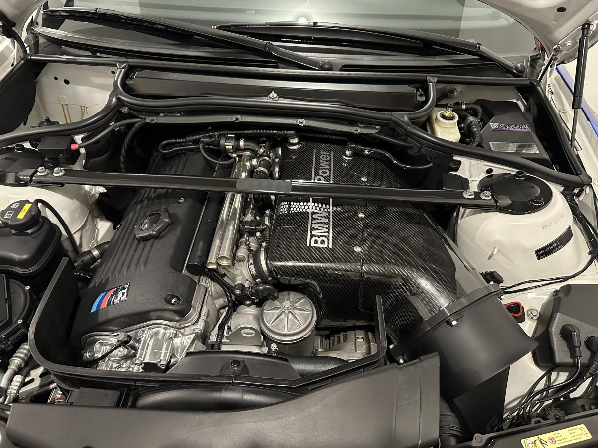

                            Click image for larger version  Name:	IMG_1830.jpg Views:	0 Size:	200.6 KB ID:	324749 I have the Haimus box. Paired it with the CSL DME and MAP conversion from Kassel. After I installed headers Kassel re-tuned the car. I’ve been very happy with the performance which is significantly better than stock. But most importantly is the sound above 4k rpm.

                              In the 2-3K RPM range, are you having a lag in throttle response when you rev match? I noticed this in the street test video and on a Z4M with airbox I recently drove.
                              If you are experiencing a sluggish throttle, you simply need to tune your car. See Pasha's tuning thread, I used his method multiple times to tune the air/fuel ratios and my car became on another level, way better than any OTS tuner can give you.
