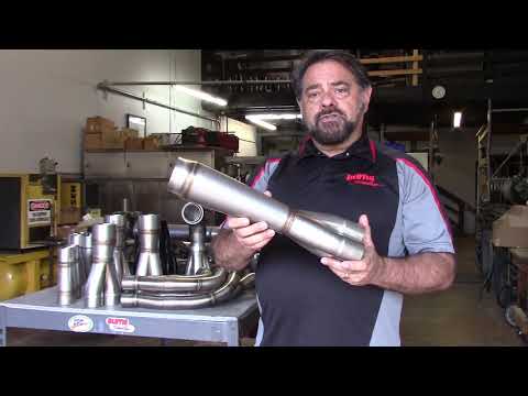

      If you look at this video from Burns Stainless, they talk about modelling their geometry after an ASME Venturi, and mention that the rationale for increasing the angle to to avoid a very long transition is to decrease wall losses. Also, it looks like the merges that he's showing off are at 15o though the inlets all look coaxial, and the whole thing looks like it's packed as tight as practical while still affording welding clearance. If you retain the linear lead-in from Bry5on's design it would be easy to lengthen/shorten the linear section to adjust tuning length to different applications
