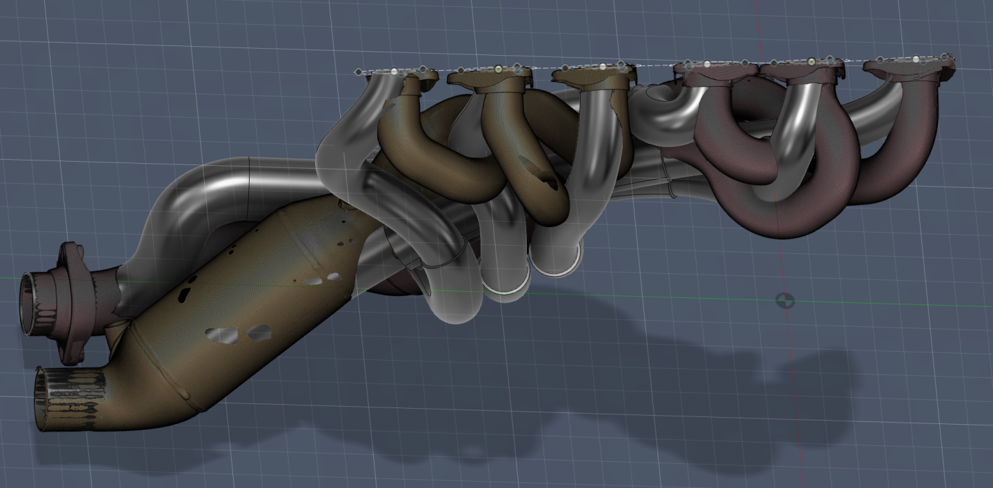

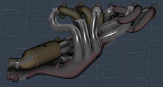

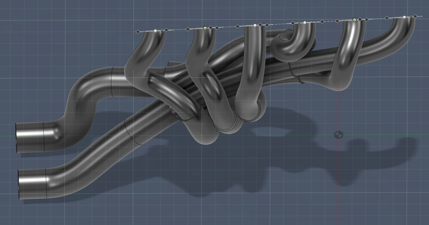

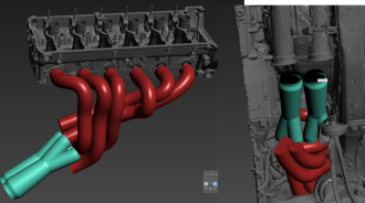

        Here's 500mm equal length (+/-0.5mm) stepped headers - single step from 40mm OD to 45mm OD. Secondaries are also equal length +/-0.1mm and have 100mm of straight section for a merge collector. There's even a straight shot to install every fastener except one. And enough clearance to the frame rail to get the headers over the studs for install in situ.
        I'm not sure packaging the bigger OD is going to be achievable with equal length primaries and secondaries now that I've hacked at this for a while. The secondaries really make it trickier. Going shorter than 500mm is also pretty tricky, but probably doable with some time and effort.

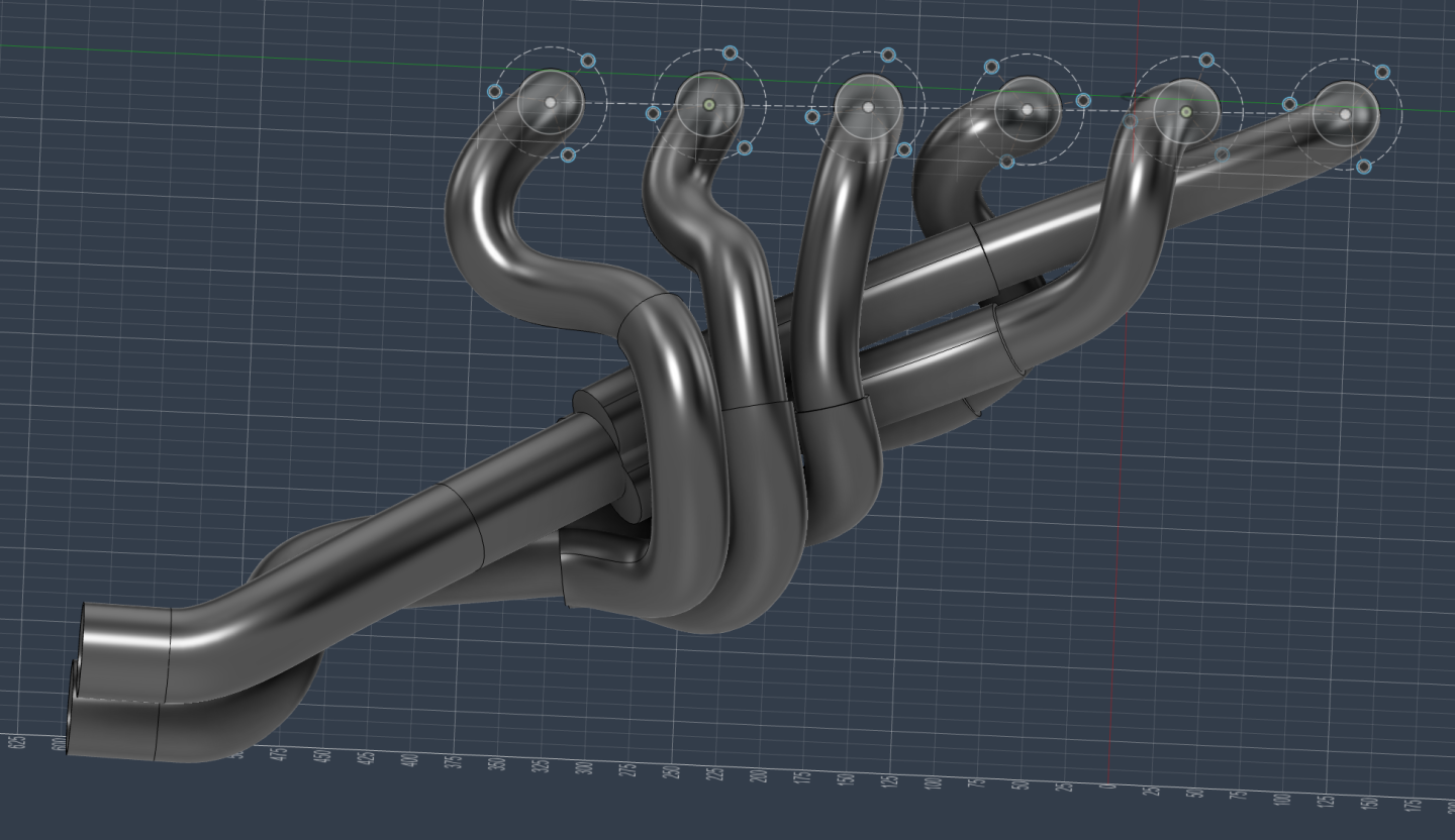

                That looks great. I can check that in the E36 chassis as well if you want.

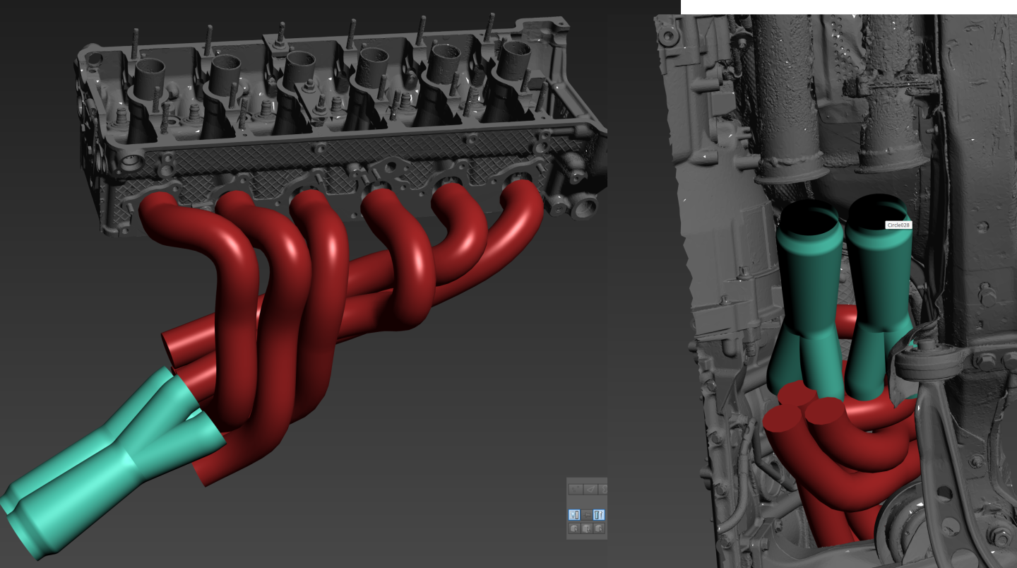

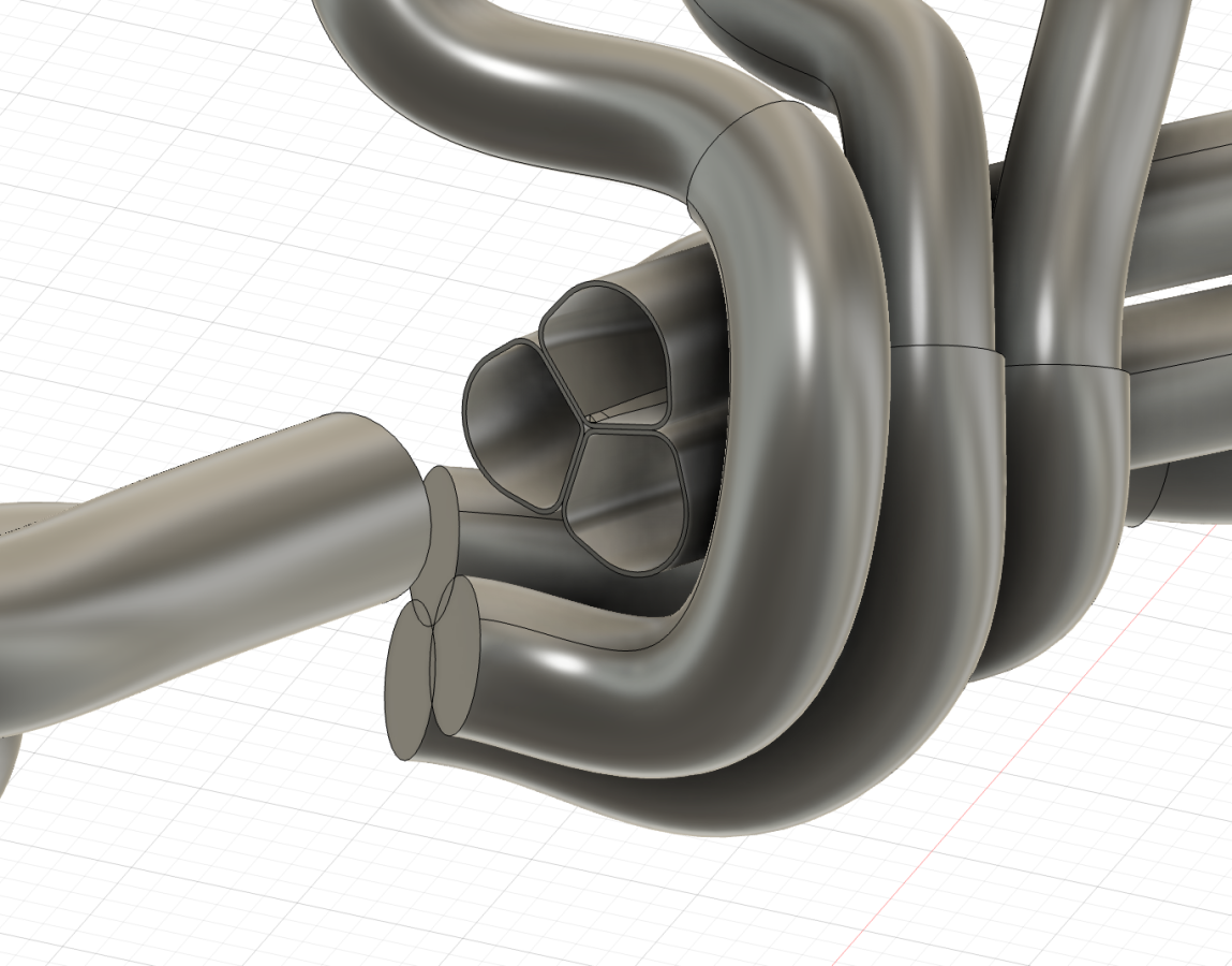

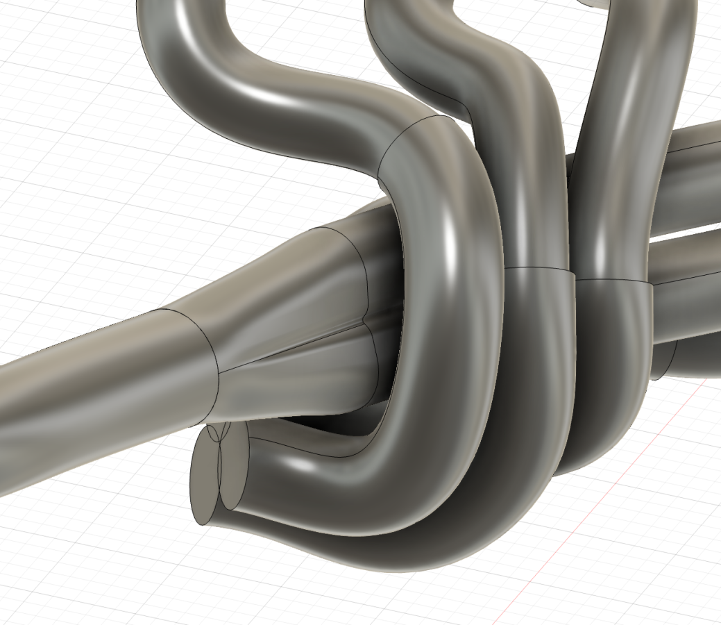

                I roughed out a quick 15 degree merge with a choke and a reverse megaphone and its pretty challenging to fit. Just a thing to keep in mind:
                Click image for larger version  Name:	image.png Views:	0 Size:	639.8 KB ID:	352129
                  Yep that makes total sense. The megaphone doesn’t need to be straight though 3D printing for the win here.
                  edit: check your email for files. Let me know if you need an export

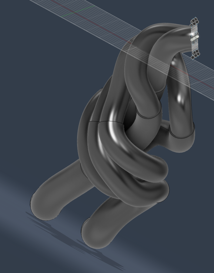

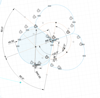

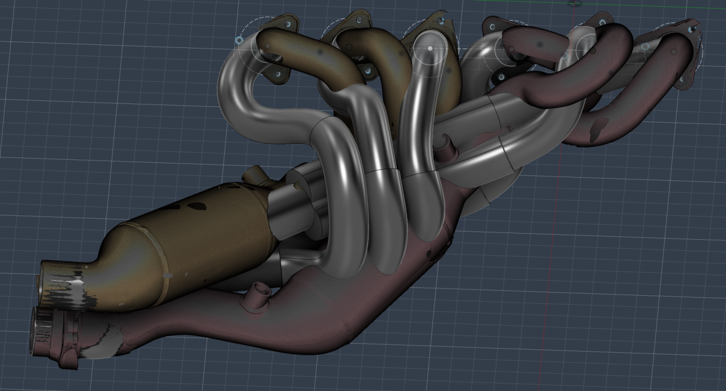

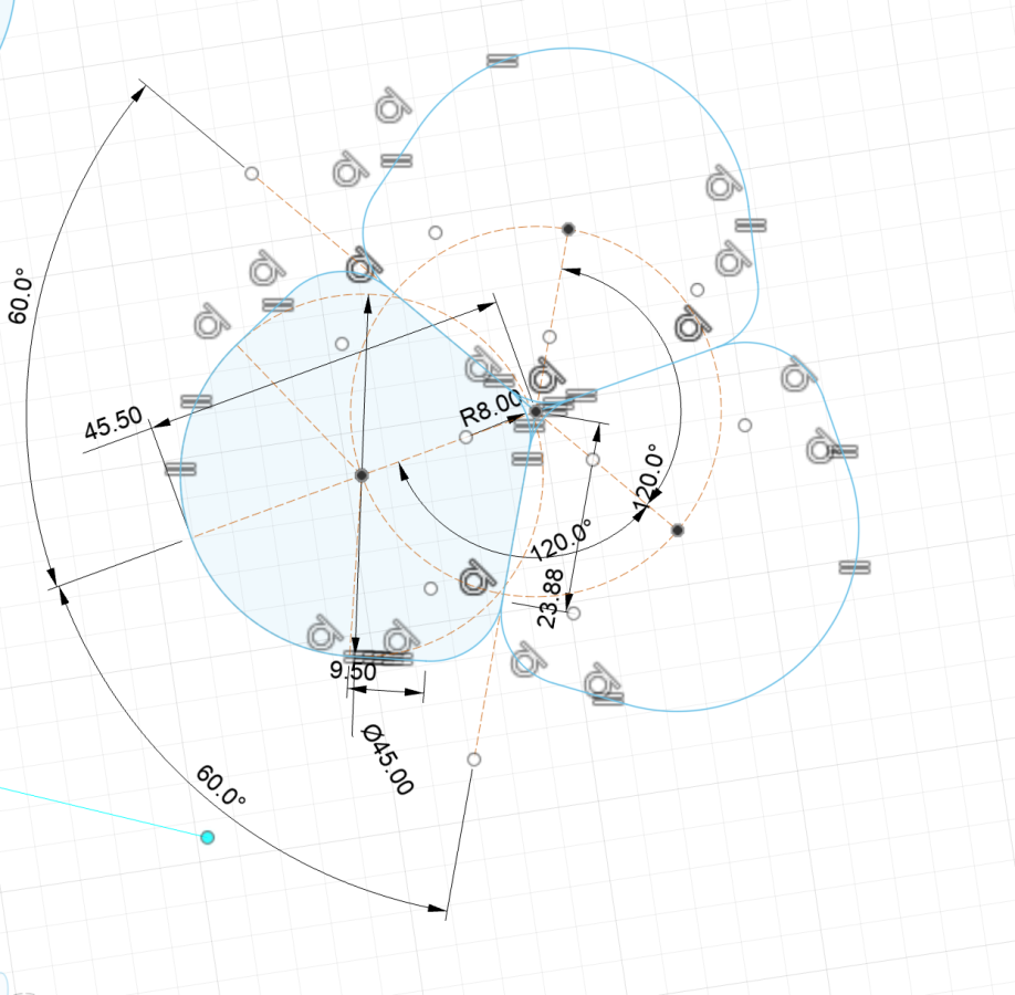

                        Started work on a collector design that takes full advantage of 3D printing last night (constant cross sectional area in a smaller package). Still more work to do as I'm not happy with the runner layout and 3staxontheradio found some bell housing interference but we're making steady progress:

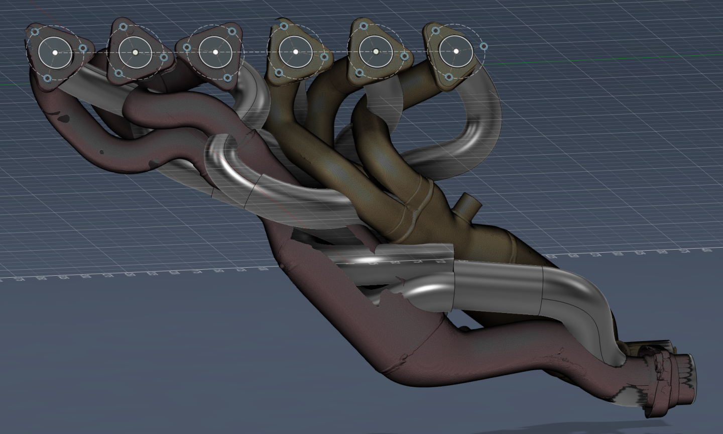

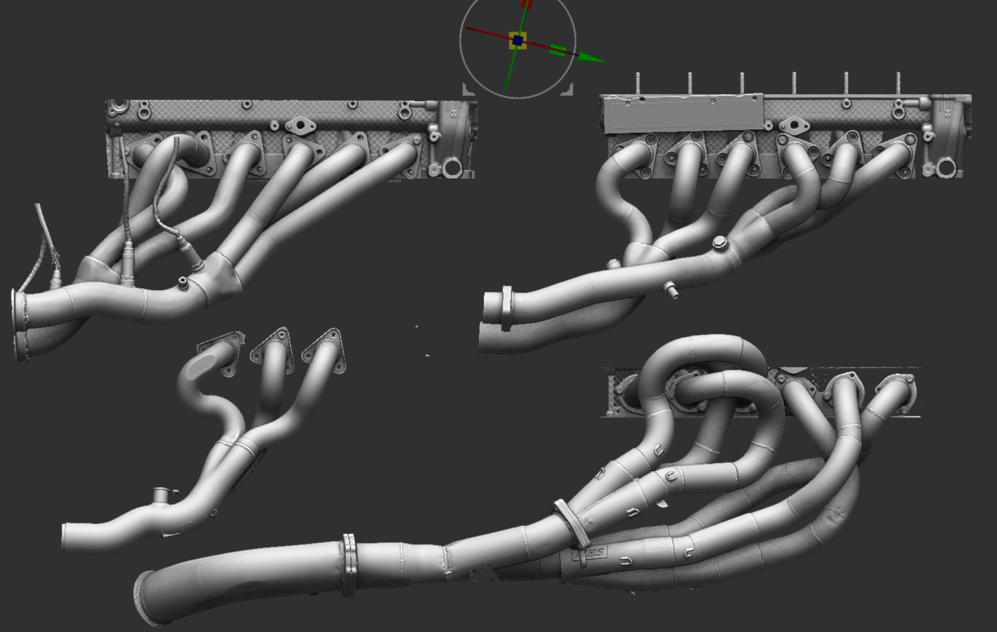

                            I added the E36 with s54 scan file to the github
                            BWM scans and files. E36 M3, S54, Header Design, GS6-37bz, etc. - AlecMoody/AlecMoody_BMW
                            Edit: I also added the scans for the Manzo and Megan headers so now the github has all of these headers on it:
