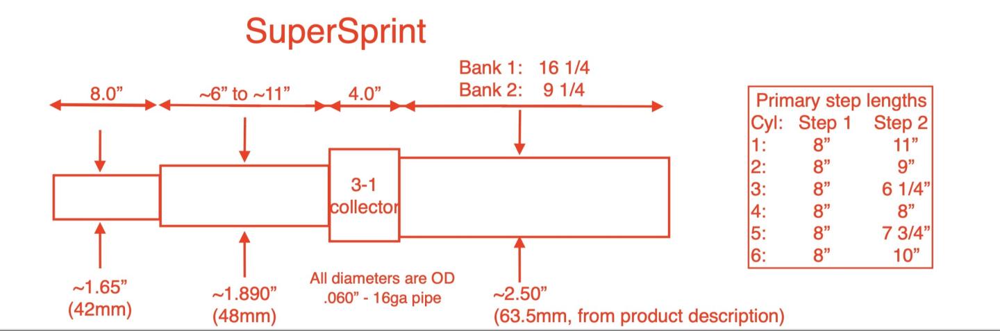

    Sure, here they are. I did the PipeMax a while ago, but can try and answer any questions if you have any. And here is a diagram of the SuperSprint measurements. You can see that the second steps in the primaries are really not equal length, and the secondaries are not either.

      Thanks for the SS data.
      Just for reference. A Tri-Y is a 6-3-1 not 6-2-1. Also in pipemax to do a 6-2 you need to setup as a V6 and not tri-y
      as for secondaries being short, that's fine if you arent after a wide power band. Below 4000/4500 rpm short secondaries are a torque killer due to reversion

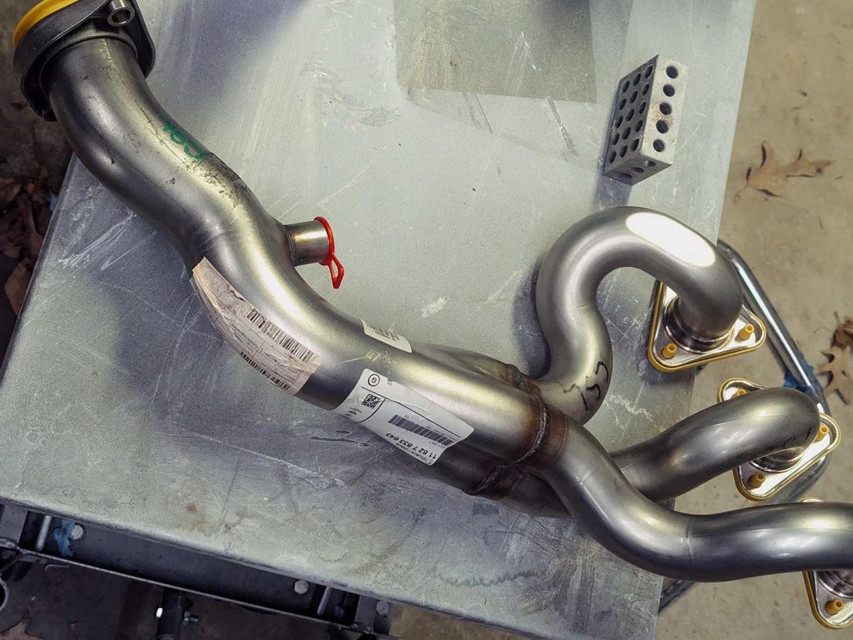

              I have been slammed with work and will be able to get back into this in a few weeks but also davidinnyc loaned me a CSL header bank so I'm going to get that measured and scanned as an extra reference point:

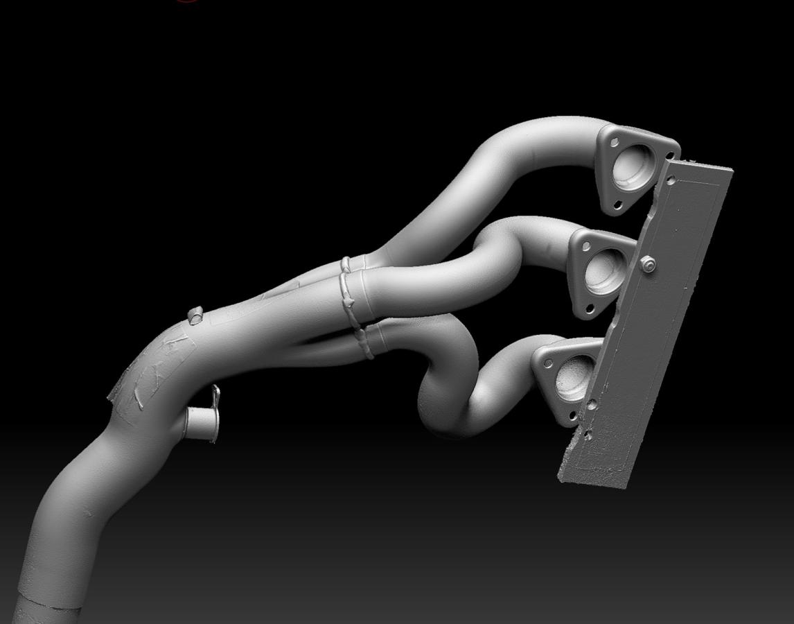

                Had time to run off a scan last night after work:

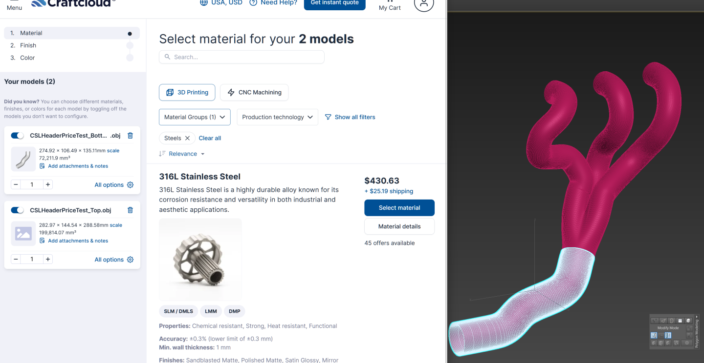

                  I was really curious about how expensive 3d printed headers would be. I made a super fast sketch of one of the banks of the CSL header, made it without flanges (I figure flanges could be traditionally cut to save money), set it to 1.5mm wall thickness and uploaded it on craftcloud. If its made as a single piece its kinda pricey. $1200 for one bank or $2400 for a set. This is because its over the size of almost everyone's DMLS machines so only one company could quote it. Check out pricing when split into two pieces:
                  Longer runners, possibly slightly thicker wall thickness, etc is going to involve more material but this is way cheaper than I thought it would be. I think for people willing to weld them in peices and mix with traditionally fabbed flanges, vbands, etc. the cost may end up around $1000.
                    #99
                    Printing 316L is super reasonably priced. This is even a bit cheaper than I thought though. Guess a fully printed header is a better idea than before. After factoring in labor and the CNC bend costs, no way you could beat 3D printing's price for low volume. Wild.

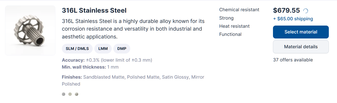

                      I wonder how much cost going double walled would add
                        I had expected the cost to double because material usage is doubled but its about 50% more. I think a 3mm wall is overkill and also not an efficient way to add strength to the part. I'm sure some combination of webbing, gusseting/supports, and non uniform wall thickness would be a lot more cost effective.
                          The problem becomes support material removal for complex geometry like this. You’d end up with a lot left in between the walls, which could get heavy fast. A weld on set of shells with some locating bosses would probably function better but at greater cost.
