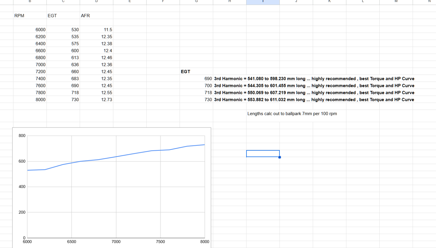

          I did a quick dig into Bry5on logged data to look at EGTs. Since EGT has a big effect on how fast pulses move I wanted to get a better sense for how close pipemax is and try inputting manual EGTs. This is what I got for EGTs at the end of a WOT pull. Then for sanity I did a rough division for how many RPM moving the length changes. The EGT spread here (690 to 730) would equate to moving the peak power about 150 rpm. It would be good to get more logged data from people but it seems like a 700 degree EGT at peak power (7900 as configured) is pretty close. Also I don't think this tune (bry5on mullet tune?) is pushing the limits very hard on timing advance at WOT, that's just my understanding from how the tune was built so bry5on feel free to correct me. That also probably applies to anyone else who doesn't running a fully custom dyno tune which I think is the majority of people. EGT is a tricky factor because its super transient and also different setups, different VE, and different ignition timing will have a direct effect. It doesn't seem right to just handwave EGTs since the impact is large but it becomes unknowable.
          Click image for larger version  Name:	image.png Views:	0 Size:	143.6 KB ID:	328701​

            Correct, not pushing boundaries on timing, but it is a couple degrees hotter than OEM in various places at WOT. It’s basically tuned to CA 91 octane until it gets intermittent/random ping events, then is backed off a few degrees. I’m logging knock and DME timing retard at 100Hz for that tuning.
