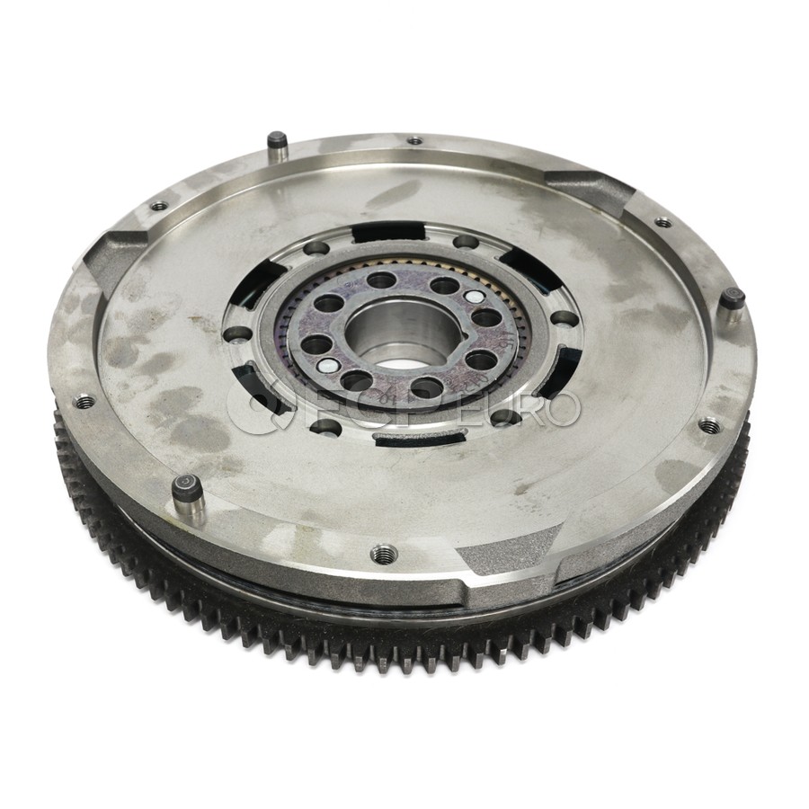

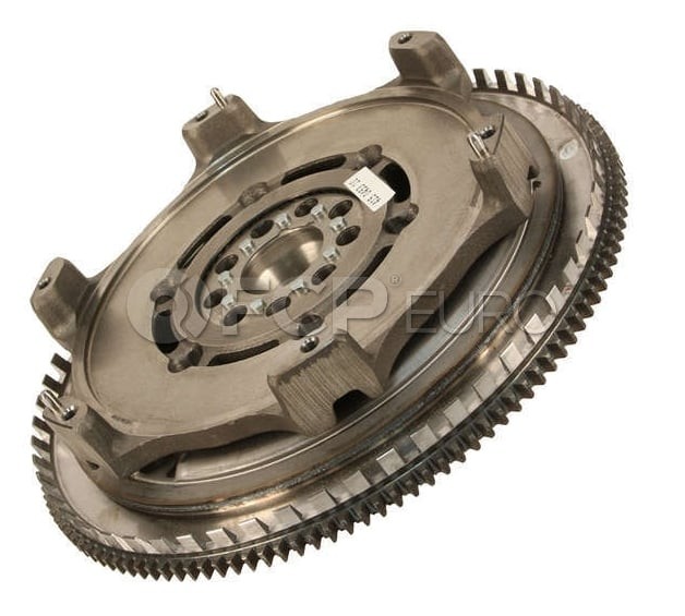

        S65 DMF looks pretty significantly lightened compared to the S54's.
        S65:
        Click image for larger version  Name:	open-uri20190423-6375-qr3nlb.jpg Views:	0 Size:	63.0 KB ID:	329323
        S54:
          S65:
          S54:
          Click image for larger version  Name:	LUK-4150175100.jpg Views:	169 Size:	117.0 KB ID:	329324
          The amusing thing is that I had this exact conversation with a guy last week about the S65 flywheel. It'll obviously require more effort, and the juice will probably not be worth the squeeze, but the S54 flywheel does look more promising.
