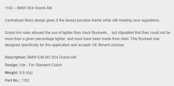

                      1011 – BMW S54 Lite Lightweight to suit standard Clutch and Standard 6 Speed Gearbox Standard weight single mass flywheel for SMG Gearbox Models Available Requires Flywheel Bolt :  BMW 11 22 7 805 885
                      Seems like they have others too for the S54:
                      | 06 6 Speed Vert - JB on Cinnamon|Beisan|ACL RB's|ST Sway Bar|3.91|Bi-LED| TMS CSL Box|Megan headers|H.T.E Tune|Bryson Air Inlet|550 Injectors|OEM Section 1, 2, 3|200 Cell Cats|OEM SSK|Bilstein B12|712 yellow tag
                        Nice. I liked the sound the Grand-AM. ~19.4 lbs
