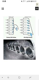

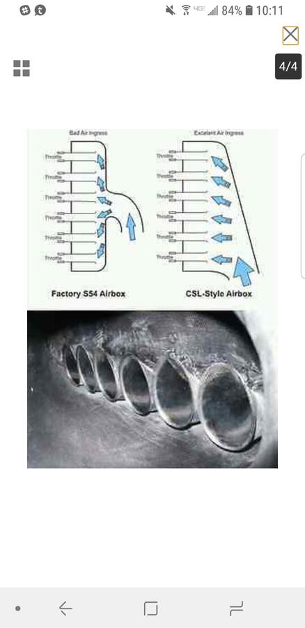

                          Hassan has actually cut the stock airbox open and retrofit the CSL filter and a new inlet mainly for power to remove the inlet choke point and the MAF. The basic difference is in the pic below. Def possible. A lot of folks also get it for the sound since CF of certain thickness will resonate and make the car sound like a supercar. Click image for larger version
                          Youtube DIYs and more
                            Ah, I didn't realize it was the carbon fiber that was the source of the sound. It's becoming more and more tempting every day to fork over the money for this...but I don't think it's the best use of money on my 154k mile car right now.
