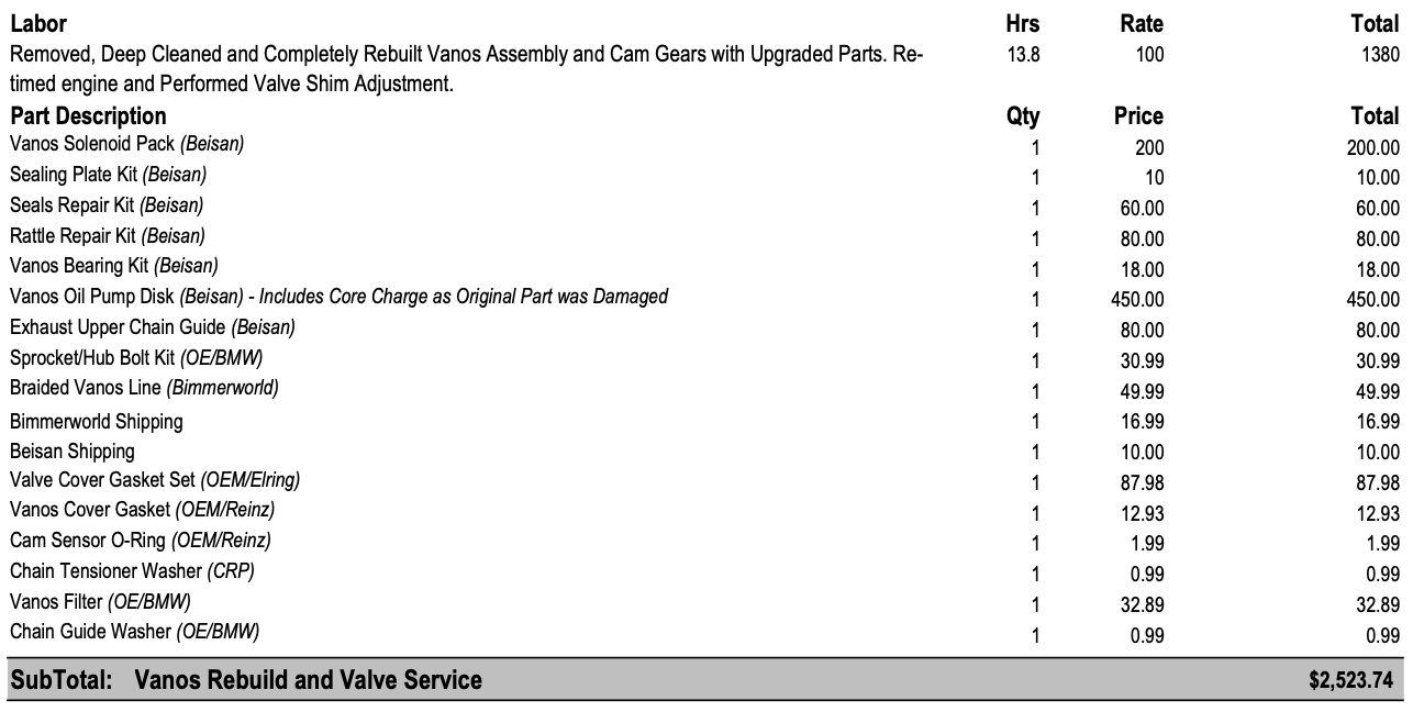

      BTW, 13 hrs to replace a bunch of vanos parts is too much, for $100/hr
        No new Exhaust Sprocket Hub either ? Broken Tab ?
        Oil pump disk could still be reused with new holes or not ? So core charge should of been refunded ?
        Could of just swapped it out for an enitre new core that beisan offers, would of saved labour and you would of gotten a new soleniod pack

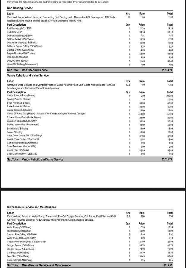

          Oil was changed when the VANOS was done, rod bearings were done at the same time. I've attached the whole invoice. This was done by the previous owner thankfully so I didn't pay these rates haha. I also did engine oil less than 4k miles ago and was going to do it right after the valve shims.
