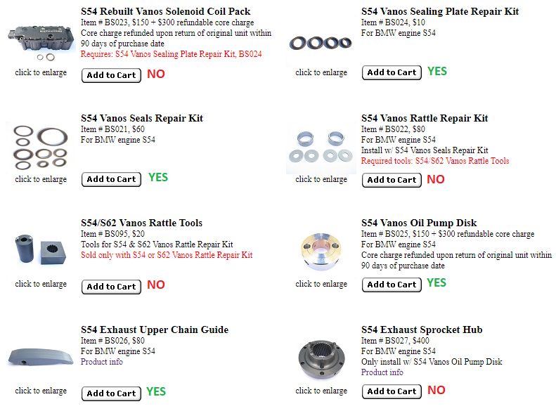

            I'm about to place a Besian order. Is my logic sound?
            -Currently at 75k miles
            -I drive ~3k miles per year
            -The work will be done by a friend of a friend BMW mechanic for cash on a weekend
Name:	Besian Order.png
            Solenoid Coil Pack = NO. This job seems easy enough that I could do it myself in the future. Why replace something non-catastrophic that may never fail during my ownership?
            Sealing Plate Repair Kit = YES.
            Seals Repair Kit = YES.
            Rattle Repair Kit + Tools = NO. After adding the S62 diaphragm springs, this seems like a lot to spend to prevent a harmless noise that may never present itself.
            Oil Pump Disk = YES.
            Exhaust Upper Chain Guide = YES.
            Exhaust Sprocket Hub = NO.
              #36
              Have your original disc re-drilled it possible, this is a critical that you have proper fitment and your original disc has its own wear pattern etc. , and good to go on everything else. I also agree with skipping the anti-rattle, I did it just because but it just introduces more potential issues than it solves imo.
                  Roger, I'll call Raj @ Beisan to see how quick he can turnaround a disk.
                  Does just replacing the upper chain guide avoid the potential issues (I assume associated with timing)? I see Beisan has it as part of the rattle procedure

                    #39
                    Or you can just confirm the dimensions and bore of the machined disk match up with your stock disk.
                    It's not easy to measure the pump piston bores on the new disk to match with the old pistons. And also the center shaft hole dimension too. They are all critical dimension to have good oil pressure.
                    I agreed with Caubie that it's best to keep the stock disk and fre-drill new smaller holes.
