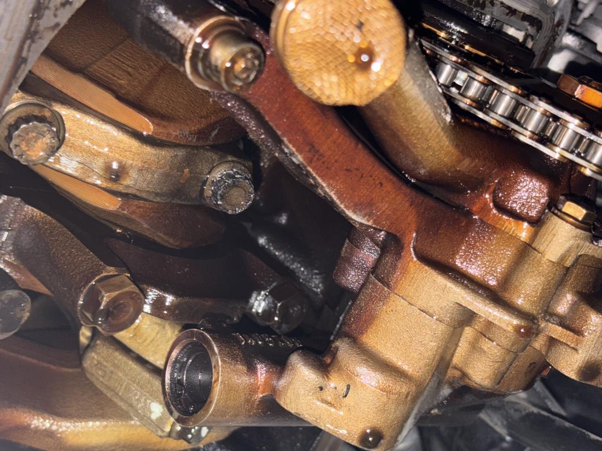

Today is the day lads. Got the oil pan off yesterday, thankfully didn’t have too much trouble other than the SMG hydraulic lines being in the way sometimes. Tackling the bearings today, wish me luck
Good luck.
Make sure to use one pair of gloves for each rod bolt 😋
My trash can is half full of gloves at this point lol. Rods 6-2 are done, and of course the last bolt on rod 1 rounded off on me. Off to harbor freight for some extractor sockets now
Alrighty, well the extractor socket didn’t work. Anyone have any idea how to get the bolt out without grinding a flat head into it?
I would maybe try a different size and/or quality of extractor before loosing even more material on the bolt. Those H.F extractors aren't great, this is when a set of snap on or similar quality metic and standards would be nice, not practical I know. Maybe measure with calipers to get an idea of size and order a quality extractor(s) based on that.
Welding would be the last option,that would have to be done extremely carefully.
So the 12mm extractor has to be hammered on but I dont Have enough room with the subframe right there to swing at it. I tried but can’t hit it very hard so if I’m not supposed to do that anyway, there’s that at least lol.
