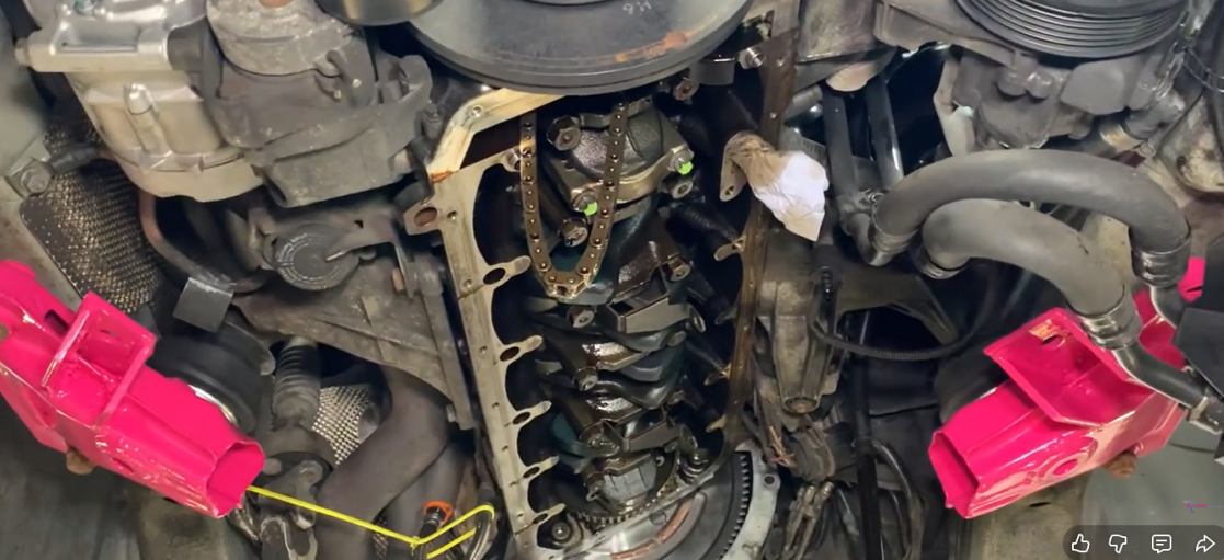

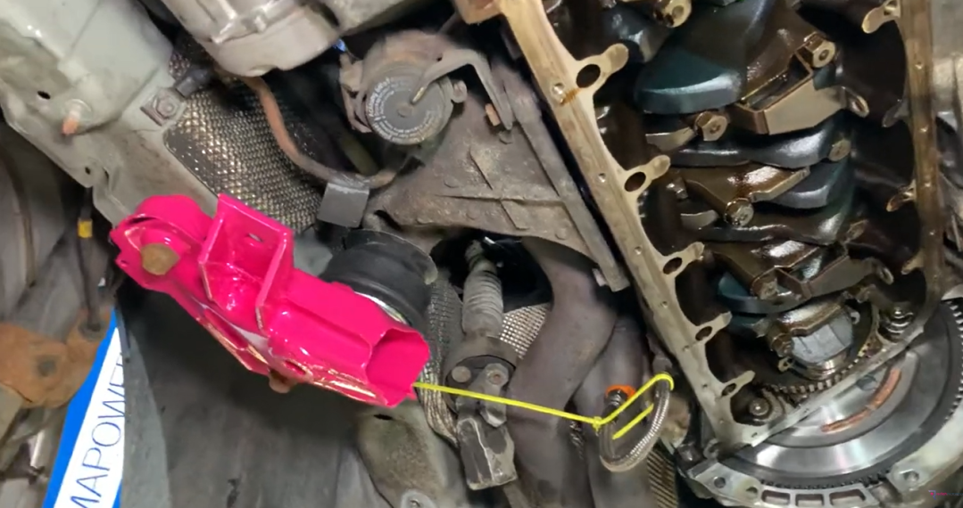

        Does anyone know if any e46 cross memeber can be cut to remake these for RB jobs ( reddish idea )

          Not sure what people are dealing with on these jobs with the subframe. I had zero issues reaching anything around the subframe with it just hanging down out of the way.
          And whether you remove it completely or not, you can get an engine hanger for less than $100.
            All E46 RWD crossmembers are the same in regards to doing this. I love this idea and have been meaning to do it myself but I think it probably works better on S65 and S85s.

                          Reddish idea with the cut crossmember is much safer i would hope
                            I was more worried of the engine falling off the engine support bar, the engine was moving around when i was torquing down
                            What are you supporting it with? You should be suspending it from above using a hanger, which will hook through the lifting bracket on the front of the head. There is really no way for the engine to fall off of a hanger.
