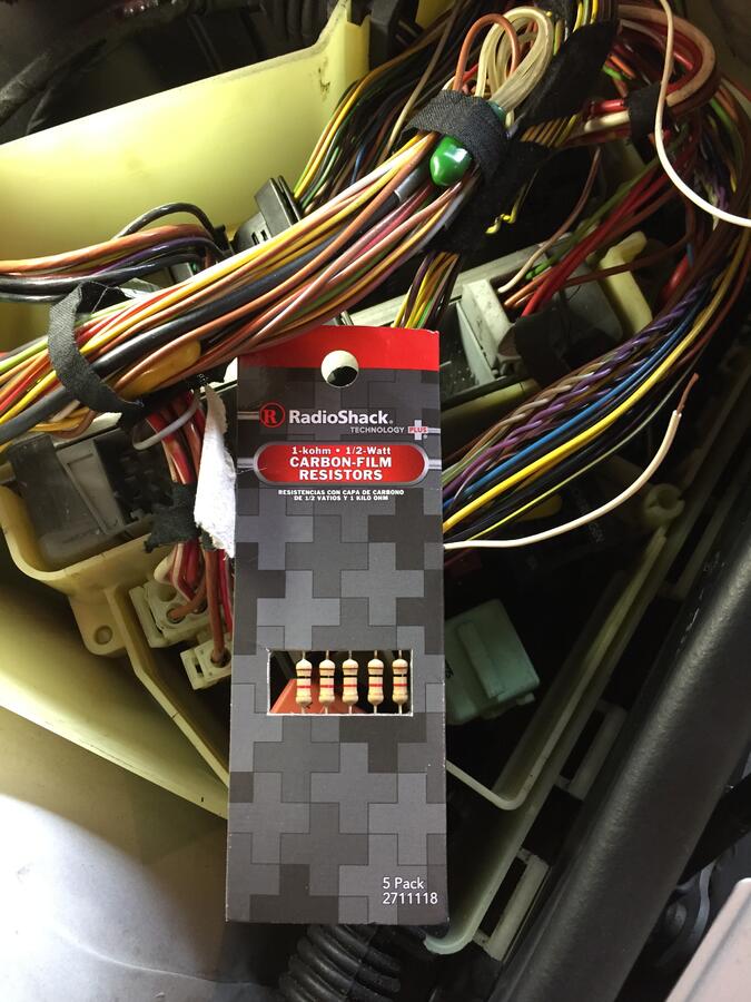

    there’s a few threads on other forums on which resistor to use. I used a 1k but that was on my previous m3.

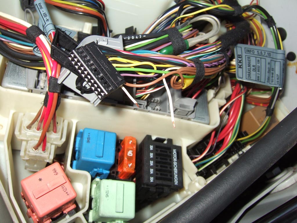

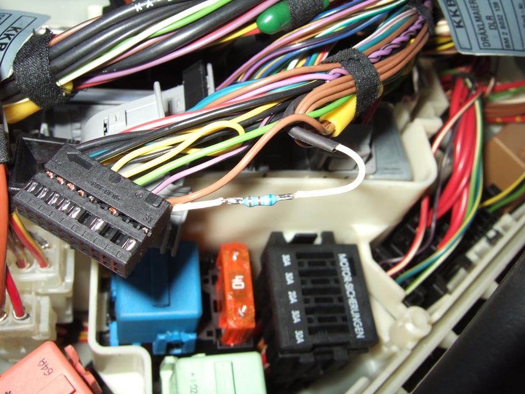

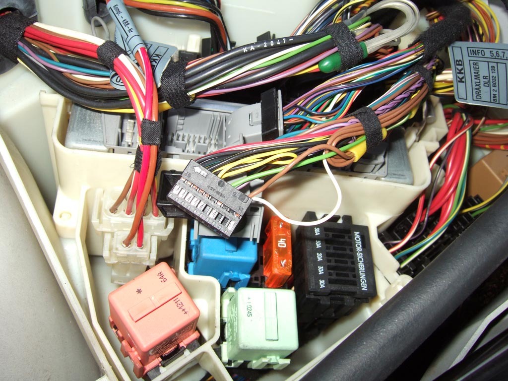

          Optimal value of resistor to use for the mod is 680 ohms, as identified through extensive research by Steve Evans.

            This is right. I'm using the 680 ohms based on the information from M3F. It's not too much. I've relocated the SMG and I've still left the resistor in and it hasn't messed with anything.
              I'm still not convinced that this mod has any benefits unless you're seeing a specific code about the temperature being too hot. However, it probably is a reasonable precaution to take if drive-ability is your highest priority. Any SMG experts want to weigh in?

                      Hi huys, what number of pin on the unit in the engine bay it is pls? Thank you so much
                        It should be pin13 of the 40-pin connector X53004
