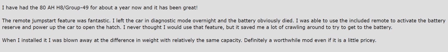

            Would that work? Almost definitely. But the restart technology is most certainly worth it. One of the guys on the X3 forum posted this.

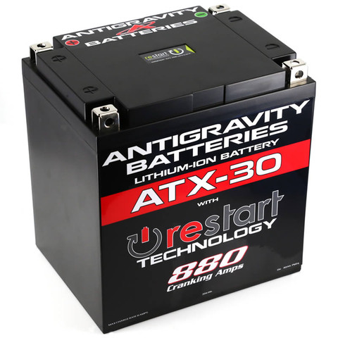

                  Idk what all this back and forth is about. New standard batteries are shit these days..those bastards don’t last like they used to. They’re also heavy as fuck and a PITA to move around + have the potential to leak + require meticulous care to get them to last more than 2-3 years.
                  Seriously, if you’re a lazy and cheap fuck like me who hates lugging around 50 lb batteries just get the 6 lb Antigravity ATX-30 for $350 shipped, battery posts for $10, and 3D print the bracket I linked for $20. Unless maybe you’re rocking accessories that require a lot of juice…my only aftermarket accessories are dashcam and Avin Avant 4. Can daily the car with zero problems, can let it sit without a charger for two weeks before it requires a “jump start,” and the “jump start” is literally just pushing the restart button.

                          SQ13 or anyone else running the ATX30 or similar. You're not having any issues running electrical components?
                          I'm thinking about high electrical load conditions where the radio, headlights, electric fan, defroster, heater/AC blower fan on high, etc. are all on at once. I know this is a rarer condition, but if it's raining it becomes a more valid use case.
                          In the ATX30 description, Antigravity has this to say:
                          • Not for use in Automotive applications. Contact us for potential use in “Race Only” Automotive applications.
                          • Please check our HD version, or our Lithium Automotive Batteries when more power and capacity is needed.
                          The HD version (ATX30-HD) seems like it might be a better fit for the street car use case given the higher reserve capacity. For folks that run multi-day rallies, having a higher reserve capacity for vampire draws (factory alarm, ECU memory, etc.) feels like the safer bet maybe...(?)

                              No issues, but I don’t think I’ve put the car thru high electrical load conditions? Recently had the following running without any problems: Avin Avant 4, dash cam, headlights, defroster, heater running with speed at around halfway mark. Idk if my electric fan turned on at any point during this…it’s running off the wiring for the AUX fan.
                              AG will not recommend the ATX to most customers for CYA reasons/avoid the hassle of clueless people complaining. But if you’re smart about it and have reasonable expectations then they said it’s fine.

                                I've ran the ATX-20RS in my car and it had no problem cranking the engine 5-6 times in a row in 45 degree weather. Vehicle voltage drops about 1 volt more than with the ATX30 (10.5v vs 11.5) during cranking, but that's about it.
