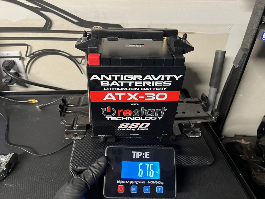

        No issues, but I don’t think I’ve put the car thru high electrical load conditions? Recently had the following running without any problems: Avin Avant 4, dash cam, headlights, defroster, heater running with speed at around halfway mark. Idk if my electric fan turned on at any point during this…it’s running off the wiring for the AUX fan.
        AG will not recommend the ATX to most customers for CYA reasons/avoid the hassle of clueless people complaining. But if you’re smart about it and have reasonable expectations then they said it’s fine.
        Originally posted by Ryan_R View Post
        I've ran the ATX-20RS in my car and it had no problem cranking the engine 5-6 times in a row in 45 degree weather. Vehicle voltage drops about 1 volt more than with the ATX30 (10.5v vs 11.5) during cranking, but that's about it.
        Sweet. Appreciate the feedback.​ I'm sold.

              Little more detail on my setup.
              I don't have HVAC, any audio or rear interior lights. I still have the front map lights and power windows/doors. All exterior lights are LED, including headlights. I would image a factory car wouldn't have any issues unless you're running the HVAC, audio, lights, and running the windows up and down all the at the same time with the engine off (people do weird shit).
              The only time I had my battery die was when I screwed up some settings and left my ECU powered up over night (400mA draw). The next day I had to use the little restart button and I was able to fire up the engine.
              I ran the ATX-30RS for 2 years with a more stockish setup and it performed the exact same as the factory battery.

                  While the ATX--30 can be used in a race car, and you might be able to get away with using it for a stripped down daily, it is not recommended for any sort of vehicle that sees constant use.
                        Maybe I'm misunderstanding, but what do you mean constant use? Do you mean heavy loads with the engine off?
                          I mean it's one thing to drop an ATX-30 into your 95 Honda civic that you drive once a month and leave on a tender, but IDK that I'd drop into any modern vehicle with a high drain.
                          People are going to do what they are going to do, but repeated use of the restart feature will degrade the battery over time.
                            Hmm, I would think in those scenarios the restart feature wouldn't be needed because the battery is staying in use/charged?
                            I could see that being an issue with new(er) BMWs that run pumps and fans with the car off, but an E46 should only be pulling 0.040A when off (after 16 min) and it should be sub 0.200A within a couple minutes or less.
                            I would think a vehicle driven on "short trips" or high loads with the car off would be an issue vs frequency of use?
