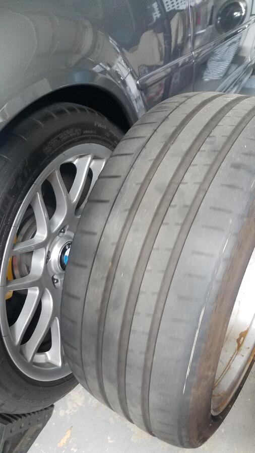

    Lots of negative camber by itself won't cause wear like that. Its the negative camber AND toe. Toe causes the tire to scrub and generates heat which results in more wear. If you add camber, you get more heat and wear on the inner edge of the tire vs it being spread across a wider section with less negative camber.
    The toe is out. Doesn't take much at -3 negative camber.
    I said the same in post #7, but they don't want to believe it.
      #32
      Agree with both of you. What I don't understand in the outside edge. I've corded plenty of tires, but seeing two edges like that... it's odd.
        #33
        I run pretty aggressive toe out and neg camber, and my fronts are also starting to cord just like that. I'll upload a pic.
          What pressures are you running?
            #35
            31 cold F 34 cold R
              #36
              How much camber and toe, and how much mileage on those tires?
                #37
                I've made manual adjustments, so not perfectly sure. Alignment is due when I move to 235/265 mpsc2 soon. Something like -3, toe no idea, but significant enough to see visually. 4 year old tires, 11k miles. For half those miles, the alignment was not this aggressive.
                Thinking about it a little more, my case actually demonstrates what I was saying about toe being the problem. i didn't see the accelerated wear until I went from neutral toe to toe out. I always had significant camber.
                  #38
                  So I'm harping on this not because I enjoying being a troll on forums, but because the OP's tire wear is weird. I'm genuinely interested in what the root cause is.
                  Your wear looks like it's mainly on the inside and if you're at neg 3 camber and zero toe or close to it in either direction, typically not a problem. Toe that's far off center AT ANY CAMBER setting will chew up tires fast. Very fast.
                  I run past neg 3 on a racecar that's comparable enough to an M3. I run + or - 1/8" overall toe (and anything in between) depending on the track and no issues with wear. Go much farther past that, and your nuking the outer or inner tread. Or DOT radials. Or slick.
                  ​​​​​​​I'll take some pics of my race tires that are well used and at 1/16" to 1/8" toe out later and post. Perfect wear. Awesome setting for initial turn in, helps the car rotate, etc. but highly not recommended for the street.
