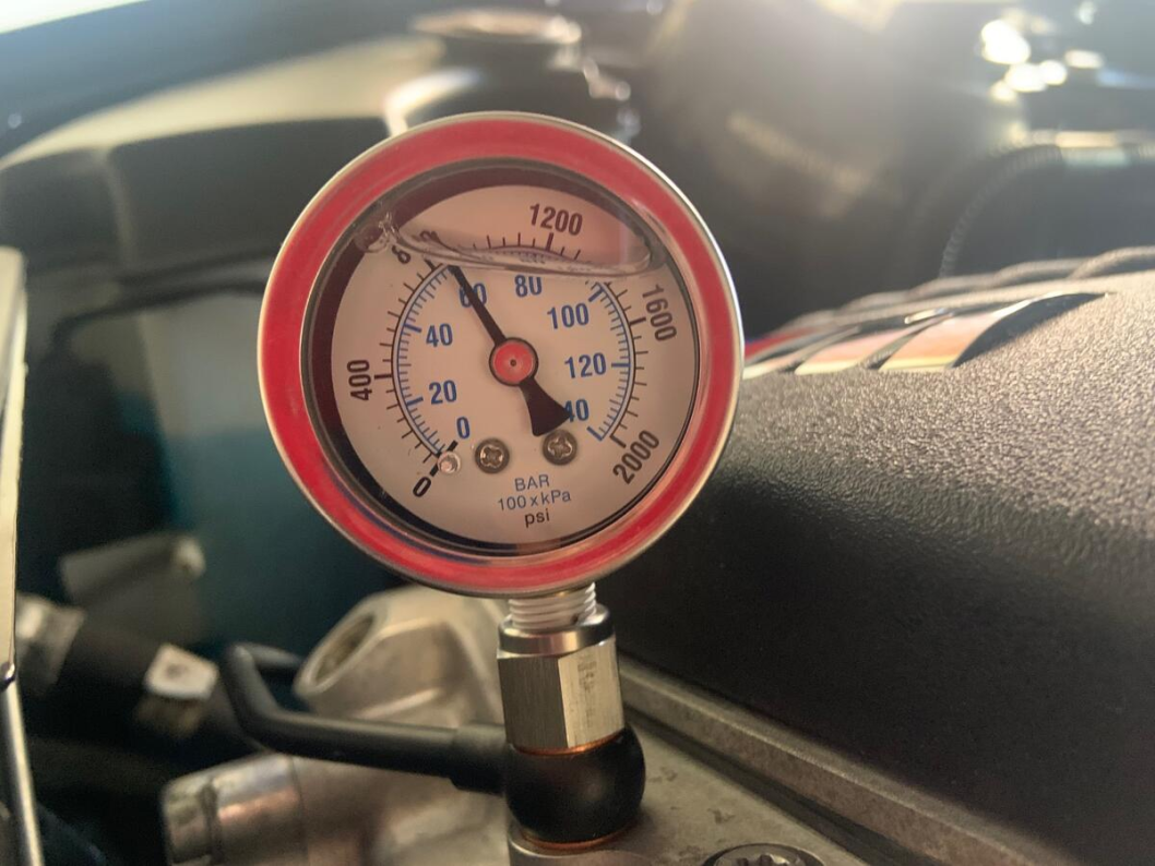

      U need special gauge and modified banjo bolt on pressure line Click image for larger version

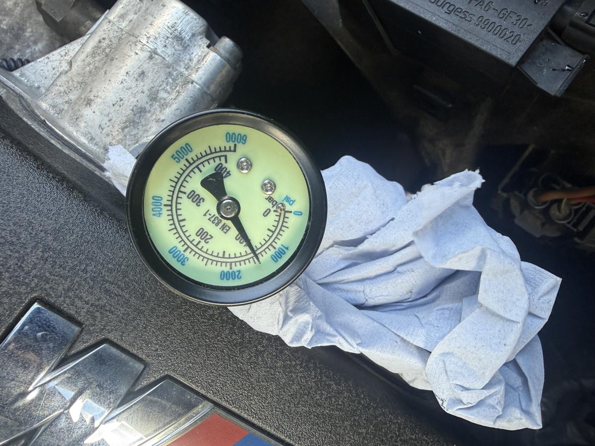

        I bought this:
          thank you.
          I think I’ve found correct fitting and gauge and placed order.
          even though i’ll be rebuilding vanos, it will be interesting to see oil pressure.
            Parts came today and this is the pressure which looks good, so I’m baffled. This is on idle

              That’s good, make sure it holds when the oil is hot, ideally at 90-100C
